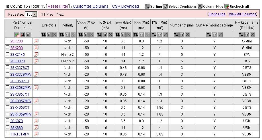

Interesting. The datasheet is from 2007, but good on Mouser to carry it. A nice high breakdown voltage too.
When Toshiba discontinued the venerable 2SK389 dual they did have two SMD duals in two package styles that weren't the same chip as the 389, but looked o.k. What I was annoyed by: the package was only 5 pins, with the sources hardwired together 😡 Much less versatile. A six-pin package would have been so easy to do.
Here are all (15) JFETs left on Toshiba's product catalog.
All SMD, all N-channel, no high Yfs.
Patrick
So the 2145 looks like a dual 880. I note that the spread on transconductance is large, so the 4 mS in the table is probably a little pessimistic. However, it's clear Toshiba isn't making large area parts anymore, and in particular no P channel.

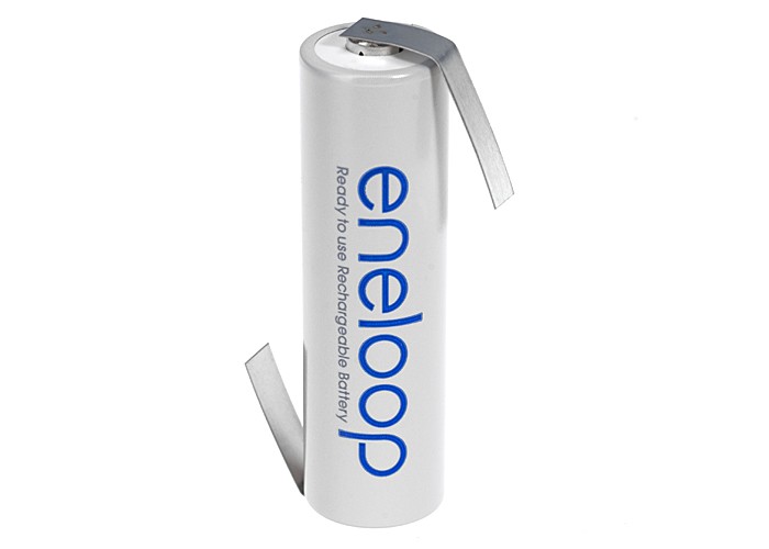

Something like this.
Patrick
56 AAA of those is what i'm looking for, not easy to find at a decent price...and genuine.😎
ENELOOP AAA 1Z - Eneloop Micro, AAA, 1Z bei reichelt elektronik
Still cheaper than 4x 10VA R-cores, plus diode, regulators, ........
Patrick
Patrick
many thanks Patrick,
that's way better price than i had seen up to now ...and half local price.
