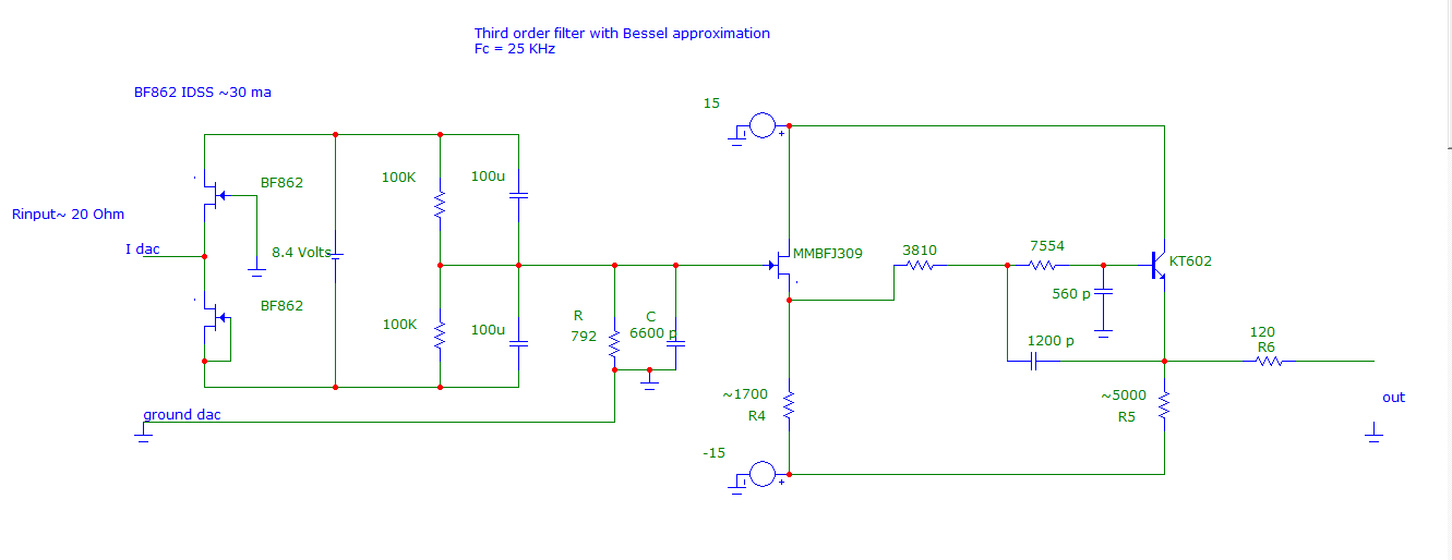

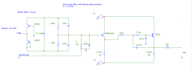

I bought few BF862 to match IDSS and tried to measure it. At 9 Volts it appeared to be around 29-31 mA, which is obviously out of specs. Gate and source were connected to one plane of copper board, and drain connected to nearby plane, separated with blade cut. Marking seems to be OK, 2AW... Where might be a problem?
Also I am going to try this output with PCM63. KT602 is small signal Soviet BJT.
I am going to make a PCB that will accept 2 pairs as well as 1. PCM63 is known to tolerate quite high voltages at its input, contrary to AD R-2Rs for example.
With Riv 792 Ohm and 2 mA current there will be around 1.1 Vrms at the output, which seems acceptable. 2 8.4-Volt batteries will lead to almost absolute maximum rating dissipation at BF862.
