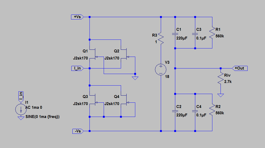

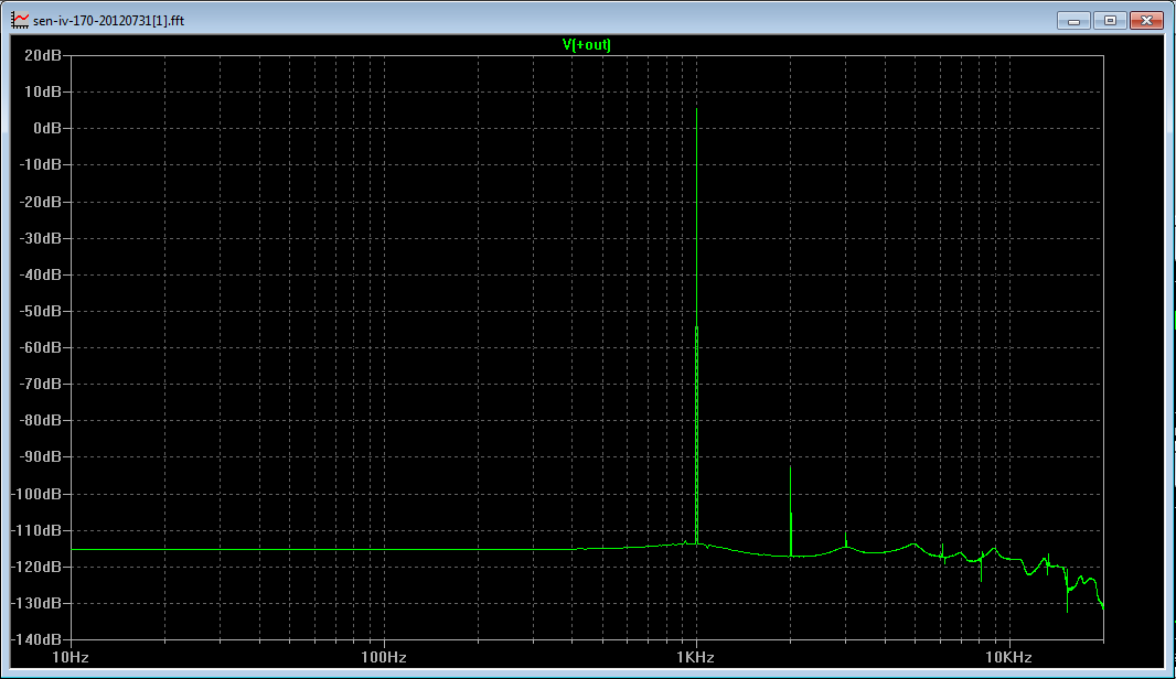

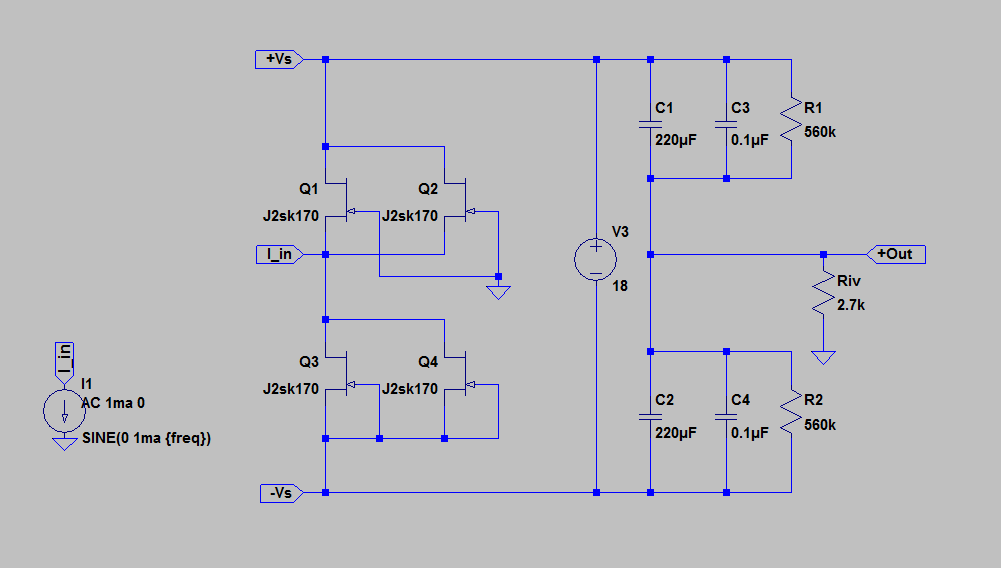

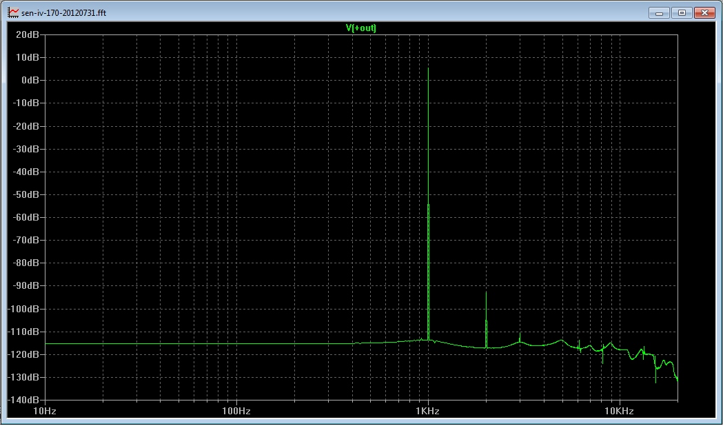

As I do not have a working circuit with me to do real measurement, the least I can do is a Spice simulation.
The attachments show two standard SEN IV circuit variants with 2SK170s.
The first one has ideal current and voltage sources, so that the distortion is only due to the circuit itself.
The 2nd is the same, except that a 1R series resistor has been added to the voltage source.
This is as bad as a battery power supply without any decoupling capacitor can ever get.
The corresponding distortion spectra are shown and can be easily compared.
I also attached the Spice model I am using, so that anyone can repeat the results for themselves.

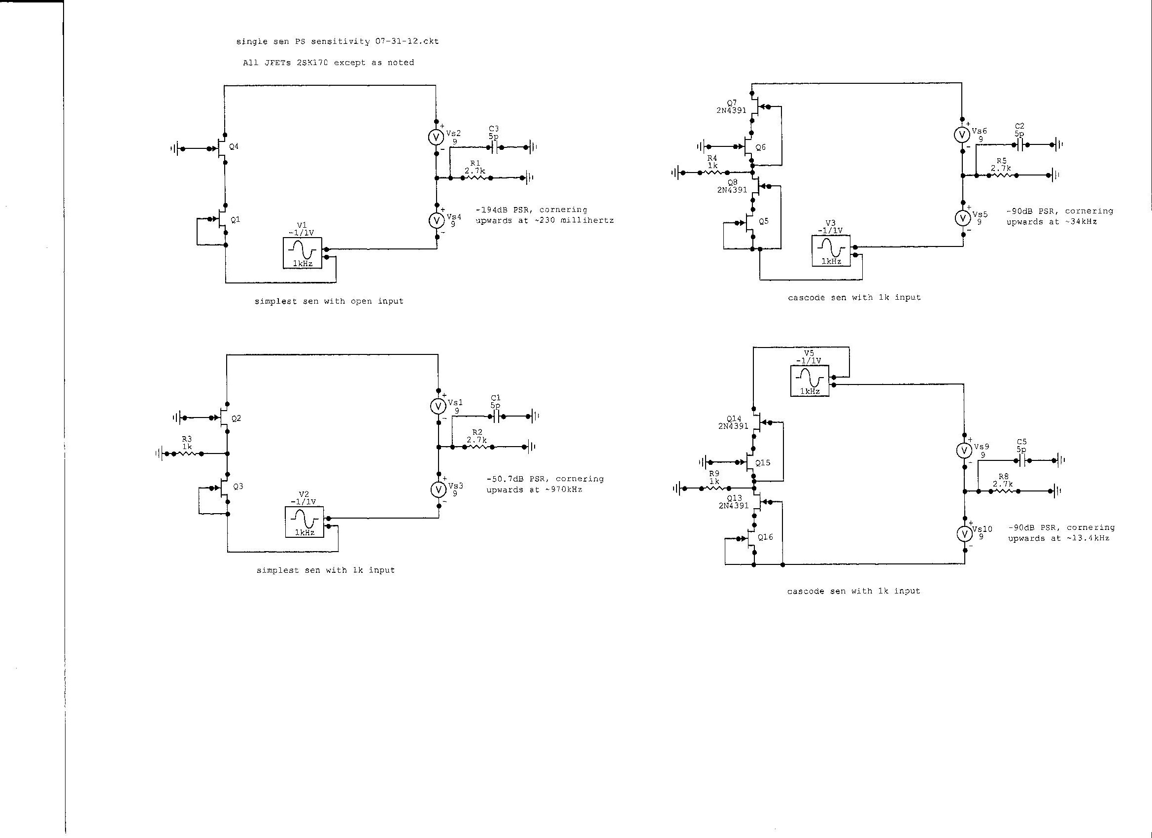

Power supply rejection of Sen and cascode Sen
This is helpful to assess the appropriate levels of concern. In each case the low-frequency attentuation is noted, and the point at which things are up by 3dB, after which they rise (that is, attenuation falls) at 6dB/octave out to VHF.
The cornering occurs a little lower in frequency when the PS noise is in the positive leg of the battery. But it's pretty decent, even without the cascode structures, and when fed from a lowish presumed DAC output resistance.

Understood 🙂 I just wanted to put a bit of perspective on the concerns from some quarters about power supply sensitivity, which can be seen to be fairly small even for the simplest topology.
As not the first time, some times complicated circuits which perform better in theory or in measurements do not necessarily convert to better sound.

Yes, I simulated your circuit up to 10 ohms for the power supply resistance with no significant ill effect. This particular circuit seems to be fairly resistance to power supply impedance, however the model does not take into account the fact that a chemical battery does not have a linear resistance with frequency. The battery becomes inductive above about 1kHz.
