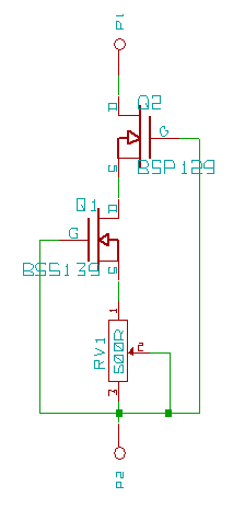

I need a floating supply for another project. I have posted a floating supply here but i think this new one is more interesting because it is more symmetric. Also the CCS´s.
This is not dimensioned yet and i also think about alternative CCS´s so it shows only the principle at this moment. See one alternative.
Nice.
But I wonder, is the simmetry in the CCS important?
If not, you could use two DN2540 cascode current sources. I think Walt Jung found it to be the best measuring one.
OK, maybe it´s overkill.
The symmetry isolates both inputs from the incoming voltage. If that is important i can not say. If you look at it as a series connection it may not matter. What flows in only one CSS flows in the total circuit.

Alexandre, this use of a transformer is creative. I will draw a schematic with the mosfets too.

Here is the Mosfet version. Sure, your trick only works when you can use only one primary.
You could use one primary on 230V too but then you get the double output voltage. Using a transformer with half output voltage and you are back in business .....
The double CCS adds safety, in case you are using the mosfets. They can fail and pass much more current. (I have ruined a few playing on protoboard with low voltages, I´m not even sure how. Static?).
Altough not a big concern for the cascode CCS, if well soldered in place, which it will be of course.
