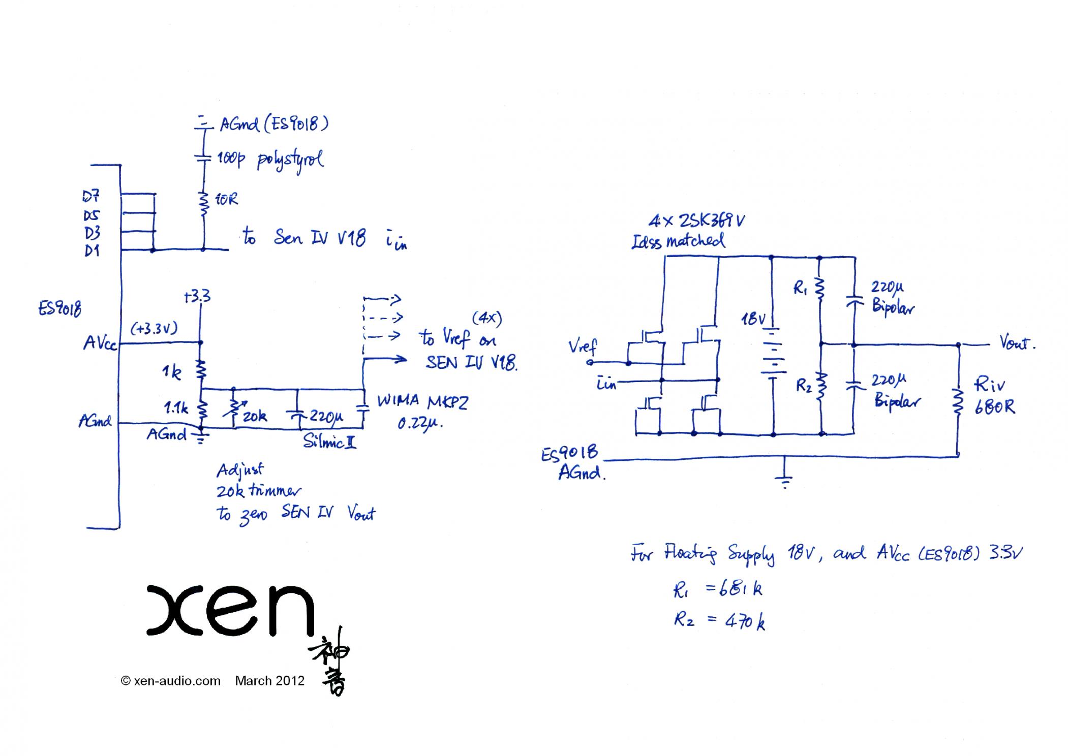

As there seems to be little or no progress with the ES9018 version of the SEN IV, I contacted NicMac with a schematics from me, and coached him to make it work. Well, it does work, and the schematics will follow once I tidied it up next week.
Nic agreed to me quoting his email sent a while ago.
"Hi Patrick,
I'm listening to the SEN with ES9018 now and so far its sounding real good!
I only have one balanced channel up and running so serious listening awaits the second channel (and me getting it hooked up to a head-amp).
I build exactly according to your schematics and the DC-offset was easily zeroed out. It stabilizes fairly rapidly (a few minutes) and appear pretty stable (< 1 mV for the first few hours). I will see how it varies over longer times.
Some time ago I got a USB scope (PicoScope 4262) and when I learn to use it I will let you know how it compares to the other I/V-stages I have for the ES9018.
I may be able to send you a couple of photos tomorrow.
Thanks for the detailed help!
Nic"
🙂 Thanks to Nic for supporting. More details to follow in the next few days, including schematics.
Patrick

Very good news, thanks Patrick & Nic to make it possible.🙂
For those who cannot wait, here is the hand drafted schematics.
Worked first time.
Patrick
PS
9018 in stereo mode (2 channels)
Iout connection for one phase of one channel shown.
Worked first time.
Patrick
PS

Thank you very much for sharing Patrick, sorry my ignorance for floating supply +18V connected R1 side & for -18V connected R2 side?
The total voltage is 18V, and not +/-18V, just to be 100% clear.
The +ve side of the supply is connected to R1, and the -ve to R2.
You only need to follow the SEN IV PCB V18. It is all labelled.
Patrick

In a floating supply, there is no "Gnd".
If you have a set of batteries wire up to give 18V, the plus side goes to R1, and minus side goes to R2.
Just follow the battery symbol in the schematics.

OK now I understand, so I can use two shunt regulators one +9V for R1 & the other -9V for R2 and both GND connecteds together, right?
Yes, but this "GND" of the two shunts should never ever be connected to anything else, especially anything to do with the ES9018 PCB.
On the other hand, I do not understand why you want to use 2x 9V shunt when you can just use a single 18V supply, whatever it is.
I repeat, anything to do with the floating supply should not be connected to Gnd.
Please see Joachim Gerhard's floating supply schematics if in doubt.
And I strongly suggest you get the circuit to work with 2x normal 9V alkaline batteries first.
When everything works, then you can start fiddling with fancy supplies and what not.
Learn to walk before learning to run. 🙂
