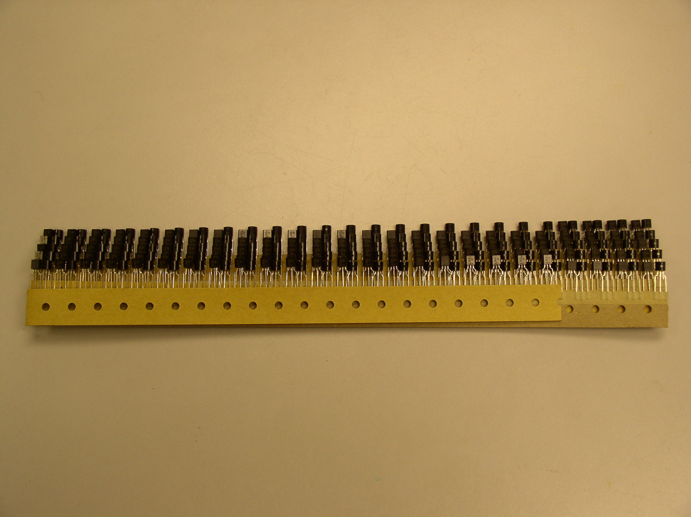

Toys arrived.
Will start matching soon .....
Patrick

So for those who intend to use the Vref version for the likes of ES9018, we recommend using a quad set of 2SK369V for each single channel of SEN, or 4 sets of quads for 2 channel balanced.

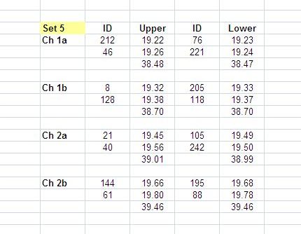

We bought 250 pieces of 2SK369V (as shown in post #511), then curve traced 12 of them at random, then tested a pair of them in circuit to make sure there is no question at all with them. We have now measured and sorted them all. Out of 250 pieces, we can only make up 8 sets of 4 quads (i.e. each set has 16 FETs for 2 channel balanced SEN) to the level of match that we would use ourselves. The matching loss rate is then almost 50%.
Here is a typical set (see attached). Within each quad, Idss under 9V Vds (= SEN operating conditions) is within 0.2mA. This is only important for equal heat dissipation, and is equivalent to <+/-1% dissipation difference. But when paired as recommended, the different in bias between top & bottom pairs are below 0.02mA. This is important to input DC offset. And 0.02mA is equivalent to ~0.4mV input offset.
The 8 sets will only be offered to Vref kit subscribers. Please indicate interest at the GB thread :
