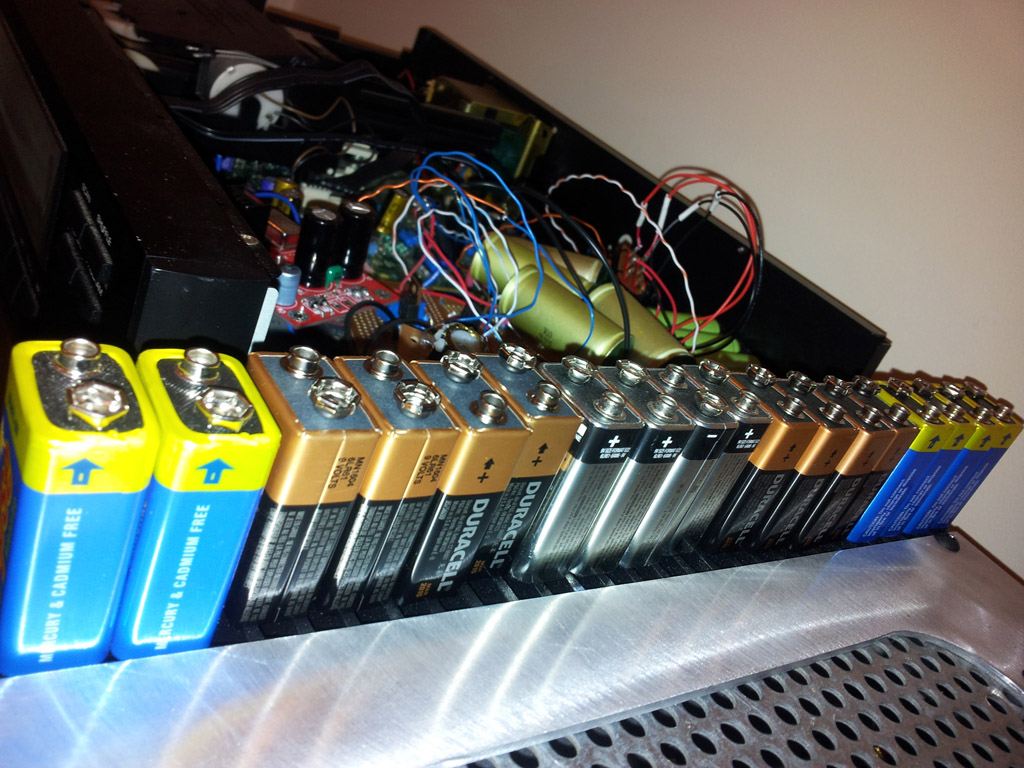

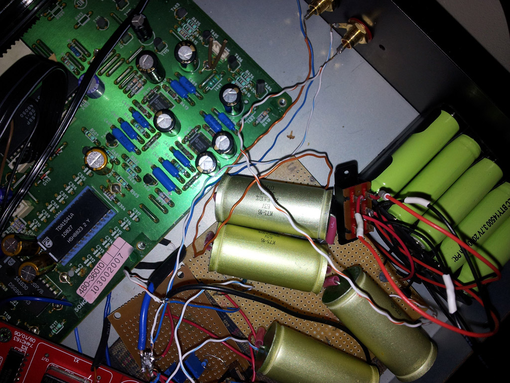

Hi Boys,
I've been through a few 9V block batteries with the Cen now, and with my setup I've noticed that i need a considerable amount of headroom to keep the high amplitude signals from clipping. I'm using a 1.5k IV resistor with +-2mA current swing (TDA1541). Once the voltage went below 17V it sounded crap. To say the least. Bass started sounding weak and less dynamics overall. So now i have about 20 x 9V batteries with 8.4V.
After my wedding was over on Saturday i finally had time to put some rechargeable lithium batteries in. I've now got a bit over 19V available now, and after a short listen it sounded very good.
Before i got busy with organizing and preparing for the big day i had time to get a different current buffer working to supply the required +2mA using a Toshiba k216 mosfet. I found that there was much less thermal drifting, but still, depending on ambient temp i could have between +-15mV drift. After i found out from John Brown that he measured better performance with the 1541 at about -45mV i settled to let it drift around this figure. But because of DC coupling to my F5 i had to re-bias and get the DC on the output close to 0 at my favorite listening level.
Hope to hear some listening impressions of the Cen from other people that are using the TDA1541 soon!
Yes, it looks messy, I'm making a proper board soon.
Good to know. 🙂
