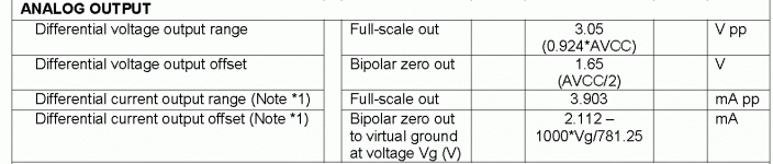

Each of the 8 differential DACs has an output impedance of about 800 Ohms, but if you use the ESS9018 in stereo mode, like in the Buffalo2, you have about 195 Ohms, and 16mAp-p signal current max riding on top of 8mADC wehn using 0 Ohm load. In mono mode, the ESS9018 has its DACs in parallel giving twice the stereo mode current.
AFAIK, most people are using the ESS9018 in either mono mode or stereo mode.

The ES9018 has a low output impedance of about 800R.
So let's go as far as we can and aim to do Zin < 1R.
Since it is CEN, the PNP & NPN are in parallel for the signal.
That is why I chose E153 as current source (15mA bias), so that Zin is about 0R8.

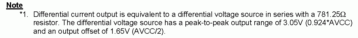

Here is the datasheet´s information about the ESS9018 analog outputs.
In Stereo mode, you have 4X the currents, and in mono mode, 8X.
50-100mADC idle would be good to have for stereo mode.
What is the (current) signal amplitude ?
Patrick
