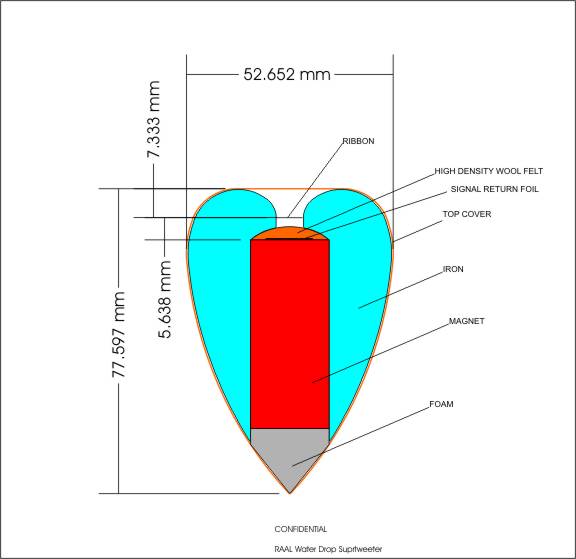

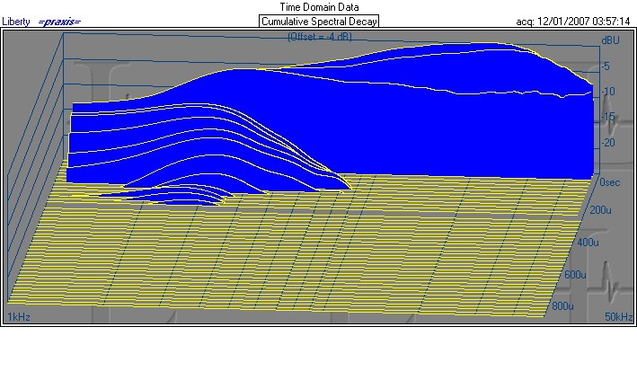

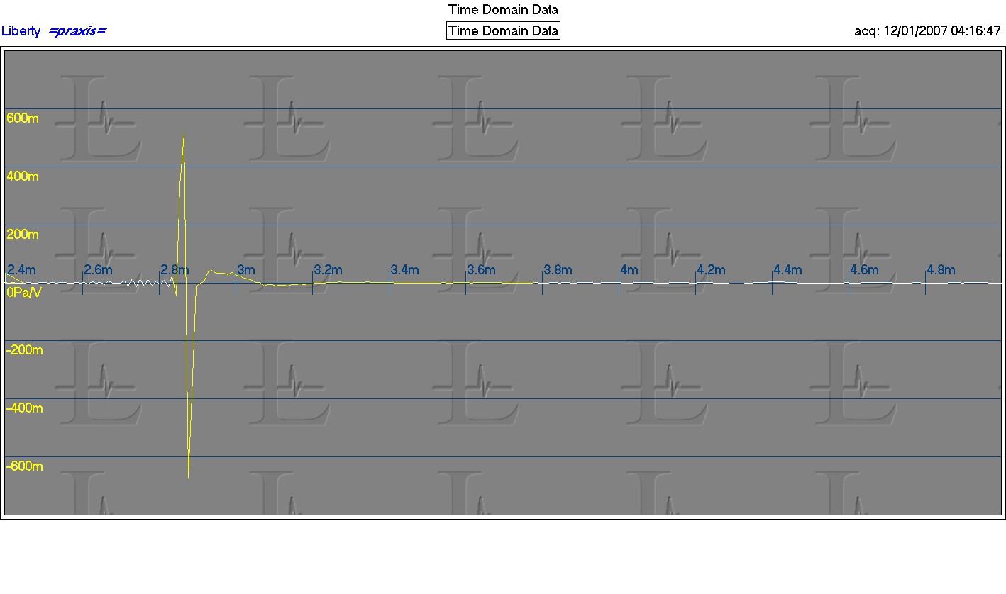

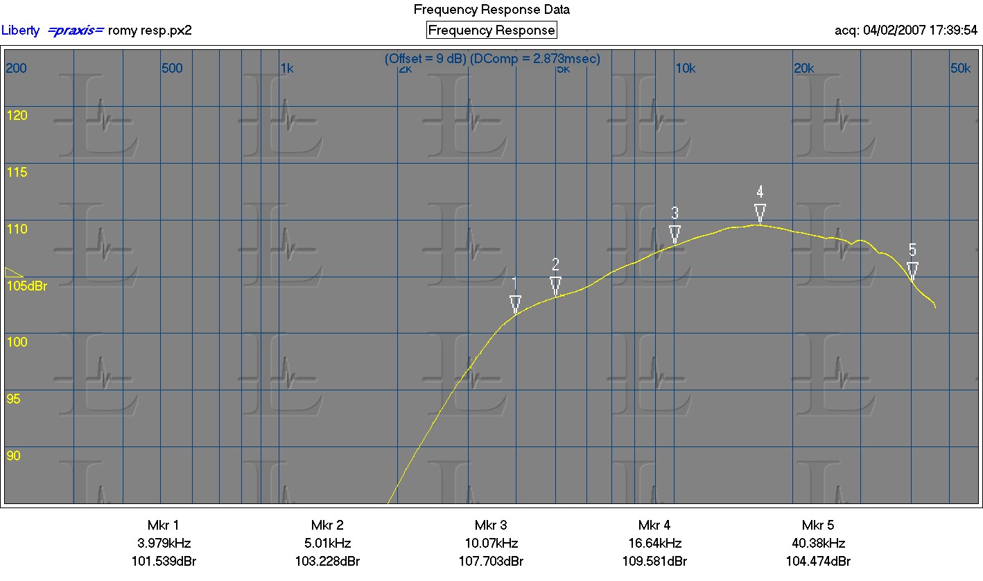

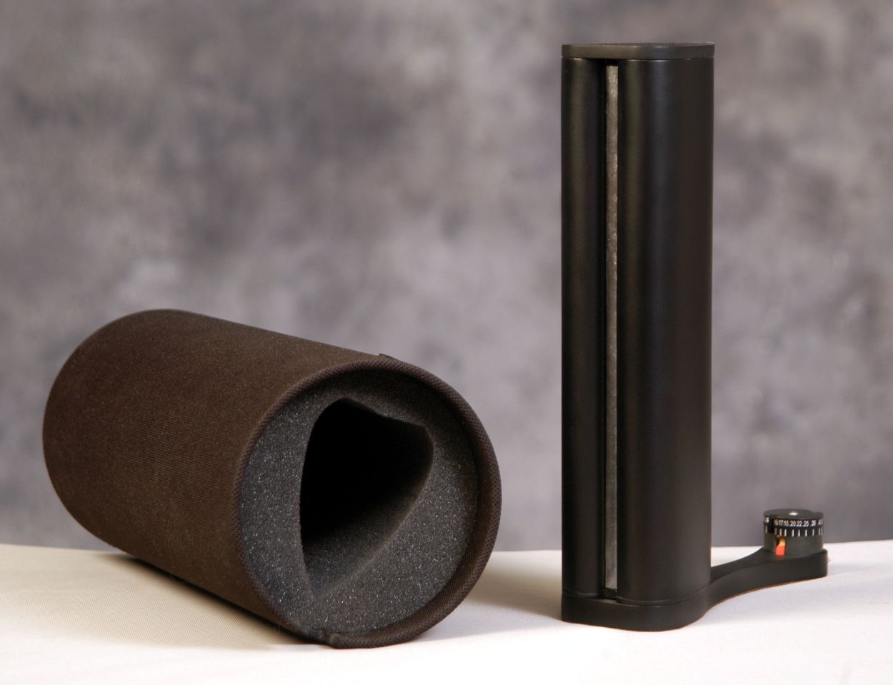

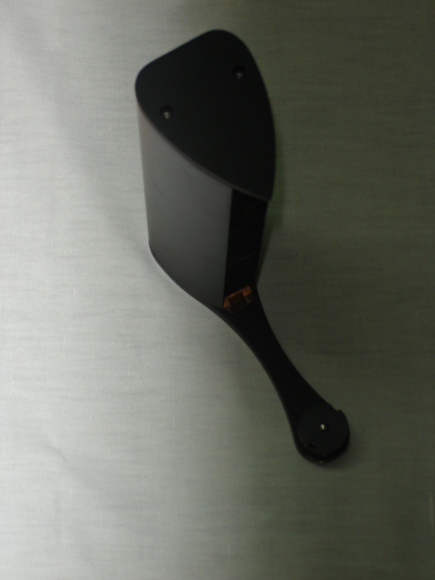

Pictures and measurements attached. I don't consider the drawing confidential any more. I don't have the polar plot, but I bet it is at least 180 at 15k, as it sounded like that.
Frequency response measurement is raw data, just like CSD and Impulse response. No smoothing. The triangle "intro" before the rising edge of the impulse is a D/A converter artefact. The positive peak of the impulse response looks lower than the negative, but in fact, the positive peak maximum fell between 15us sampling periods and it's interpolated to a lower value. It is actually very much the same like the negative peak, as this is pretty high-pass speaker, naturally. I haven't saved any more measurements.
Since this is a line source super-tweeter, it looks like extruded heart shape. Your thing could look like an apple with a dome in place of a stem, and now you have an orange, and you know what hey say about apples and oranges! 😀
