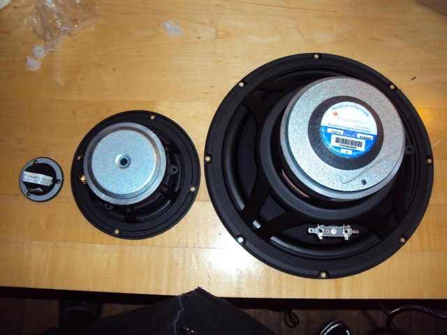

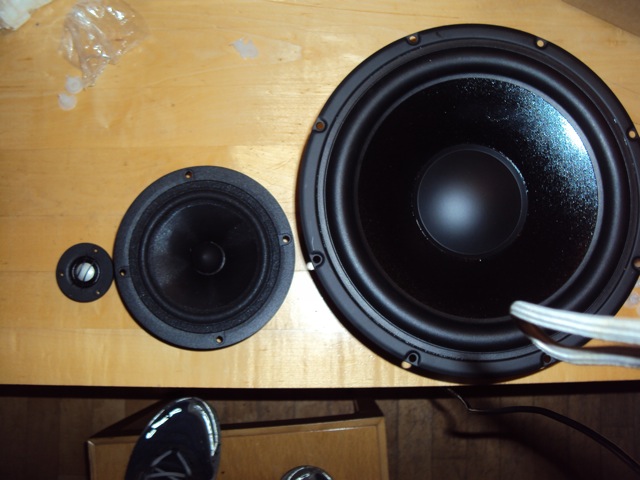

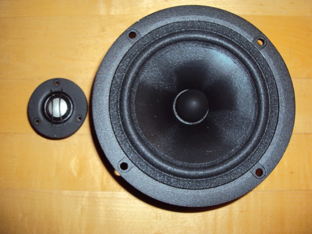

Today i got some interesting drivers. The new Vifa 19mm Aluminium-Ceramic tweeters,
the Scan Discovery 15cm midranges and the 25cm Peerless woofers for the ZDL.
I will measure the Vifa tweeters in open air like i did with the even smaller OX tweeter. The Scan midrange uses a fiber cone that is coated and cut at the edge (NRS- non resonant sourround). The cone apears to have a NAVI shape and is very stiff but well damped. The surround is a low loss foam. Sensitivity is quite high at 92dB but it is a 4 Ohm design. The magnet system has an aluminum Faraday ring to cut back inductance and lower modulation distortion. This driver coud be used in the deeper midrange in a 4 Way ZDL. I already have made good experiences with the 30cm version of the woofer so i do not expect a bad surprise here.
