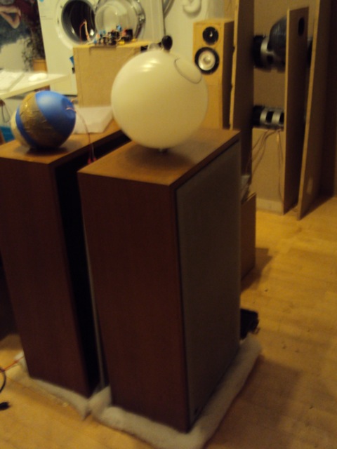

Still, after 10 pages, I'm still not clear of how you intend to align the drivers in the speaker. I would like to know how you go about the subject of time coherence for speakers like Herr Stolls and the Linkwitz speaker with the plastic pipes, where the woofer is positioned +/-90 degrees off the other drivers axes? Are you intending something similar?
This will be aproxomately how it will look. The tweeter is free standing on a nylon ball.
The midrange will be in this ball. Angling the midrange i can do time alignement. The woofer is an a conventional box. The reflex will be a big size port going from the woofer to the back. Between the midrange and treble i plan a low order crossover and between the midrange and bass it will be steeper.
