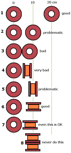

salas said:
Change the orientation and distance between coils. Mutual interaction can muffle vocals.
Great advice, I will have him get those coils upright. We will also change the polarity of the tweeter as well as has been suggested. Thanks.
Only one of the two upright, and perpendicular to the other. Listen like that before you change polarity!

SQ, have you scraped the wire varnish from the tails on the inductors? Could be as simple as that.
R-Carpenter said:
I don't think he understands the technical aspects of designing speakers and building them. That's why he's suggesting moving the crossover point. It may also be that he is used to a pair of speakers that don't have flat frequency response and Zaph's design doesn't have that bump in midrange.
A little presumptuous, but okay, whatever. The original AR.COM had a small dip; Ed Frias rectified that with an updated crossover -- the same version I have used in the 9 pairs I have built. So no, my ears have not grown accustomed to a wiley sounding pair of speakers; I assure you, there is no bump in the midrange.
I will have him check the varnish though, this was his first pair and he did not wait for me to supervise him.

However lets hope your problem is the inductor alignment issue
I described in post #56, rather than a different opinion on voicing.
