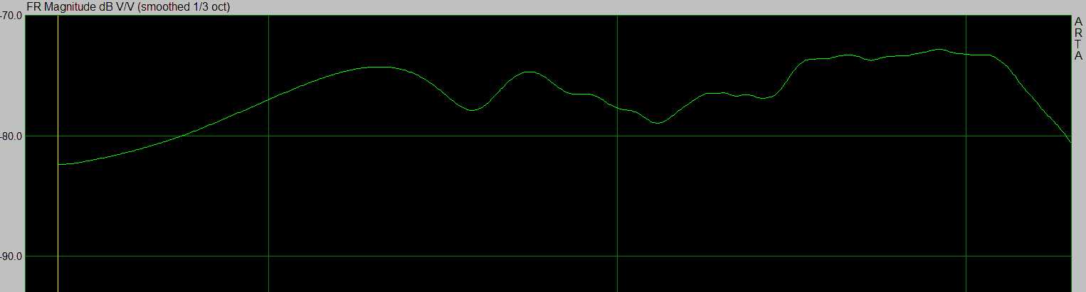

Looks like you've got some room modes going on there, were those measurements gated?
Yes, room reflections and diffraction from a sharp edge box, so not smooth at all. This is the SoundEasy MLS that is in theory, gated. You might read their users guide to find out. I have a small cluttered room. No choice about that. I don't have a great big basement and piles of old cotton pillows nor is my system portable enough to go outside where the ambient noise is so high I can't measure anything.

I don't think you're gating the measurements properly and this is letting in too much of the rooms influence, if you gate properly then you don't need to apply any smoothing at all. This is detailed in the guide I posted above. Don't worry if you're only able to get accurate data down to like 800Hz or so, this is normal in a typical listening environment/room, but it is enough to show if the integration between the tweeter/woofer is good.
The sharp edge box diffraction still made it look ugly, so the bit of smoothing just made the dip in response obvious, which was the question at hand, and the amount of droop I put in the treble to get it to balance clear. But yes, this was a quick first attempt to understand how to pick the window totally new tool for me, lots to learn. I do get similar results to my other two methods.

Well with 1/3 octave smoothing you can't really tell anything for sure.
When you don't gate measurements properly you get the room and any reflections contaminating the results. Now if the amount of reflective sound is low you can use a small amount of smoothing (1/12th octave) to get rid of it. However when things start getting worse, peaks and dips that aren't supposed to be there, start creeping in and no amount of smoothing with get rid of it, not to mention the smoothing gets rid of any dips or peaks that are supposed to be there.
To be sure of exactly what's going on you need to gate out all the serious reflections. Reducing the gate length reduces the low frequency accuracy, this makes getting measurements down low really hard, but in most cases it doesn't matter. Most crossovers occur around 2kHz and a short gate is more then enough to accurately capture what's going on.

Agree. Played with it some more. The result is the same basic profile, less low end as expected, and a lot of the expected ripple from diffraction. Shorter gating helps show the diffraction problems that one may otherwise blame on the room. Even with no smoothing, the same mid-range dip. By smoothing, you can get a better idea of where you need to put the new poles. I am doing a lot of comparisons between the three tools. That is how you learn which tells you what. You still have to link that to what you hear. When all is said and done, it is my wife's and my ears that I have to please. Really, I just need to decide which of the issues I will take on first. I have some ideas about the diffraction I have not tried that could help with setting the offset. I have some ideas on internal cabinet design to reduce reflections that need testing. Of course, lots of crossover work. The success so far is even in this state, it does not have the edginess with horns that bothers my wife. I can no longer attribute it to the tweeter breakup, but on basic driver distortion. It is quite listenable.
Considerably more progress. I was playing around with different edge radius profiles while comparing ARTA to TrueRTA quick sweep and SE MLS. ARTA does seem to be a lot better at showing issues, where the gating in Quick Sweep is too long averaging things out. In a small room, through the crossover region, I think I trust ARTA for flexibility. It looks like another tool in the kit. It is much friendlier than SoundEasy within the limits of what it does. If paying the license allows me to save plots and overlay them, it is worth the cost. Beats screen print and holding the pages to the light. I see issues in the same places with all three tools. Changes are reflected proportionally in all three tools. I doubt any of them are correct, but between them you can build an understanding. TrueRTA has an advantage that you can choose how much smoothing in a display and it holds 20 plots to compare. Sound easy has the advantage of plugging the acoustic and impedance/phase data into its design simulator.
Simple conclusions: Bigger the radius, the better. We knew that. Bevels not as good as radius. We knew that. The better managed the diffraction, the less over-hot the tweeter sounds. I did not know that. The last test was 2 inch thick foam with a cone cut out of it centered over the tweeter. On axis, very nice. Returned R5 to original and it balances better. Off axis it is a bit dull. I still think it has too much BSC, but I am not unwinding expensive coils until I build the next prototype box. Of course, changing the edge radius changes the baffle step too. Again, we knew that.
