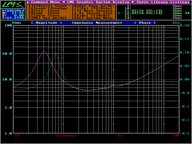

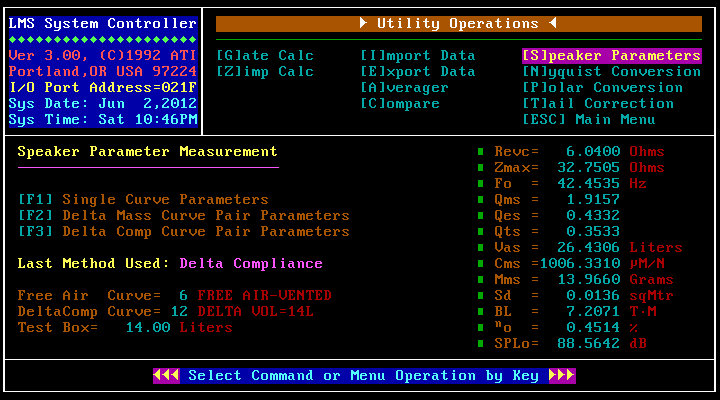

ER18 re-measured
These are the new measurements done with Delta Comp. Sealed Box Vol is 14 L.
Goran, they appear to be similar to your sample #2. I'm getting a VAS of 26.43L.
5th, you're right, Mms = 13.96g.
Thanks for highlighting a possible fault in my initial measurements. I eventually traced the culprit to typo error. Added weight was actually 22g but I enter it as 12g.
Fortunately, even with wrong measurements, it worked out for me in a 14L vented box.
Hi Michael, it's nice to see you've solved the issue. Aside from just the numerical error, the impedance plot of the second lot of measurements looks a lot smoother then the first too.
Yes, now it looks as it supposed to do with a smooth impedance curve and all. Seems like a reliable measurement.

Thanks, my initial measurements have always bugged me. It's comforting to know that my new TS are now closer to Seas.

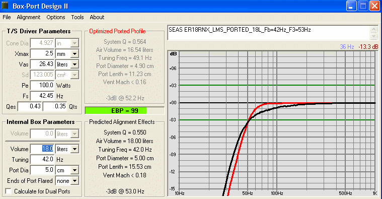

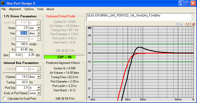

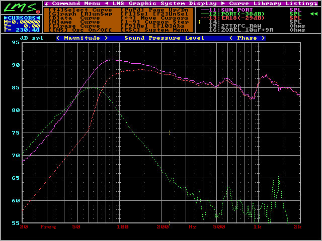

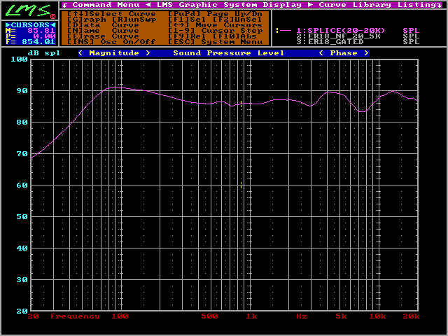

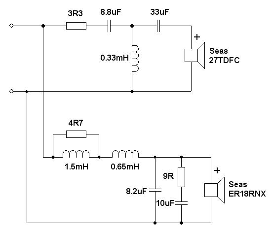

In my ER18, I went for mid-bass instead of the lowest F3. Sequence of pictures are:
1) Simulation on Goran's 18L box (new TS)
2) Simulation on my 14L box (new TS)

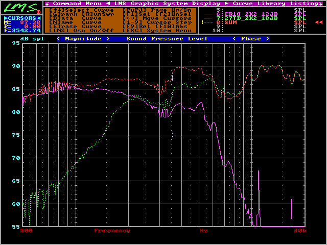

3) Summed Response (PURPLE) of Port (GREEN) and Near Field Response of ER18 (RED). Accuracy up to 500Hz.
4) Gated 1 meter 2.83V Summed Response of Crossover (2,200Hz - RED)
5) Spliced Frequency Response of Bass and Crossover Graphs. Spliced at 500Hz.

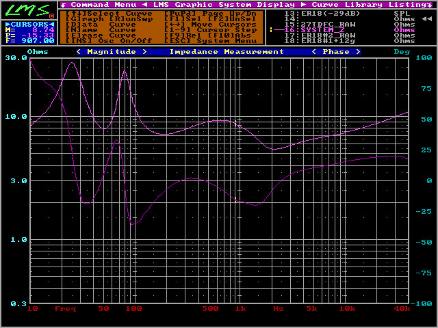

6) System Z
7) Crossover Network (2nd order + 5dB BSC for ER18; 3rd Order for 27TDFC)

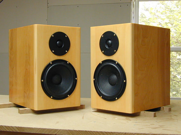

8) Finished Speakers

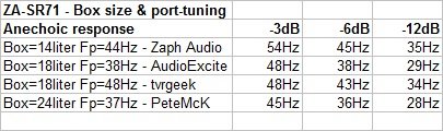

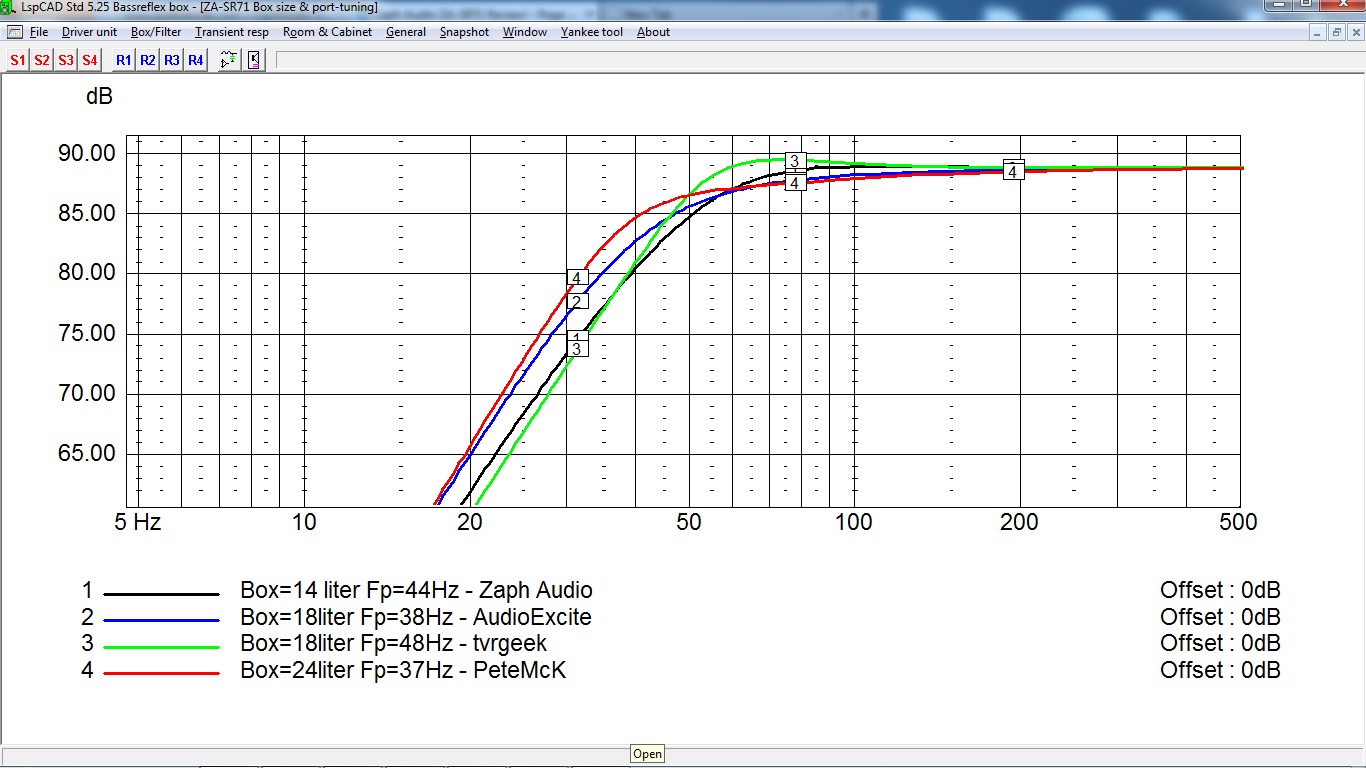

I'm thinking of building the SR71 to be powered off my P101 (high power version) but I'm undecided if I'd use the same box volume as recommended by Zaph. I'm planning on using this without a sub so what do you guys suggest for box volume and tuning? (I'll be keeping the baffle width but can adjust depth and height to maintain the response with the baffle step compensation as designed as I'm getting the Madisound parts kit)
