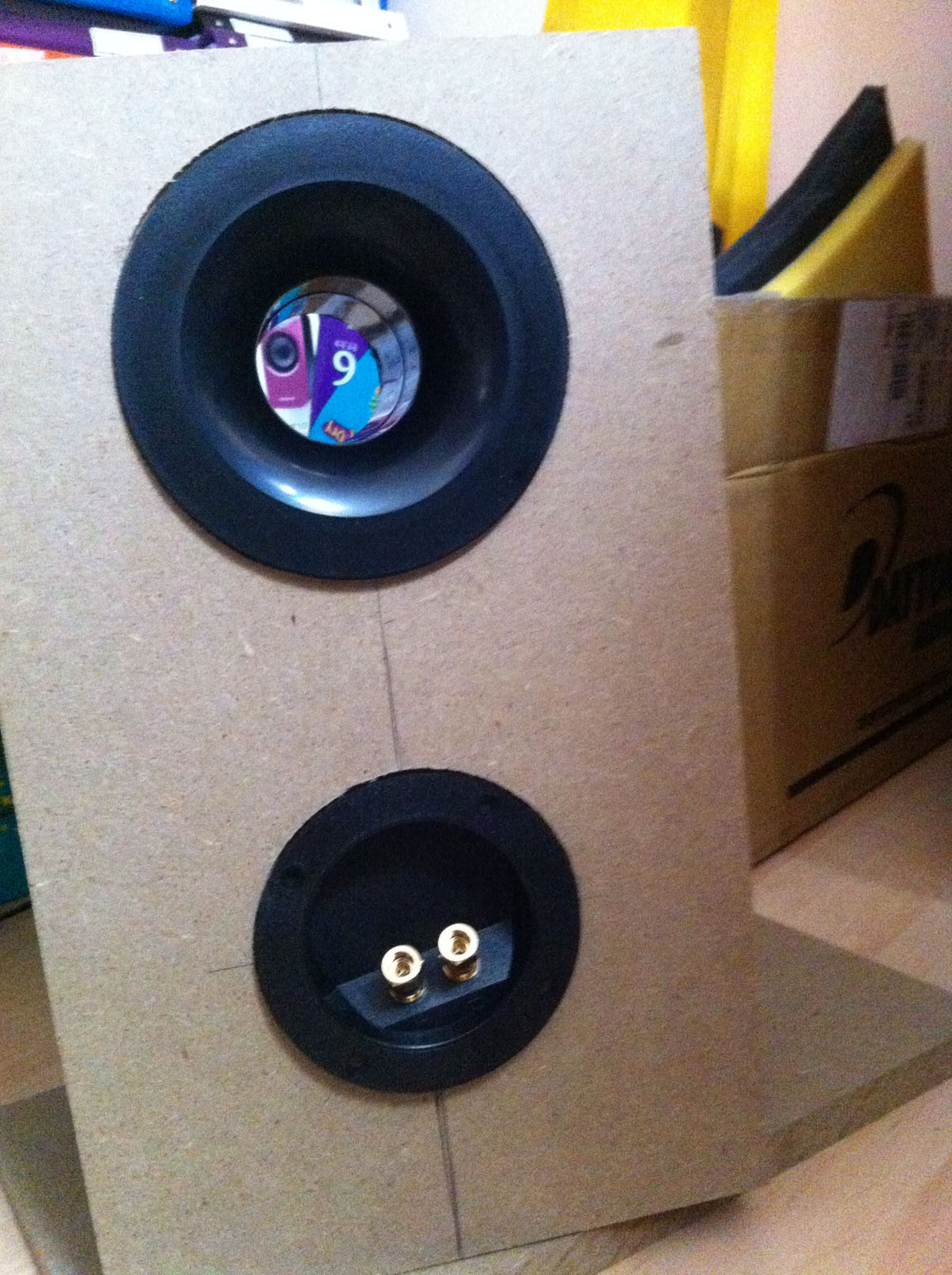

I am currently in the process of building a pair of these great speakers, and I have a couple questions.
As I am in France, I have to build the cabinet myself. To do so I have to round the dimensions (imperial to metric), how much precision do I need to have on the internal volume ?
What do you think of having the crossovers separated from the cabinet ? Is it an improvement ? Do I need to lower the internal volume if I do so ?

Shouldn't have any problems with volume if you use this:
Metric Conversion charts and calculators
You can mount xo in base or back, however, I don't think you'll hear any difference.

Thank you for your reply.
The conversion from inches to millimeters is not a problem but then I get dimensions with a precision down to a tenth of millimeter which is too precise to be built. Therefore I wondered how much rounding I could do.

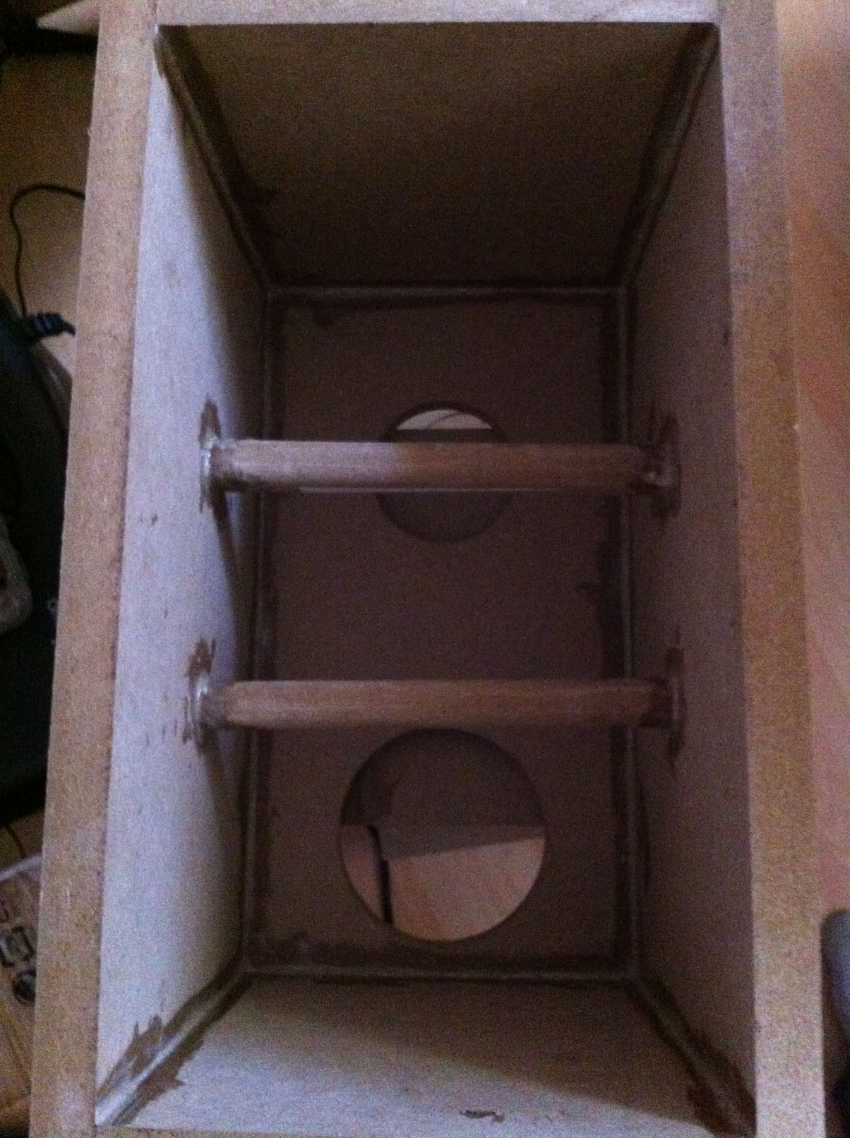

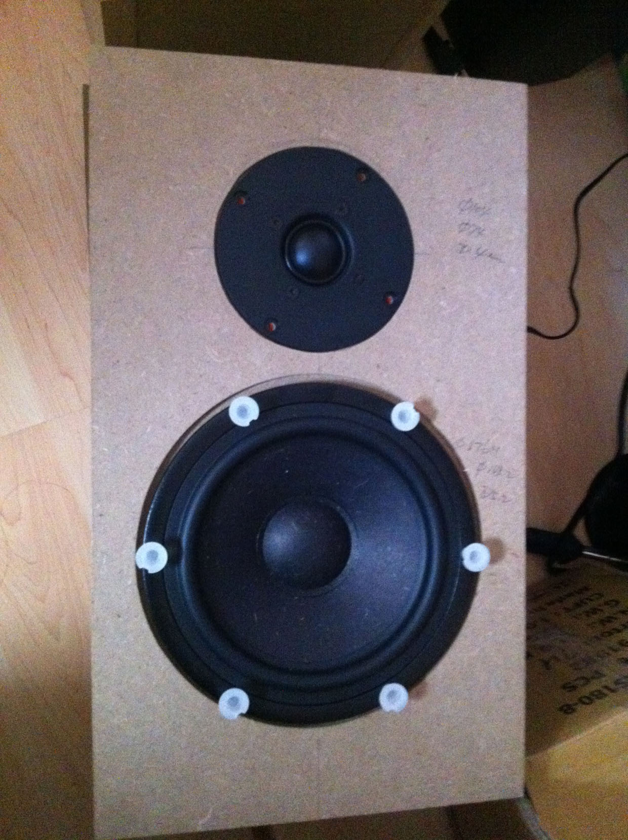

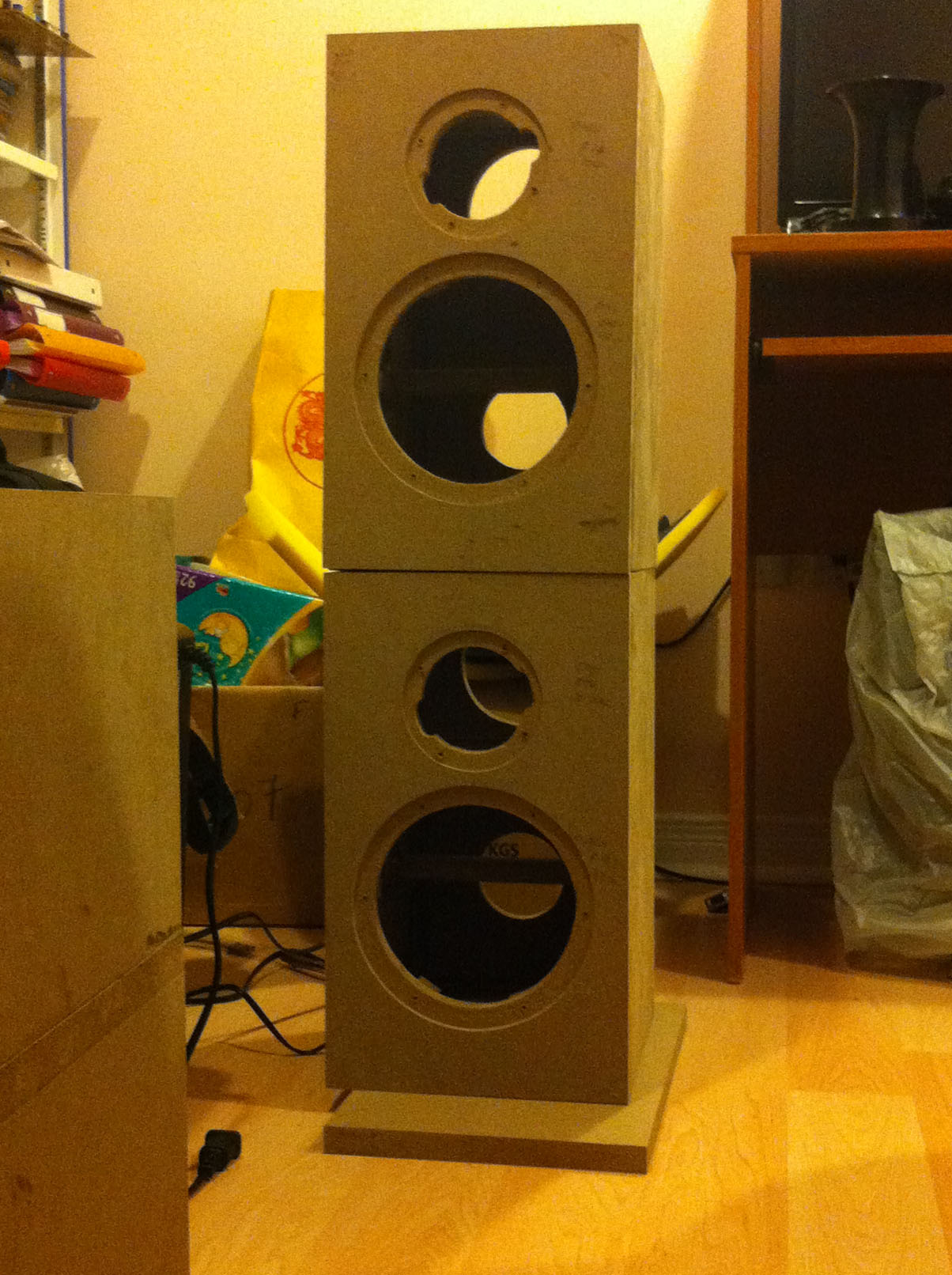

I think I made a mistake and I need your help.
I decided to make the sr71 with 22 mm mdf because I had some. I decided to keep internal dimensions so the baffle is 6 mm wider... Also the tweeter is 6 mm further from the top... I know I shouldn't have changed these particular dimensions but it's a newbie mistake ... And it's done. Hower, driver distance from each other is kept the same.
I need your help to know whether this is going to change a lot sound wise and if I need to start again from scratch ?
Thank you for your help.
SimZeSun

Worry not about the twitter position from the top(a little bit off-axis impact, won't affect your listening)...the distance between twitter and woofer is much more critical.

So I shouldn't worry about peaks and dips induced by diffraction ? Besides the change from original dimensions is limited (6 %).

Sorry, not diffraction but baffle step.
SimZeSun
baffle step is baffle diffraction, and is mostly for woofer, which should be taken care of during xover design...and the baffle width matters more in this case...
anyhow, I understand you want be perfect, you can sand or cut the top of the baffle a little bit to some angle...

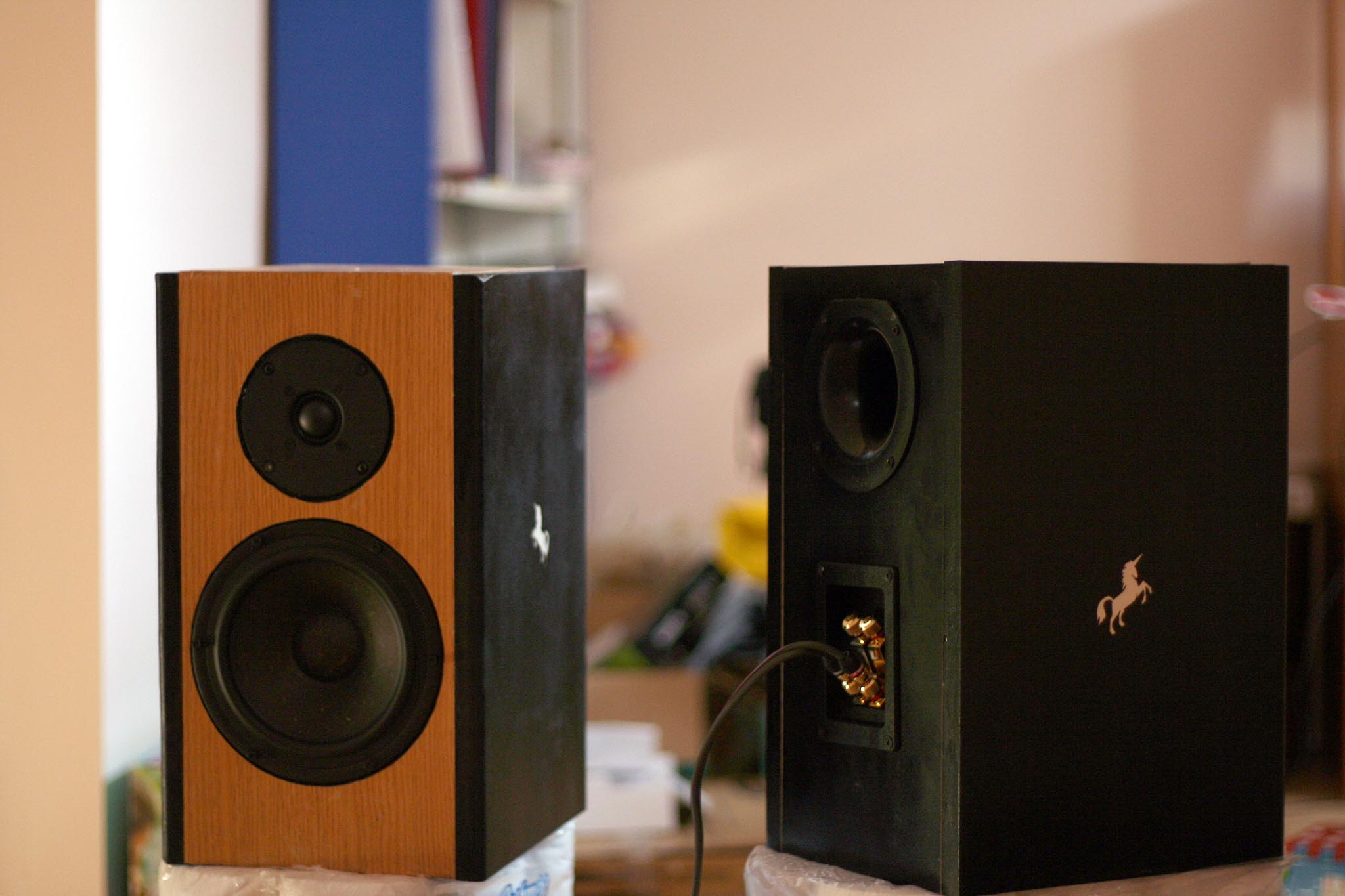

Zaph did a wonderful design, and these SEAS drivers are awesomely good...I have built SR71 for myself, and I am building another one right now for my friend.
The build in progress..
