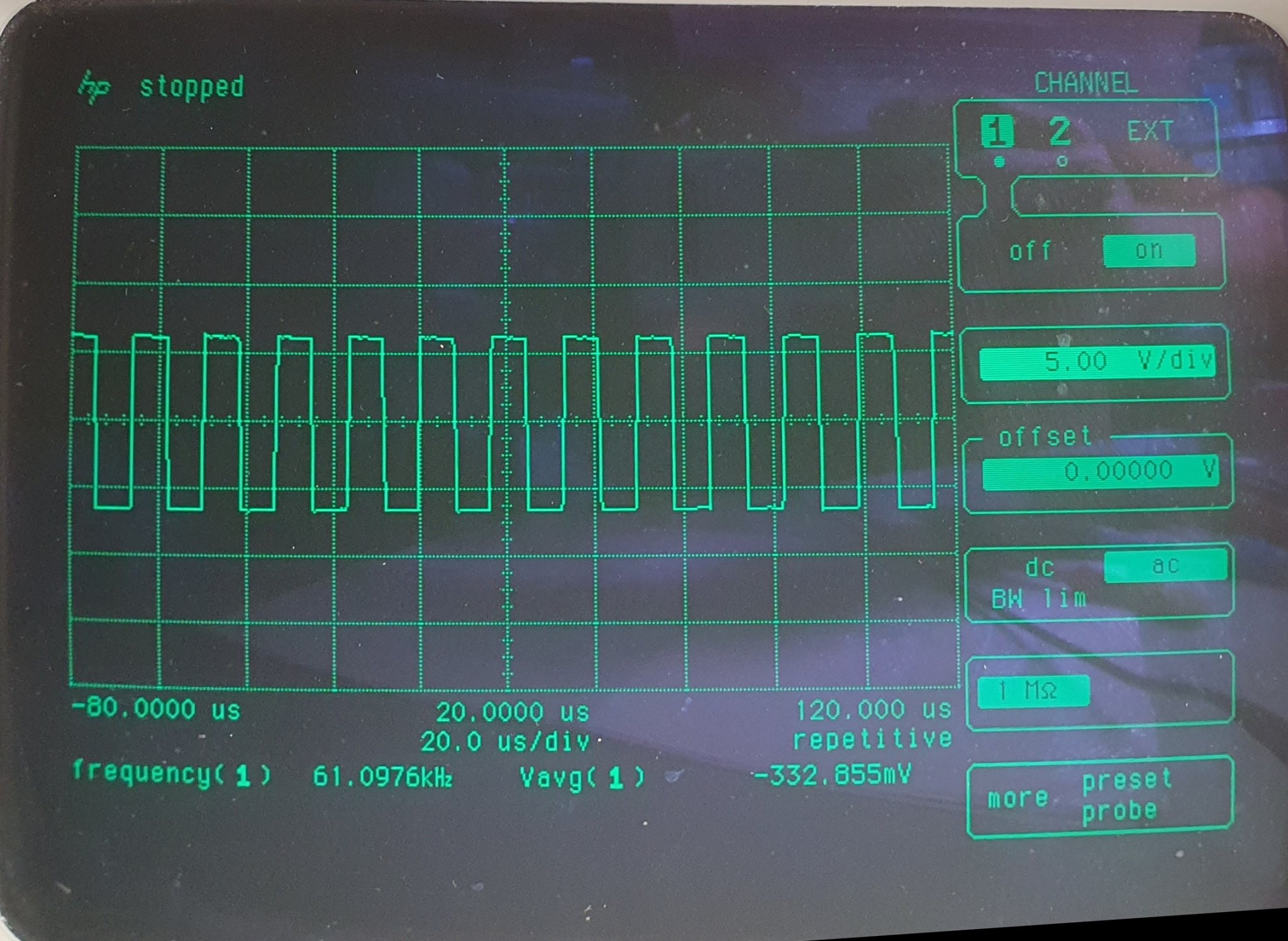

±61KHz
I notice that the square wave takes on very strange shapes at very low frequencies during startup, for a few seconds, until it stabilizes. This only happens if I limit the input current to 3A.
I am attaching a photo of the square wave once the amplifier is working.

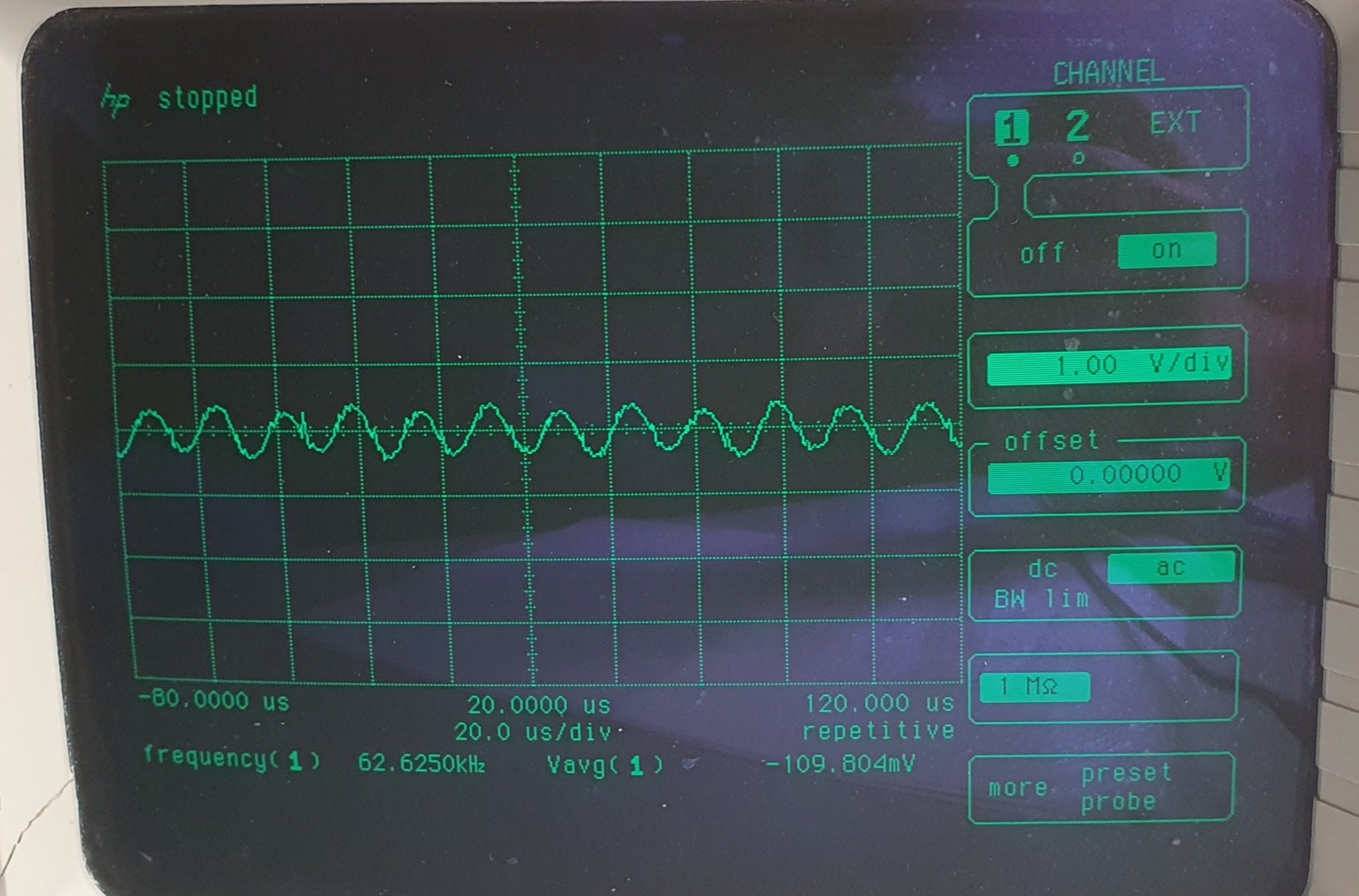

Yes, under the two inductors the board seems to have been heated.
At the output of the two inductances I obtain a rather low value. (Probe 1x)

The 61k idle frequency seems a bit low and could cause undue heating of the inductors. You could try injecting a higher frequency (into the driver board) to see if the idle current drops.
Excess heating for a long period could change the property of the cores which could make them more lossy (less efficient).
I don't know if changing the value of the component to increase the frequency is the right solution. Let me explain better, I also thought about increasing the frequency in this way but I also think that if before burning out the output everything worked and absorbed less than 2A at idle, I imagine there is still something to check, probably broken or out of value . Correct me if I'm wrong
That said, I imagine that the ideal working frequency for this output section is around 120KHz, similar to many Korean amplifiers built this way.
I think the inductors are the problem. I think they ran too hot for too long and have changed properties.
Do you have inductors you can swap from a similar amp?
The self-oscillating amps typically drop in frequency at higher power output. This will compound the problem you have now and the low frequency may have caused the inductors to overheat, causing the problem you have now.
Do you know how hot the inductors were running previously?
