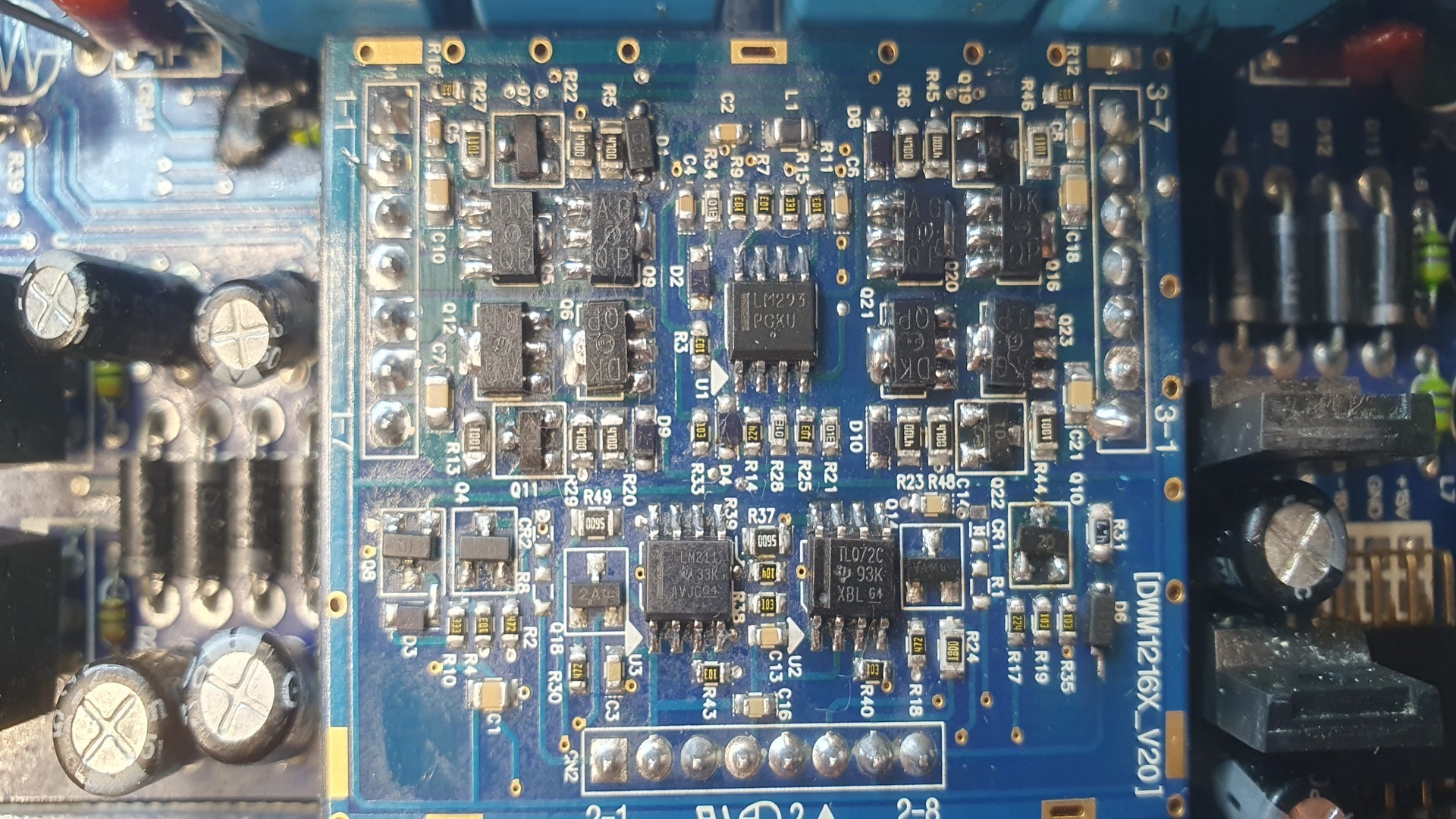

I can chime in to share some information I've gotten from working on many zapco sp2000s.
They are simple amps, but quite mangy.
When you have to change the output mosfets and turn on the amplifier without them, you cannot and must not use supply voltages higher than 11 volts, since the rail voltage that is too high, in the absence of the output mosfets, will damage some components on the audio driver board (including 470ohm resistors).
The zapco sp2000 have a design defect that causes NON-polarized capacitors marked CE5 - CE6 - CE12 to fail.
The power supply has almost nothing to do with the audio part.
The correct audio switching frequency is in the order of 110khz and higher if you increase the battery voltage.
The C13 capacitor on the audio driver card must not be 1200"NF" but 1.1NF, in your case, you said you have a 1.2uf capacitor, which is huge, you can confirm that it was a writing error ?
The 2 large inductors, by nature, heat up, especially in this amplifier model, so it's quite normal, even if excessive heating is harmful.
This amplifier model, if powered with little current, is not able to start the oscillation perfectly, so it will tend to absorb all the current you give it (if it were only 6 amps, it will absorb them all), if instead, right from the start, you give it at least 12/15 amperes, the class D stage will be able to turn on correctly, and this will cause the right absorption of the power supply (in my zapco 2000 the right absorption is around 15 Amperes in turn-on for 1 or 2 seconds, then it must settle down to 2.5Ampere).
Check all gate and pulldown resistors of all output mosfets and especially branded low value resistors R46 - R22.
From experience, I usually replace the original transistors on the driver board with FCX690BTA and FCX790ATA, obtaining results identical to the originals, perhaps better.

Good morning Mario, first of all thank you for this information. As for the supply voltage, good to know, I tested the amplifier several times without mosfets, but every time I used a voltage even lower than 11V. (I increased the voltage only now that the amplifier is complete, to carry out the tests indicated in the previous comments)
Therefore I feel comfortable from that point of view that I did not make a mistake by powering it when the board did not have all the components.
As for the final stage capacitors, I replaced all the electrolytics, and measured the 7 non-polarized ones, obtaining correct measurements.
Regarding the C16 capacitor, thank you for the correction as I would never have noticed otherwise, the correct value is: 1.2nF.
All resistors have been replaced (10Ω and 100KΩ).
The two 2W resistors R22 and R46 are good, measuring 47Ω.
As for the mosfets, I managed to recover a batch of IORs identical to the originals (IRF9640 and IRF640 non-N).
As for the power supply, if I power it without limiting the current (40A maximum), after the initial shock, it stabilizes at 6A±.
I don't understand this anomalous absorption at idle without load...
Good morning everyone. The problem has finally been resolved.
Yesterday I built two new inductors with a T130-26 dual toroid core (identical to the original).
The calculations of the relative turns were obtained through the Coil64 calculator.
Having as a starting point the core type (T-130-26) with a permeability of 75, I built the two new inductors using only an 18awg wire and not 6 as in the original, as they would have only served me as tests.
If they had worked I would have rebuilt both with all six wires to increase the current carrying capacity.
After completing them I got two inductors of 76uH and 74uH.
However, after having mounted them, the situation did not change, the amplifier consumed a lot of current when idle and the inductors were as hot as before.
So I reassembled its originals and took a look at the driver circuit again.
Having changed all three ICs, I began to doubt that there was something faulty, and in fact, tl072 was probably faulty (installed new a few days before).
After replacing it with a new one, the amplifier works properly again.
Its idle current dropped to 2.59A at 14V and the frequency stabilized at 130kHz.
Thanks to everyone who helped me understand more about it.
