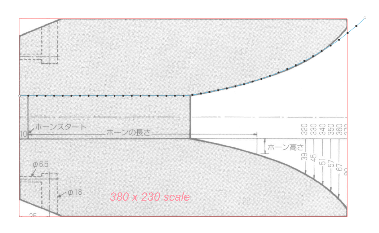

From a technical design standpoint I think a revised A290 would need very complex 3D CAD modelling through the throat section, something much more organic than the parallel walls and basic geometric shapes of the existing design.

I could send you the complete model with adapter and interfaces. We added an exponential adapter which had a quit coarse mesh but it worked better than expected.
I scaled and perspective corrected the scanned page @fluid posted, overlayed the XY points from the table on the previous page. It's a lot closer than the hand drawn yuichi plans I tried previously but still seems a bit off. Also the 6 vertical measurements shown differ from the ones in the table..... I wonder if scaling and tracing the scanned graphic would be more accurate
The vertical profile and fins in the V2 CAD file are created from an excel calculator generating a CSV and a spline going through them, I am sure that these are accurate to how they should be for the intended design. The horizontal does not have a similar calculator and is therefore open to some interpretation. The values from one of the drawings goes not give an easy curve to match. Yuichi states in the information document that the drawings are indicative and not absolute, it is a demonstration of how a horn of this type can be built and not a definitive plan. There is no huge discrepancy between the two versions here. Either would work and produce something quite similar. The radiation impedance shows that they both work closely to the intended Hypex horn. The horizontal polar in post 1 shows you how the V2 surface model will perform (within the bounds of the predictive ability of BEM), I personally think this is closer to what was intended than can be had from religiously tracing the images.I wonder if scaling and tracing the scanned graphic would be more accurate
