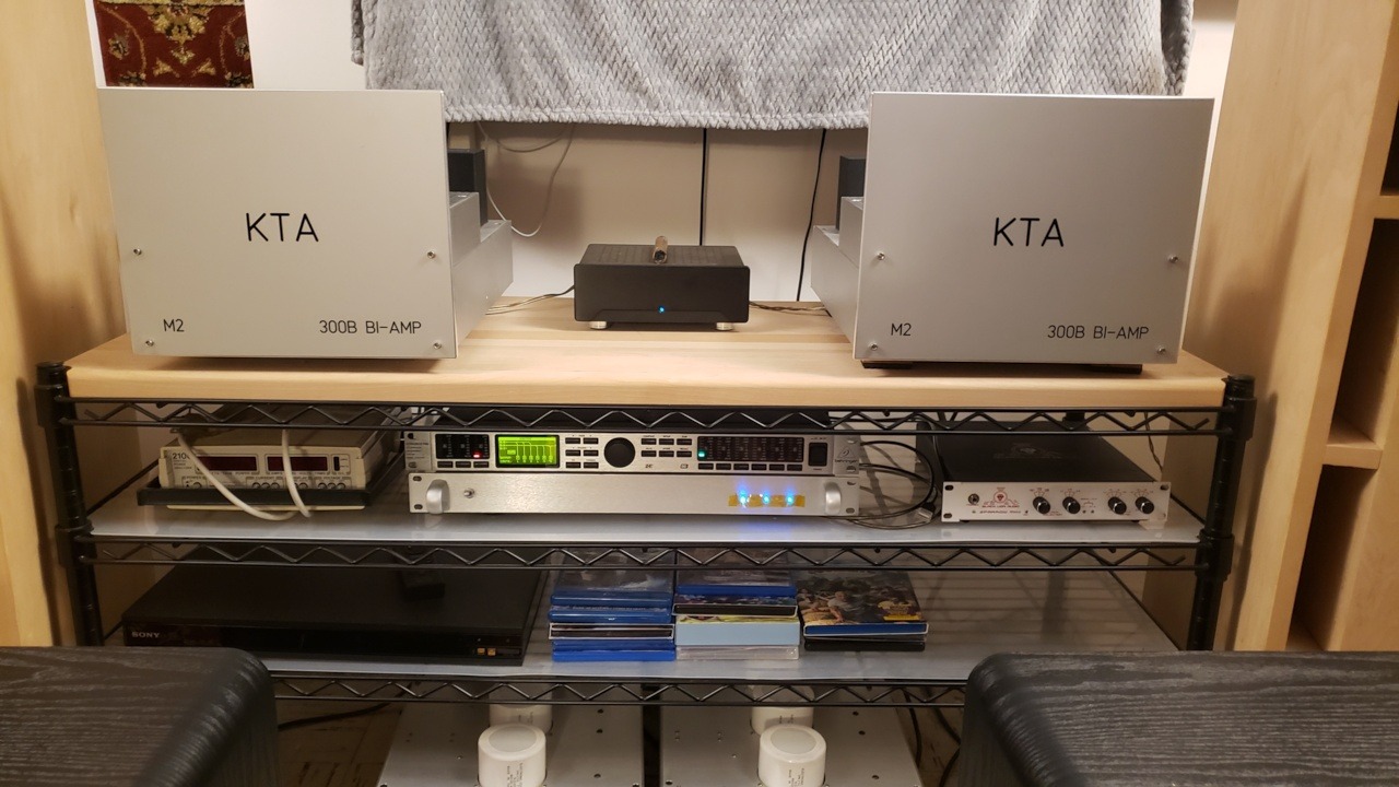

I use FaitalPro HF10AK 1 inch drivers on FaitalPro STH100 tractrix horns to cover everything above 5.3kHz. Originally I experimented with crossing at 8kHz and as high as 11kHz. I thought about Yuichi A-1K horn for the tweeters but probably will not proceed.
I use a combination of MiniDSP SHD Studio, RME ADI-2 PRO FS R (AD/DA) and heavily modified DCX2496. Sources are both analog (through the RME) and digital (streaming to the SHD)

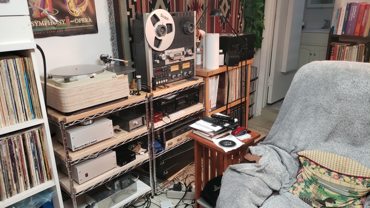

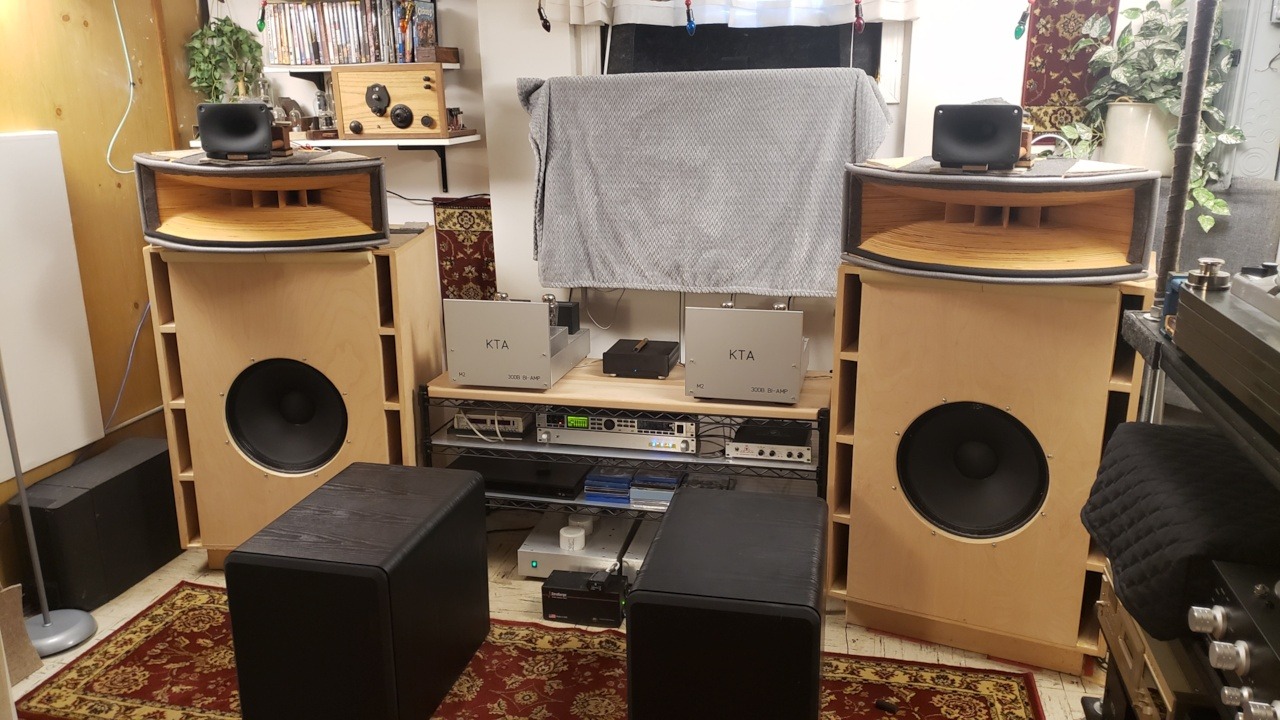

At the risk of embarrassment sure, and it might provide some hints about what I am struggling with. 😀 The room is small and very crowded, there is an electronics work area, a small machine shop and this stereo system and a small home theater. I don't know of too many hobbyists who have crammed so much into so little space. No doubt a bigger/emptier space would be a lot better for this system, but a good part of it would not exist were it not for this unlikely space.
The acoustics are not brilliant, but a lot better than you might suspect from the pictures.. Oh, and there goes the last shred of credibility I have.. 🤣

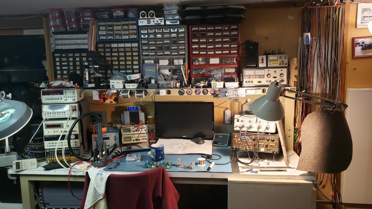

The bench... There is a 5000 series Pico Scope on top of the RTX which is not really visible.

Thanks for the pics......very nice.....yes, a bigger space would allow for the system to " breath ", so to speak....however we must use what's available , and you did an admirable job....
