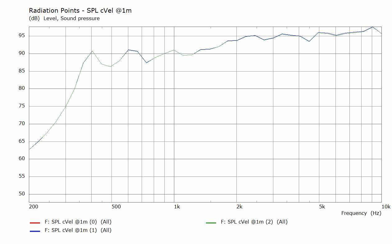

I largely prefer to see the radiation polar how VACS is presenting them rather than looking at the fields. Could you provide this?
Ok, I will provide Acoustic Impedance, Onaxis SPL at 3 meters, Farfield Horizontal/Vertical polars responses and the Balloon graph, and Directivity index.

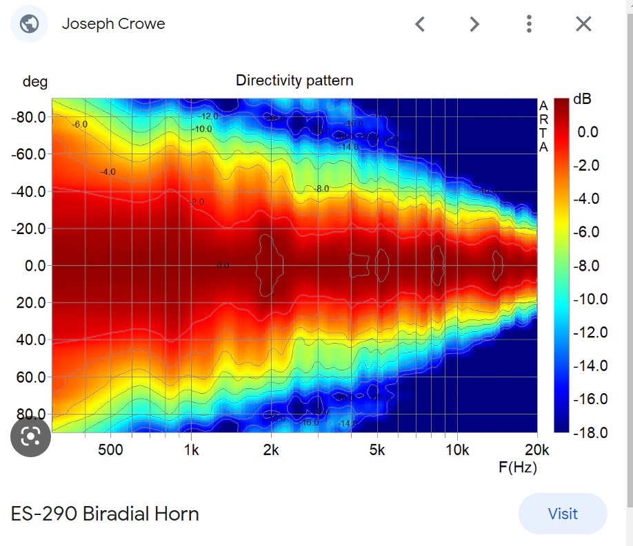

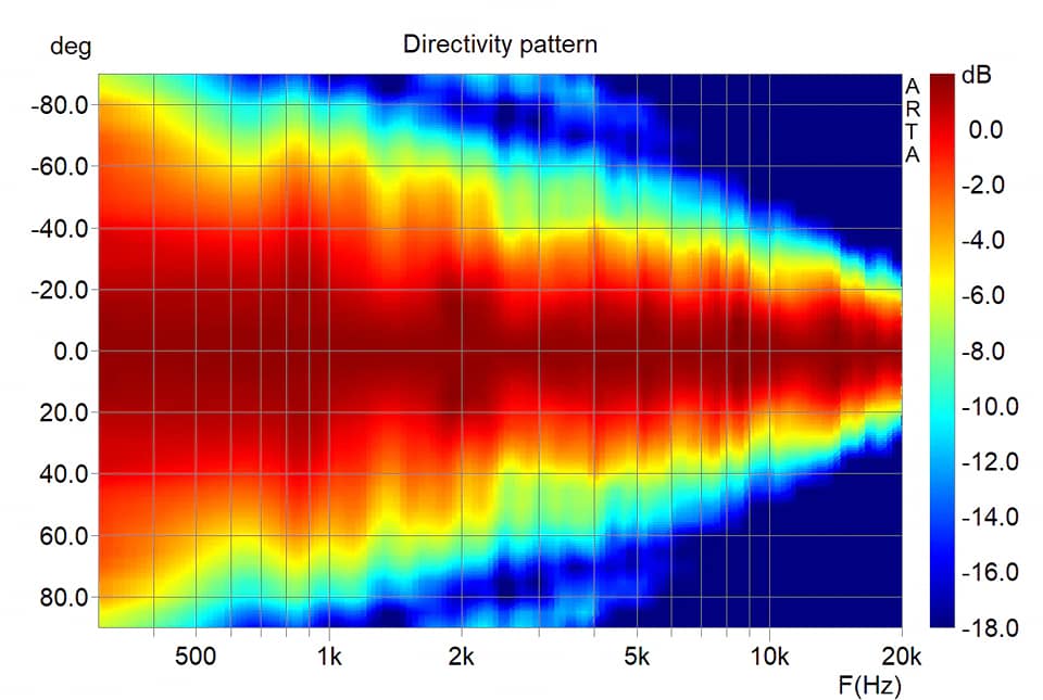

That is not the polar map for the ES290. The latest test data is shown below.The ES-290 is not a Constant Directivity Horn, it's not the same familly of horn.
A horn with fins as it's own way to radiate energy thanks to fins, where on a regular horn energy in +/-15° is very concentrated close to the 0°, on a horn with fins it's on +/-30°, it completely change the listening experience in room (due to side reflections).
Also, don't remove fins, they are here also for respect hypex surface law, if you remove it the behavior will be erratic, whatever the form of sides.
Maybe Joseph mimic the A290 sides and does it's own horn based of this but it's his own in-house horn, very different to an hypex with fins bi-radial.
If you don't want fins and CD behavior there is Ath4 OSSE or R-OSSE and HCD (hypex constant in H 75/70/60°) that are great.

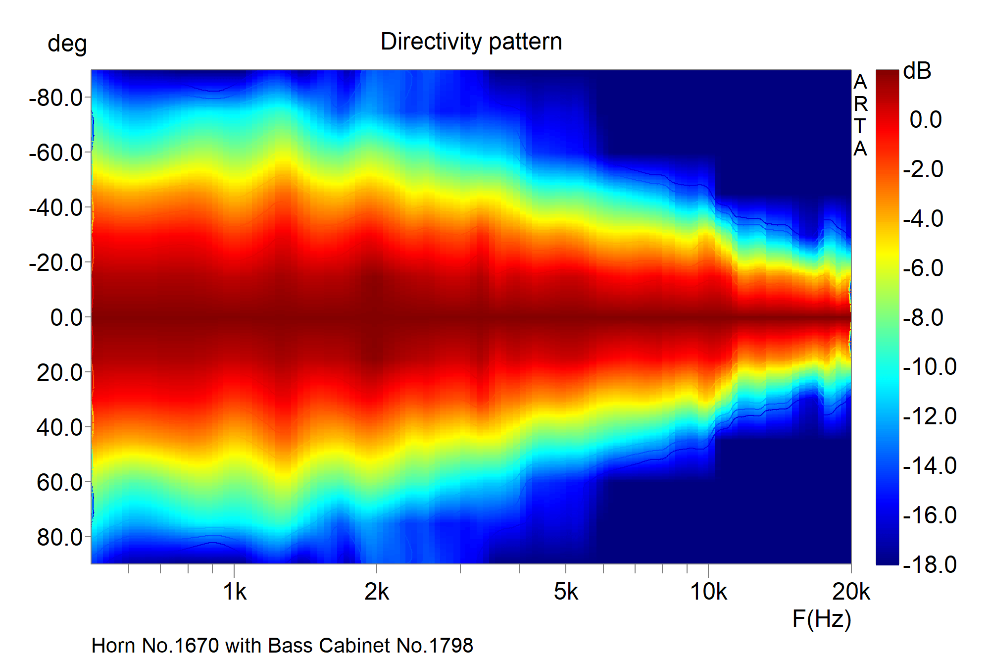

Here the ES-290 polar :
The ES290 is designed to provide a gradual narrowing of directivity that is well behaved, consistent, and wide. Typically the treble is handed over to a dedicated HF horn with matched coverage anywhere between 4kHz-8kHz depending on the solution. The other critical metric is a smooth on-axis frequency response. All other comparisons should look at this closely, since a linear response is an indication of a trouble-free time domain (resonances, diffraction etc.). The response below is with the RCF ND850 compression driver, just for reference and comparison against other possible solutions (Yuichi A290 for example).
If a design achieves so called 'perfect' constant directivity, but at the expense of on-axis linearity in the frequency response, then you can kiss any sonic benefit goodbye.

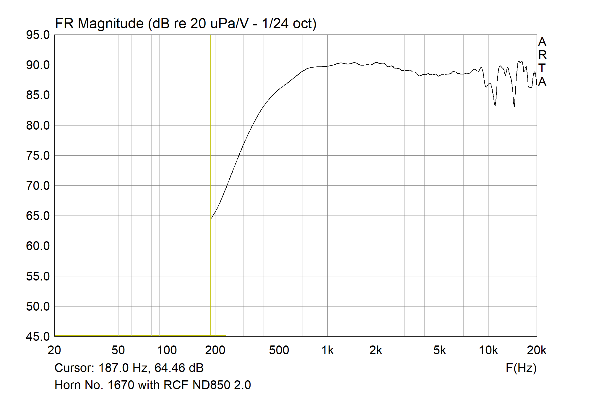

These are results that imply some further questions. Is this the raw response on-axis without any eq?
If so I would say that it implies that your horn does neither provide sufficient acoustical loading nor directivity control and it would stand diametral to the horn class presented in this thread.
Also the Axi2050 has only about 5dB decrease in your presented measurement in this horn up to 20k. This is physically impossible (with horn loading) as in a horn with sufficient acoustic loading the Axi2050 is about 25dB down at 20k compared to the midrange. The amount of beaming in your horn seem to compensate some of the natural decrease of any large format compression driver (on axis) at the expense of the off-axis response. The same for the RCF driver. Less than 5dB decrease. How is this possible?

The majority of these simulations were performed with constant velocity instead of constant acceleration. This makes no difference in normalized polars but it does in non normalized ones. A constant velocity will give a rising slope whereas constant acceleration will give a falling one which is the more common presentation. Neither is "right" so it is a matter of picking one for the job at hand. Posting constant velocity curves would just confuse most people and create a lot of noise about it so I didn't. This is the on axis of the V2-3 simulation, a relatively smooth upslope, no cause for concern there.

It is interesting that google still has the file in cache what @NicoB posted here:Just reiterating the design goals for the ES290 Biradial, which puts emphasis on low coloration, perfect time domain performance, as well as a well behaved, consistent off-axis character. Typical of all exponential horns, loading is improved in the upper treble compared to an equivalent constant directivity design. These are all very well known trade-offs. I only caution that in the pursuit of constant directivity, on-axis frequency response may suffer as a result. The simulations I saw earlier in the thread only showed the normalized polar map characteristics. Like everything in audio, a balanced design looks at all the parameters and settles on something after juggling all the variables and deciding what is important. There's no right or wrong, just specific design goals.
One big difference to your newly provided data is that you missed almost one octave to the low! They new graph begins with 500Hz where your old graph show some midrange narrow. This is some kind of clever if you want to fool us. Who is familiar also know how to tune these graphs with special settings/constraints to look better or worse.

You state so many misleading things here and on your site regarding the ES290/Yuichi that I really do not know where to start.That is not the polar map for the ES290. The latest test data is shown below.
The ES290 is designed to provide a gradual narrowing of directivity that is well behaved, consistent, and wide. Typically the treble is handed over to a dedicated HF horn with matched coverage anywhere between 4kHz-8kHz depending on the solution. The other critical metric is a smooth on-axis frequency response. All other comparisons should look at this closely, since a linear response is an indication of a trouble-free time domain (resonances, diffraction etc.). The response below is with the RCF ND850 compression driver, just for reference and comparison against other possible solutions (Yuichi A290 for example). View attachment 1165350
Ok, is a linear response really a proof that the time domain is fine or that you do not have any resonances/diffraction? First you have to precisely define what you mean by using the terms resonance and diffraction, either driver or horn related. The time domain issues are largely related to the driver in most cases. When you measure what you say linear response then you should bear in mind that your driver/horn is radiation into space and your mic capsule is only measuring a very very small fraction of this. When you have a linear and even level on-axis response then this means in almost all cases with a general compression driver that you radiate your lower frequencies into a larger space because the horn is loosing directivity control at a certain frequency when the corresponding dimension is in the range of one wave length and this might happen in your horn.
You say that in exponential horns loading is improved to higher frequencies which is not the case. This has less to do with loading and is mainly related how you radiate the sound into space as already described. Pure exponential horns tend to beam towards higher frequencies and therefore tend to concentrate the radiated power into a smaller space along the central forward axis and this is the reason why they have a more "linear" or more on level response but only measured in the central forward axis.

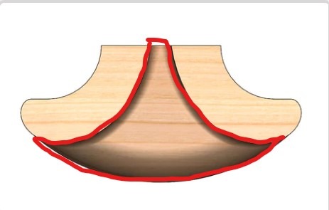

Your inlay looks like this:
The small red inlay is your horn (and it already has a rollback!) and it is looking very similar to a small Iwata horn. Although I have to admit that your products look stunning and are very well manufactured my pure technical point of view as designer is that the rest of the material is doing less to the horn performance and is integration waste. DonVK and I we did extensive investigations with respect to round overs and still a 1-2cm round over radius eliminates almost all of the diffraction issues at the outer edges of the horn. And off-axis performance is largely related to the horn profile itself and not the small portion of edge diffractions when treated well with a small round over.
Then you state that the fins in the Yuichi design are "dispersion fins" which is simply not true! This is a completely misleading advertisement of your product and bashes a design that is still way ahead of yours.
What about the vertical profile of the ES290? The vertical profile is the most difficult to get right in such horns. The generous round overs do not much anymore for horn loading or directivity control and the vertical of the ES290 is looking more like a slot radiator to me with a really generous round over. If we could see the vertical profile and resulting polar then I suspect that this is the "miracle" for your on level response as the horn starts to loose vertical control very early and tames the lower frequencies at the measured mic position.

"They new graph begins with 500Hz where your old graph show some midrange narrow. This is some kind of clever if you want to fool us. Who is familiar also know how to tune these graphs with special settings/constraints to look better or worse."

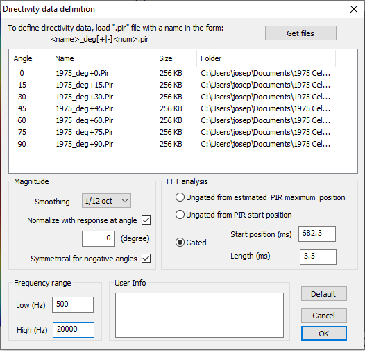

I've included the ARTA settings window below. What specific settings have embellished the results? Please be very specific. If you'd like I can share the ARTA .pir files so that you can investigate further.
