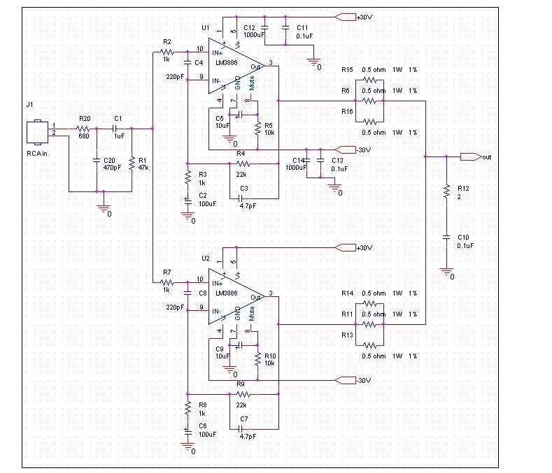

I need some help with these LM3886 boards I was talking about in my last post, I know its going off topic a little as the thread is for the Yuanjing Gainclone.
I'm unsure which value of resistor to use for R1 (see the pic) On the data sheet the seller emailed it was expressed as 0.15. After seeing ready made boards on ebay they were using 0.1R 5w resistors.
Somebody on YouTube told me its 10R resistor with 10 turns of coil wire in parallel.
So I'm a little confused, I will also post the schematic here too but I'm 95% sure its the wrong one.
Just wrap 10 loops around the resister and solder the two ends to each end of the resistor.
Is that resistor in series with the route from outpi#ut pin to output terminal.

Then it is a resistive buffer between amp output (after feedback) and the feed to the speaker cables. This is there to help prevent the reactive load affecting the amplifier feedback and thus changing stability margins with changes in frequency and reactance.
The resistor value is usually quite low, typically 0r1 to 0r2.

What about this coil in parallel with the resistor? Is it needed? whats its purpose and does
it effect performance without it? Sorry for all the questions

That R//L assembly is there to protect the amplifier, when highly capacitive loads are connected. If you look at the impedance curve of a capacitor, you see that the impedance becomes very low at high frequencies. An amplifier that reproduces such a high frequency, would effectively work into a short-circuit. To avoid that it gets damaged, you put a current limiting resistor in series, usually 10 Ohms.
When you leave it at that, you loose more than half of the amplifier power in that resistor with a typical 4 or 8 speaker connected. Now the impedance curve of the coil comes into play, which falls to very low values for low frequencies. Connected in parallel to the resistor, the coil shorts it out for all audio frequencies. Typical values are in the range of single-digit µH, and the absolute value is not critical, because either way its value is so small that the audible frequency range will be unaffected.
The resistor has no influence on the sound, because it is effectively shorted out for our hearing range.
The coil can have effects. People use air-core coils to avoid distortion from core saturation. Due to the small size of the coil, the copper resistance is negligible. That leaves us with the undesired effect of electro-magnetic fields. Such a coil can induce a signal into other parts of the circuit, so it is a good idea to place it in a way that keeps the effect small. E.g. place it far away from line level wires, traces and components. Put it so that the coil runs in parallel to the signal wires or traces, to keep the inductive coupling low. If you put it at a right angle, the coupling is high.
You may now wonder when you need those components. That is the case each time you cannot be sure, which load is connected, and also when you know that the load can be highly capacitive. E.g. in an active speaker with nothing but a short piece of wire in between the amplifier and an inductive speaker, there will be no need for the R//L circuit. For everything else you should provide it however, because there is always the possibility that an electrostatic speaker is connected to the amplifier or that very long runs of cables go from the amp to the speaker or that the speaker's cross-over poses a highly capacitive load or that your children play around with the components you have lying around, and they check what happens, when they stick the pins of those big capacitors into the speaker terminals.
When the designer put 0,1 Ohm in that place, he may have thought about providing a place for a load sharing resistor in case you want to connect amps in parallel.

The amplifier will connect to the speakers with short cables, But I will add the coil in there anyway. Should the coil be made from enameled copper wire? I guess so otherwise the short coil would short out.
I have some enameled copper wire I could use form some old core inductors. Or even use some insulated solid core wire and make a coil from that?
Does the gauge of the wire used matter?, I herd you should use 1mm I have a capacitance and indutor meter coming soon so can experiment with different wire and the number of turns eg.

Enameled wire is the most practical, if you have it. You can also use insulated solid core wire, but the thicker insulation compared to enamel will increase the coil length and thus reduce the inductance. You will need more turns than with enameled wire.
The wire need not be very thick, because the effective copper resistance is small, and the resistor you wind the coil around will help with heatsinking. 1 mm is OK.
