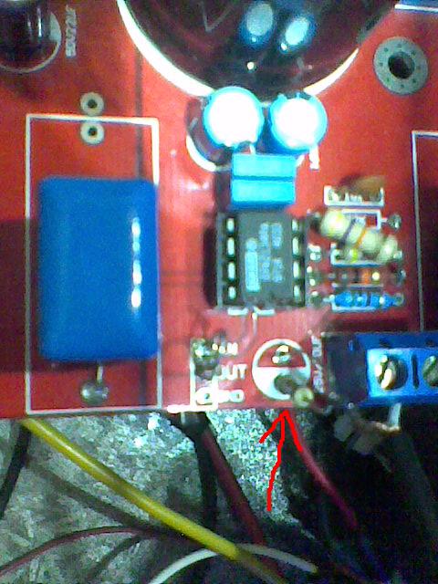

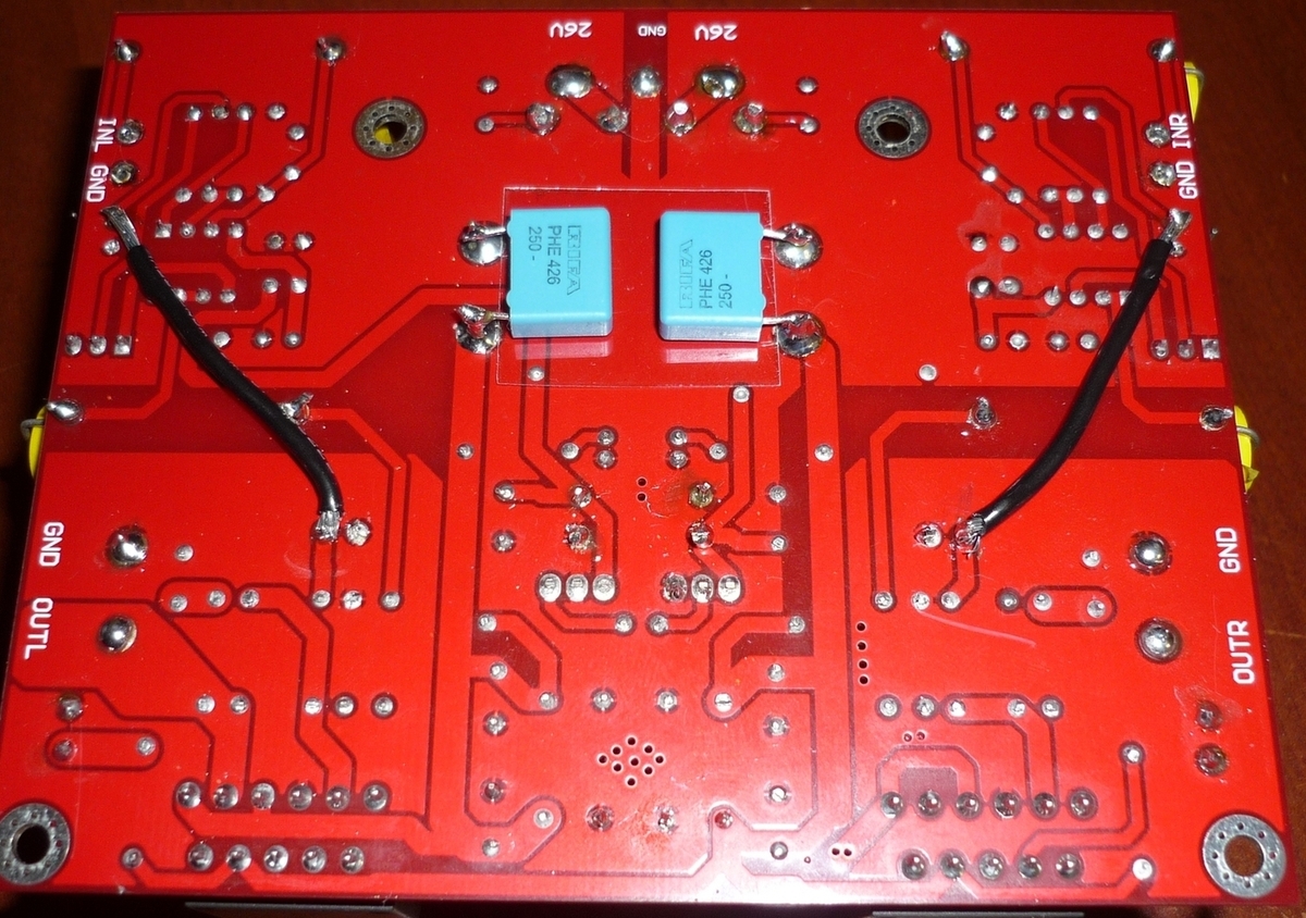

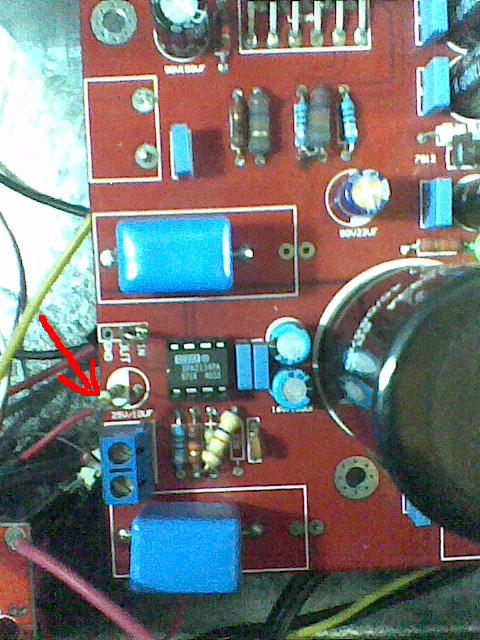

Hi, now I see that your board is different from mine, I have jim's audio board. There is some difference in components rotation, but it's very similar.
Your wires seems to be correct, in the plus side of the capacitors.
But, your 10ohm 1W resistors are in wrong position, it must be reverted, the exposed wire should be in plus side of the place where were the capacitor, which is the place you will solder the IN GND wire.
See the pictures. (sorry for the bad vga quality)

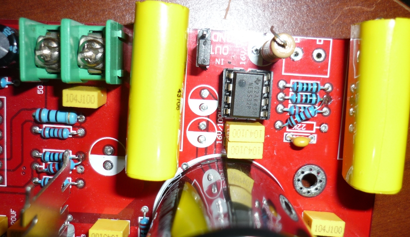

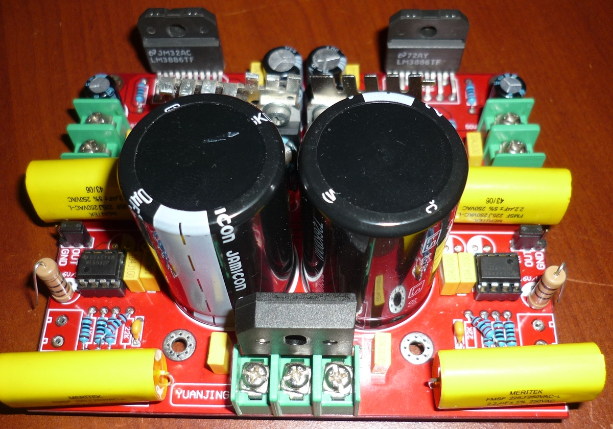

The plan is to power my 10-drivers OB using multi-channel gainclone. Was ready to build the usual point-to-point 3875 until I spotted this on EBay.
Price is amazing, which comes to about A$12/channel (!). Very tidy. What I am not sure though is the additional op-amp which I believe can be easily bypassed. The other thing, I haven't heard 3888 compared to 3875. I have lived with my 3875 and never had the need to tweak or lust any other amp since day-1.
Any advise?

I suggest you replace the above filter capacitor. Because they are fake.
Genuine skin capacitance is different.
In China, no one to buy yuanjing products because they use a lot of old, and fake parts.

To start with the 5532 couldn't be replacing an LM318, because the 5532 is a dual chip and the 318 is single.
So that might be the case for a "weird" MyRefC if they were using both sides of the 5532 to feed both channels. But no, they are using two 5532 on the eBay kit.
Second the number of parts is much less than in a MyRefC. I have one, from the old Penasa layout, and it has much more parts than this kit seems to have.
Without seeing the Yuanjing schematic I can only guess what the 5532 is doing, like being a buffer and line amp, or a line amp and a DC servo for the whole amp.

The NE5532(s) on the Yuanjing gainclone are simple voltage gain and buffer stages, and are not nested around the LM3886, unlike the MyRef. Apart from that, the Yuanjing has various layout and grounding issues that make it fairly rough-sounding. You can use it as an inexpensive HT component, but not for any serious audiophile 2-channel application.
The MyRef Rev C (and later variants like the Rev E/FE) are way superior to the Yuanjing in imaging, soundstage, definition, micro-detail and distortion. If you're interested, PM me for details on bare MyRef PCBs and kits that I offer.
