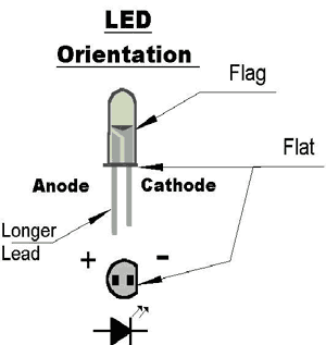

LED's - I really hate the fact that I have to ask questions about LED's but ... Yesterday I was assembling my blank YJ board from Jim's Audio. At the time, I wasn't sure which way to install the LED's so I tested one by touching the leads to a 9V battery. The 1st way did nothing. The 2nd way, the LED lit up but it quickly started to produce a burning smell and now does not work. This LED is what I was using. Is this LED not appropriate? If a 9V battery burnt it out, am I in trouble if I put it in the gainclone's power supply?

LEDs are diodes.
They block current in one direction, but not very well and will fail if reverse voltage specification is exceeded.
They pass current in the forward direction. And will keep passing current until they blow up, unless you the designer does something to prevent them blowing up.
The easy way is a resistor current limiter.
A 9V battery (or 6V or 12V) and a 1k5 resistor will allow you to safely test the orientation of most ordinary LEDs. Some do not have the flat side, indicating -ve.

Thanks to you bcmbob too.

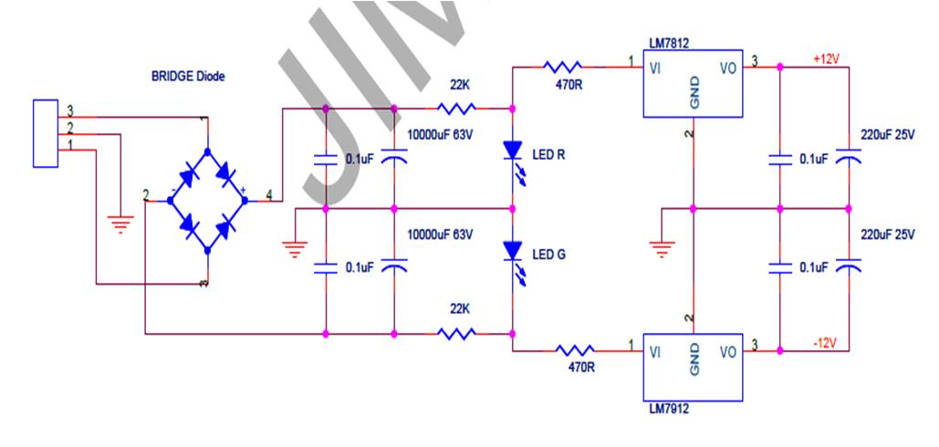

Another question - does anyone know if the 22K resistors in the power supply just after the smoothing capacitors can be changed to 27K or is it a good idea to stick with the 22K? I'm asking because when I placed my order I ordered lots of 27K but zero 22K.
Are the 22k or 27k to discharge the smoothing caps after power off?

They are after the smoothing caps but before the LED's - could they be current limiters for the LED's? Which now is making me want to ask - what are the LED's for? I'll post a pic from the schematic tonight.
Are the LEDs in series with the resistors?
i.e. must the current that flows through the resistor also flow through the LED and have no alternative route to follow?
After going through the 22K resistor, the current can either 1) go through the LED's and then to ground or 2) go through another 470 ohm resistor and then to the regulator's.
FWIW, there are two LED's - a green & red - and they are mounted directly to the PCB. The red is on the negative rail and the green is on the positive rail... oohhhhh... I guess the LED's are maybe just indicators letting you know there is power on each rail? Nonetheless, my question about the 22K resistor stands.

22k is very high for a voltage dropper to feed regulator and LED?
Can you post the schematic so we can determine the purpose of that 22k and it's expected dissipation?
