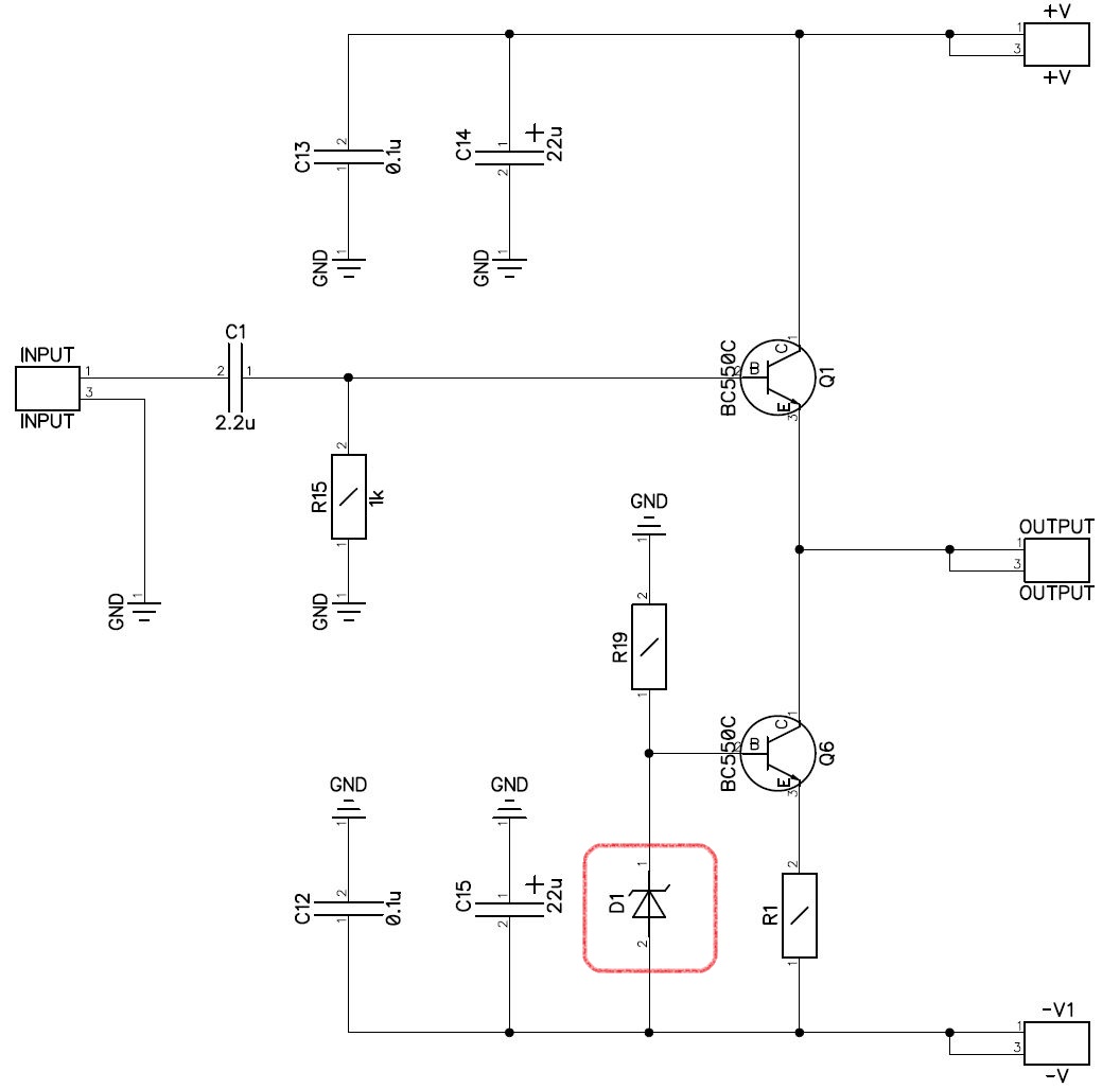

This point actually grabbed my interest. I disagree with the statement that zeners and LEDs "mask" the signal because of the noise increase, so I will run a series of tests with regards to this.
I've got a pro-grade microphone amplifier (Behringer MIC200, s/n >120 db, 26-60 db adjustable gain). Attached schematic will be connected to its input and then I measure the noise floor, having zener, LED, diode, resistor, battery, etc. at the place of D1, adjusting the CCS quiescent current to, let say, 2 mA for each setup, without touching the gain. Test circuit will be powered from the regulated PSU +/- 24V DC.
What do you think? Will it make sense?
Valery
P.S. I can also sent the same signal to the input and publish the output spectrum for each option... would be fun to see if there is some difference visible ;)
