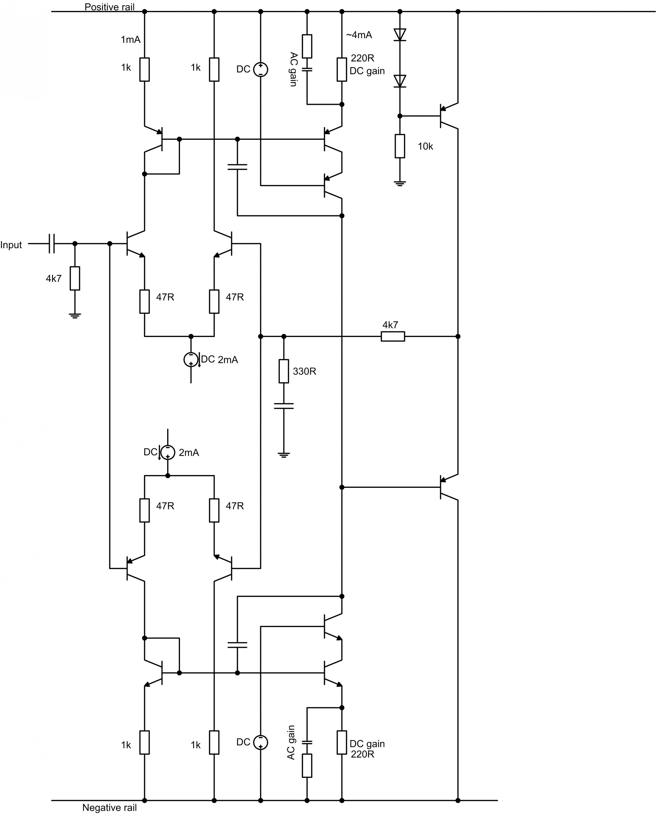

Bypassing R9 & R12 with only capacitors might impair the stability, but Jens proposed to use RC networks. This also makes it a different case.
Cheers, E.
The point of the R in the RC network i to ensure that the re of the transistor is not the only AC gain limiting part of the circuit.
I have simulated and build this configuration and it seems to work very well with no stability issues at all.
I have used it with a mosfet output stage with a current limited buffer between to ensure that protection does not overload the TIS/VAS stage and ensure more linear TIS loading.
Using the RC network, some sort of currentlimiter is a must, as the TIS is capable of delivering quite high peak currents.

I can't understand what you are saying here at all. How about a full schematic?
I'm working on getting a simulation together so notes can be compared - so far the circuit proposed performs better than circuit shown in figure 8.18 editions 6.
Well,it's up to you of course, but my conclusion in Chapter 8 is that these sort of circuits positively bristle with problems.
I have not been able to simulate the circuit in figure 8.21 where current mirrors are deployed to improve input diff amp. BIAS point is failing.
This circuit has well-known problems with indeterminate circuit conditions. Remarkably, when I built it, it worked. (APAD6 p225) I hasten to add I do not claim this is repeatable.
Attached is the schematics I used in my simulation
I should be noted that I modified figure 8.18 with gain to match my circuit - to make a fair evaluation 🙂

Hi to all, didn't mean to tease you, just wanted to show it to Edmond first, to see if it's already known and then decide what to do.
Show it here, in Jan's Linear Audio or try to exploit it.
Not normally this reluctant to show a circuit but the clever CMCL implementation is a friend's idea and it simulates so nicely.
20 kHz distortion in the low PPM at full power, Slew rates of >200 V/us, noise around 1 nV/rtHz.
All so much better than needed that it would not be worth the trouble to complicate the circuit just to hit the numbers.
But they come naturally from a fairly simple circuit, combined with advanced compensation and a few twists.
Feedback stability looks fine and so does VAS current in the face of component tolerances and thermal effects.
But it's "only a simulation", as someone is sure to say, so I will build it first.
More soon!

When you close the TPC compensation loop there is not a pole at the origin and one at 1-10 kHz, there are two poles at 1-10 kHz - and typically a peak. This is already equivalent to the "split" pole miller case.
Once you close the outer loop then any peak in the closed loop response is determined by the behaviour at and above the Global ULGF. This is unrelated to the 1-10 kHz behaviour.
The TMC case is similar but there is not the extra shunt load on the VAS/TIS that TPC imposes. That shunt load is (mostly) bootstrapped away by the OPS. I suspect that matters more than some people realize.
