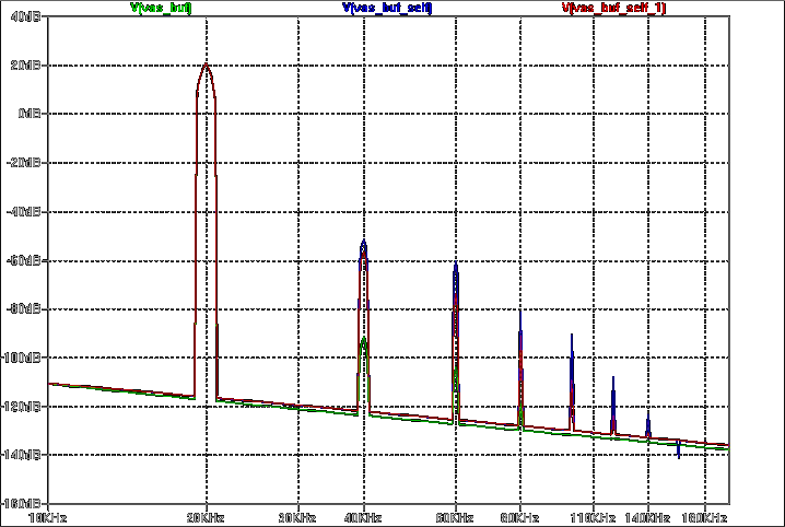

I'm working on getting a simulation together so notes can be compared - so far the circuit proposed performs better than circuit shown in figure 8.18 editions 6.
I have not been able to simulate the circuit in figure 8.21 where current mirrors are deployed to improve input diff amp. BIAS point is failing.
Plot shows:
Green: "Alternative circuit"
Blue: Figure 8.18 circuit - other multi pole compensation
Red: Figure 8.18 circuit with alternative output stage - other multi pole compensation
All circuits have the same compensation network.
If I use Cdom=100p in all 3 circuits, the pattern is the same.... alternative circuit is still better.

Hi Jens,
So you are tying to improve fig. 8.18, because the original circuit lacks some gain. Fig. 8.21 provides more gain, but together with a CMCL, it will cost you about 10 extra trannies. For this reason I also tried to increase the gain by decoupling the emitter resistors of the TIS, just as you did in post #576. However, under overload conditions, the TIS standing current (bias) will shift away from its nominal value. I don't like this and you probably as well. To overcome these issues, you'll need a radically different approach: Just add some gain by means of a complementary emitter folower (only two trannies) behind the TIS (for an example, see the SuperTIS).

(I think) I have overload conditions under control by using a current limited buffer.
I will have to try the CMCL circuit to see what it can give.... transistors are almost free these days... and I don't have to mount them 🙂

The SuperTIS is better and simpler than fig. 8.21 + CMCL.
Cheers. E.
Better is many things.... In my application I don't want lot's of 5mA current sources....everything must be optimized for performance at low idle currents 🙂
I aim for a design running at ±60, while idle losses are minimized Capable of 150W into 8 ohms....
At ±30V I want less than 2W idle power.
Best regards
Jens

Hi David,
I've read Cherry's article already. Thanks anyhow.
Regarding bypassing the TIS emitter resistors (R9 & R12) in fig. 8.18, I think it's a different case. This TIS has a rather low current gain: about 28x (because of the resistive loading of the IPS by R1 & R3), while Cherry's circuits uses a current mirror. Bypassing R9 & R12 with only capacitors might impair the stability, but Jens proposed to use RC networks. This also makes it a different case.
