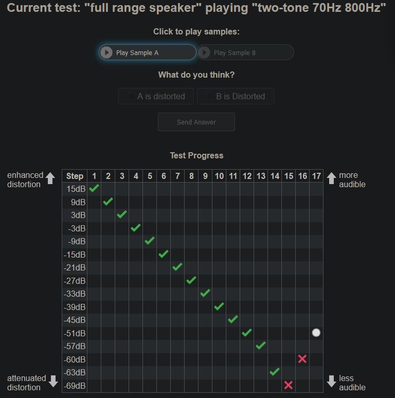

I got to -48dB listening through my speakers (Klippel recommended headphones I believe) which I think is equivalent to 0.5%THD which is the distortion figure published for the Tannoy Little Reds I was using.
Funny I did the listen test at the klippel site both for high frequency hearing and distortion. I was very familiar with the song and my 10 year old had never heard it so I figured i had an advantage but I did very poorly apparently, I don't hear distortion until it's up to about 30db below the fundamental. Up until then I thought I had good hearing. My kid could easily hear it down below 50db down.

I think in a test like the Klippel THD one (blind, forced choice) it is not particularly helpful if you know the song and if you know the song well it is best if it is one you do not particularly like or dislike. But that's just me...that was my point. my 10 year old had no training and no experience with the song and i thought that would equalize the two of us, it did not.
I think krivium has the answer. There is a pretty strong training factor here, apparently. My not-so-young ears (66) on third try managed to get to -69 dB before I couldn't easily hear the difference. I think with one more try, I might be able to go full-scale.Are yo sure you listened to the right thing within the song?

The "fatigue factor" is pretty strong. I took a break in the middle of the test. SPL is important, too. I probably had the volume turned up to 80-85 dB to hear the very slight differences. Then it was pretty easy to hear each time, until -63 dB (in my room).I would not give too much weight on whatever happened on such tests: there is a lot of factor which can affect your mood, capacity of focus, etc,etc,...
Assigning blame to the loudspeakers as to why one couldn't hear any deeper into the signal is problematic. I do think that hearing the direct arrivals and not nearfield reflections is pretty important, as well as having low phase growth in the loudspeakers--so that the "spikes" in the resultant waveforms are not reduced in amplitude relative to the other main frequencies.
I found even turning my head just a few degrees has a very strong effect on my ability to hear the differences. Once I found an optimum angle, it was pretty easy to hear. YMMV.
