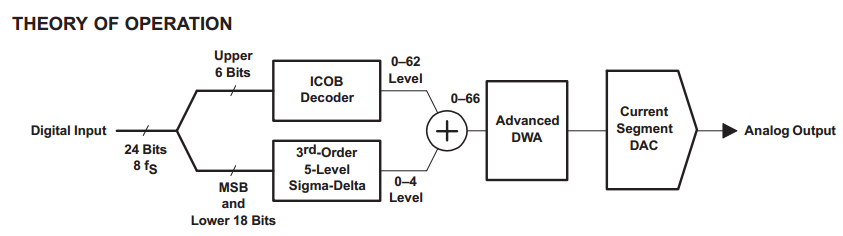

CS4398 has a multi bit modulator, PCM 19794 data sheet don't give any info.
Are these S-D type DACs?

Perhaps your datasheet reading skills are slipping after being complimented on them 😀 This comes from the PCM1794 datasheet, page 24. Yes both are S-D type.
Yes CS4398 is SD type and a good one too. Before I started working with other DACs I had a CS4397 DAC I enjoyed a lot. Strange thing is the CS4397 datasheet mentions DEM (Dynamic Element Matching). Both CS4397 and CS4398 sound very good with transformers at the output so completely passive sym-asym conversion.
