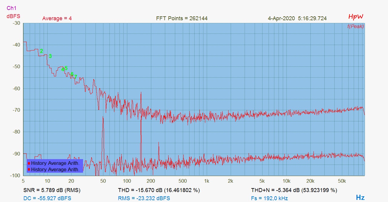

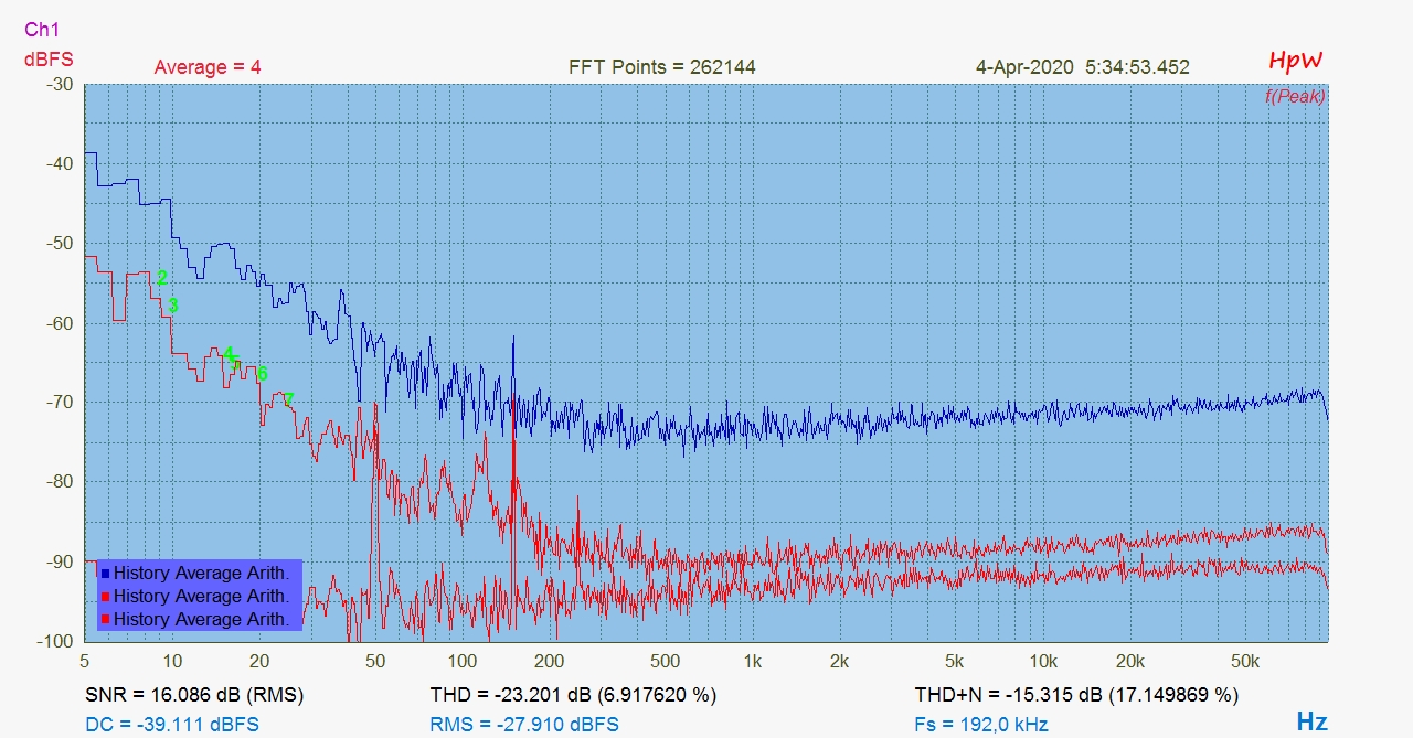

See below the relative noise density measurement between TPS7A4700, configured to 4,2V dc out, and a 'reference 60ohm' input impedance.
measurement tool: Gerhard's pre, (cca 220pV/sqrtHz) >>RTX6001 >> HpWorks
the 60ohm ref line is, equivalent to 1nV/SqrtHz noise spectral density
As a consequence, the TPSA74700 output noise spectral density comes 20dB higher, 10nV/SqrtHz.
here there are all compared together: highest trace is TPS7A4700 (10nV/sqrtHz)
below LT3042, 4V dc out, 100mA load current, 10uF reference bypass cap (2nV/sqrtHz)
lowest trace is the 60ohm, 1nV/sqrtHz baseline reference

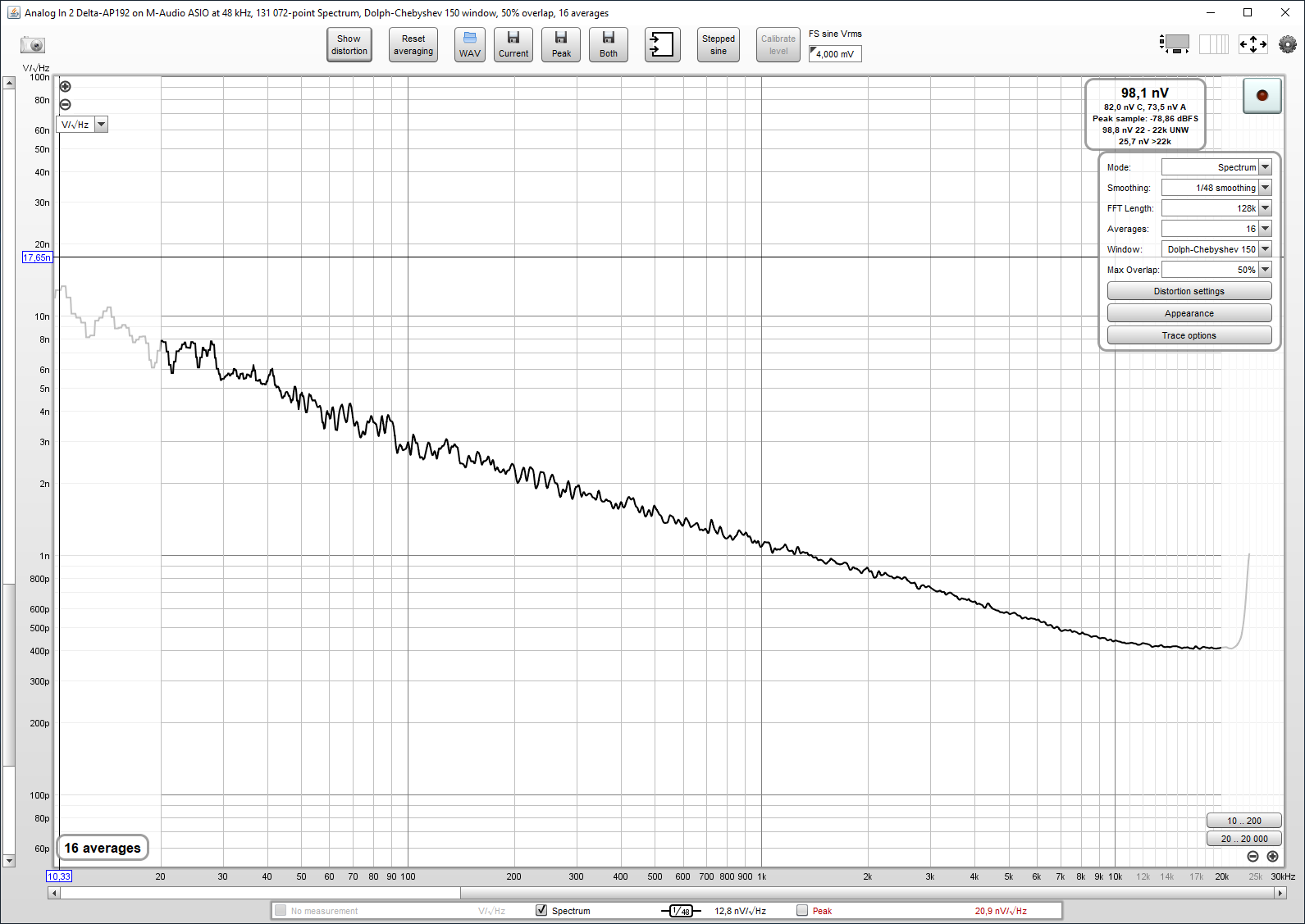

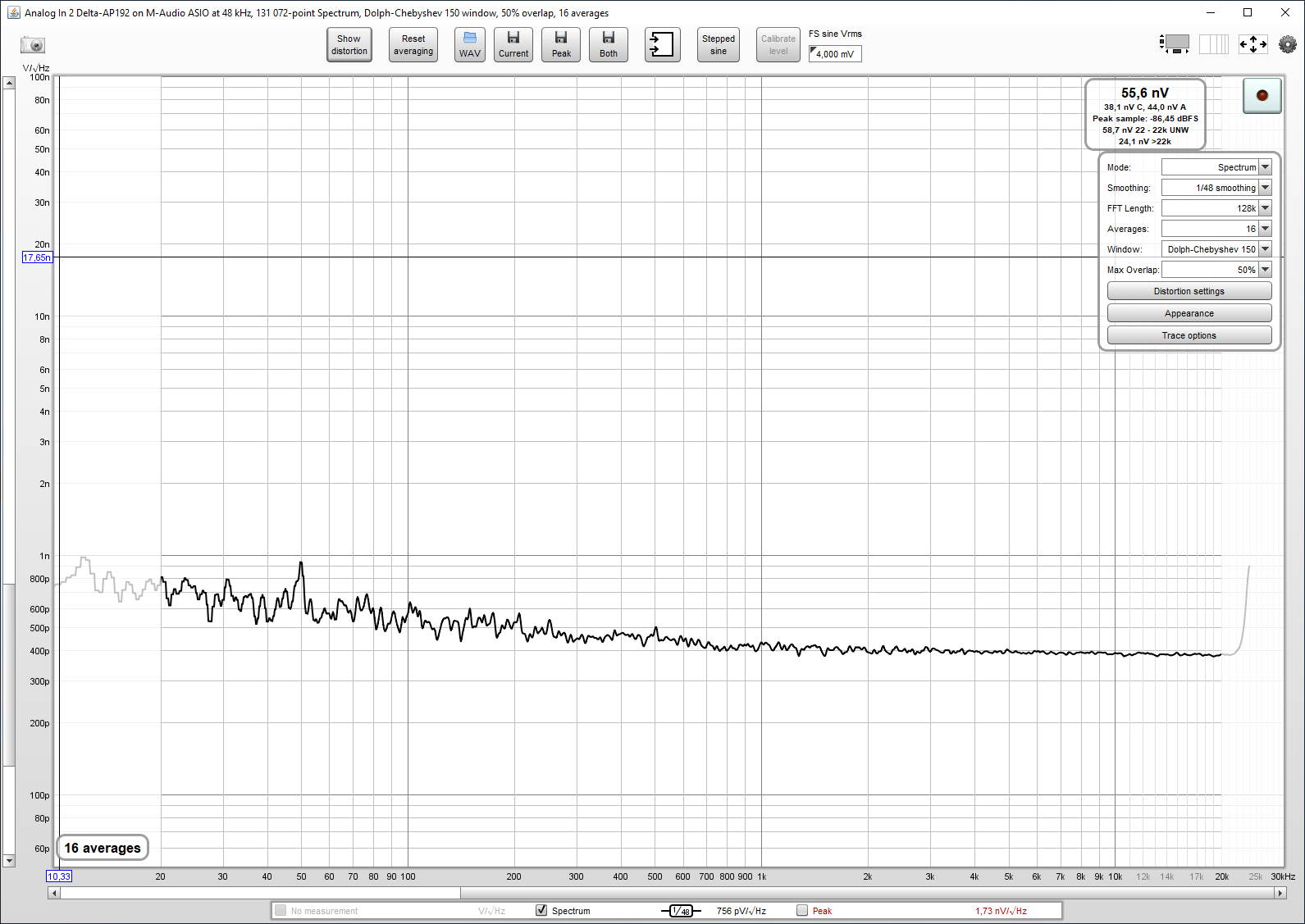

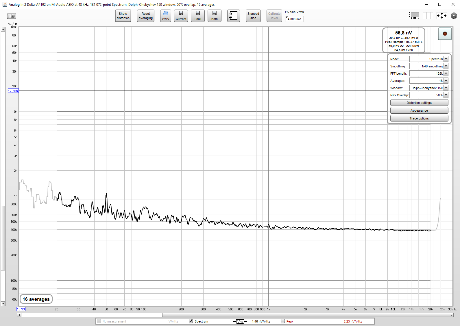

You are correct. It is also important to choose the right tool for the job. To illustrate here are 3 measurements of the self noise (i.e. input shorted) of my 60dB LNA. The LNA is my take on Samuel Groner's LNA using 4 unmatched 2sk369 fets scavenged from an old scrapped Pioneer A443 amp.
1. LNA powered with SilentSwitcher + battery pack
2. LNA powered with my LT30xx switcher + battery pack
3. LNA powered with my LT30xx switcher + USB from the same workstation 😱. Just look at those nasty spikes 😀
To be fair LNA is not the optimum usage of SilentSwitcher. It is excellent e.g. with Jan's Autoranger.
