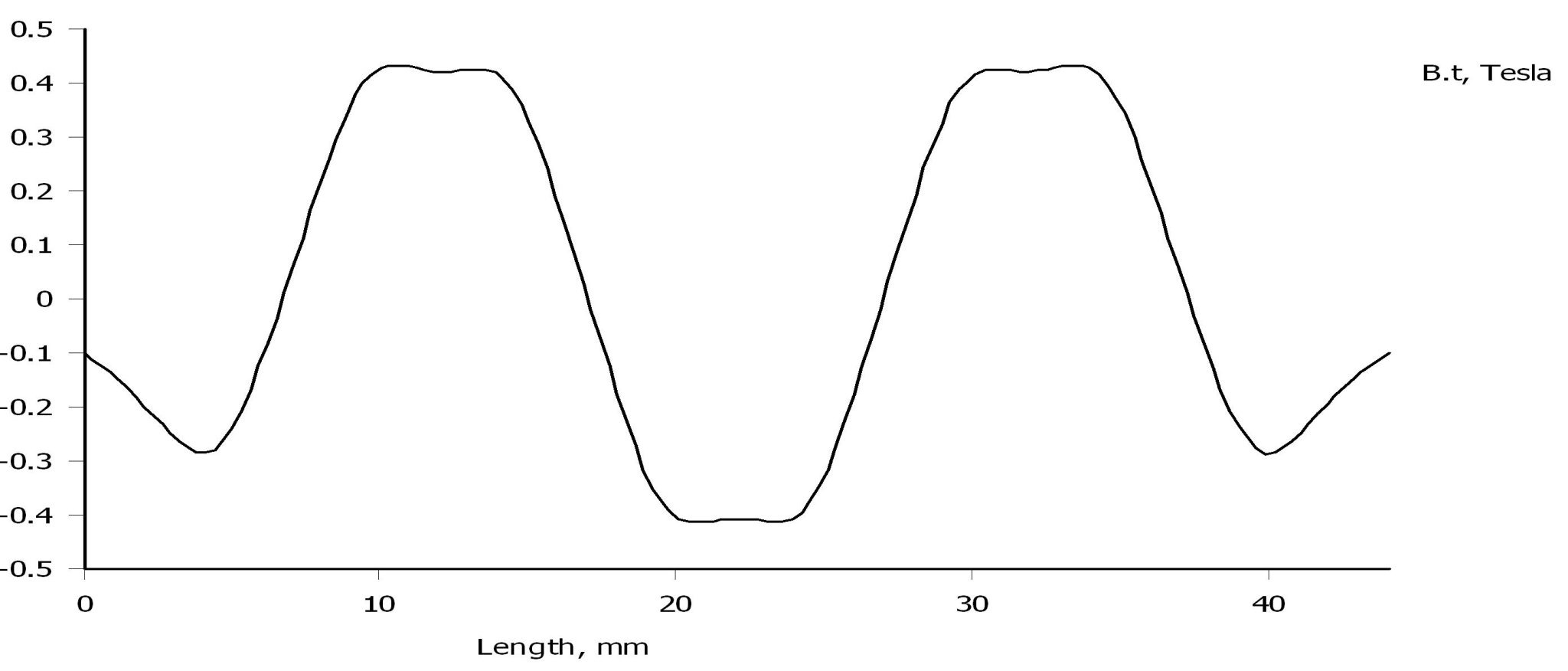

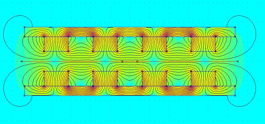

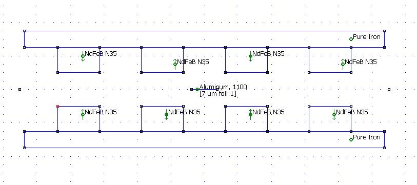

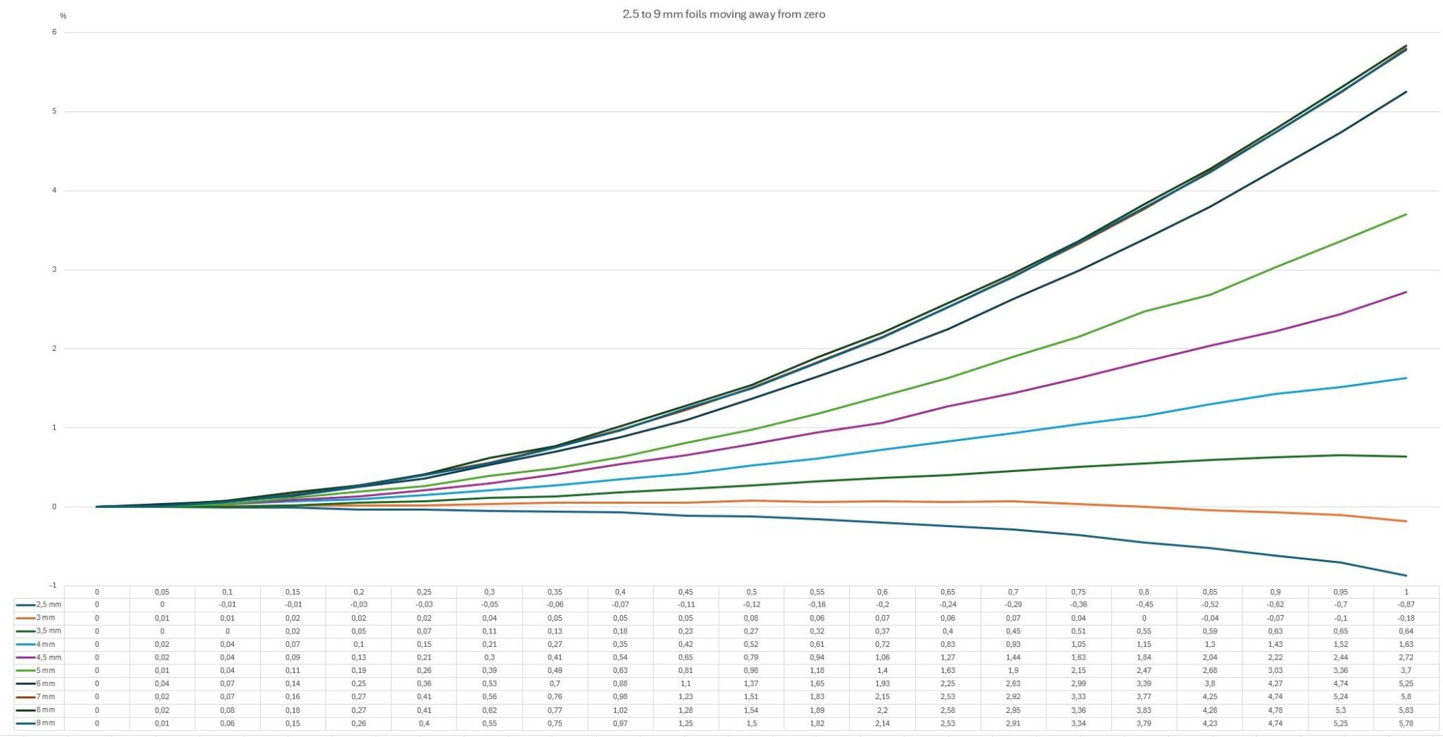

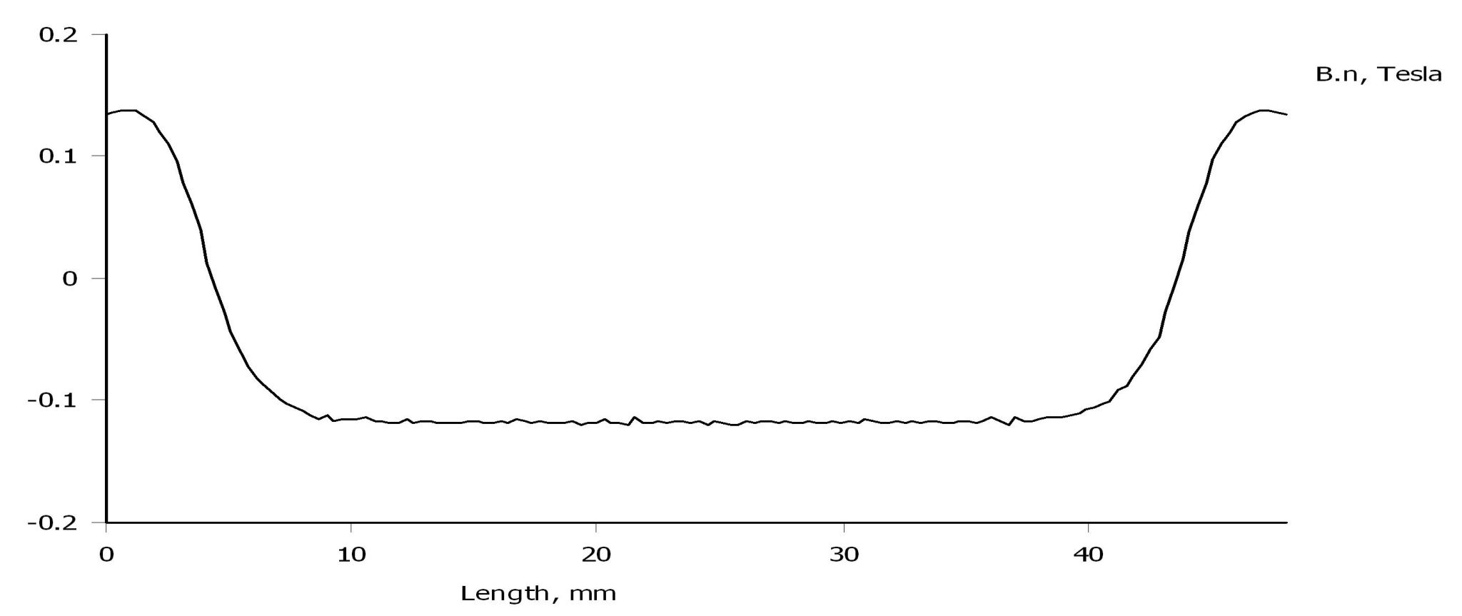

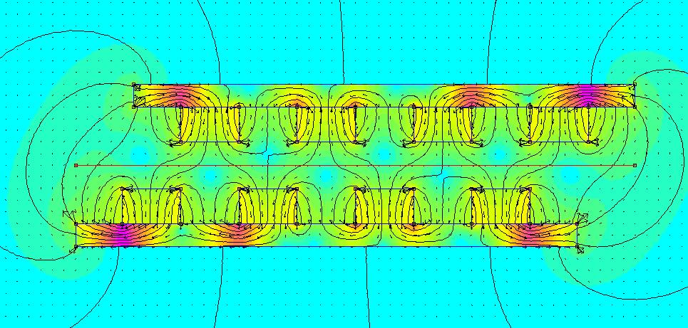

So here's the chart over the force on a aluminium foil conduit in a magnetic flux density produced in a push pull configuration when it moves from rest level to 1 mm above rest level:
Enlarge it or open the picture in another tab to view it better.
So if only the deviation in percent from the rest level manifests in distortion, there's a clear winner.

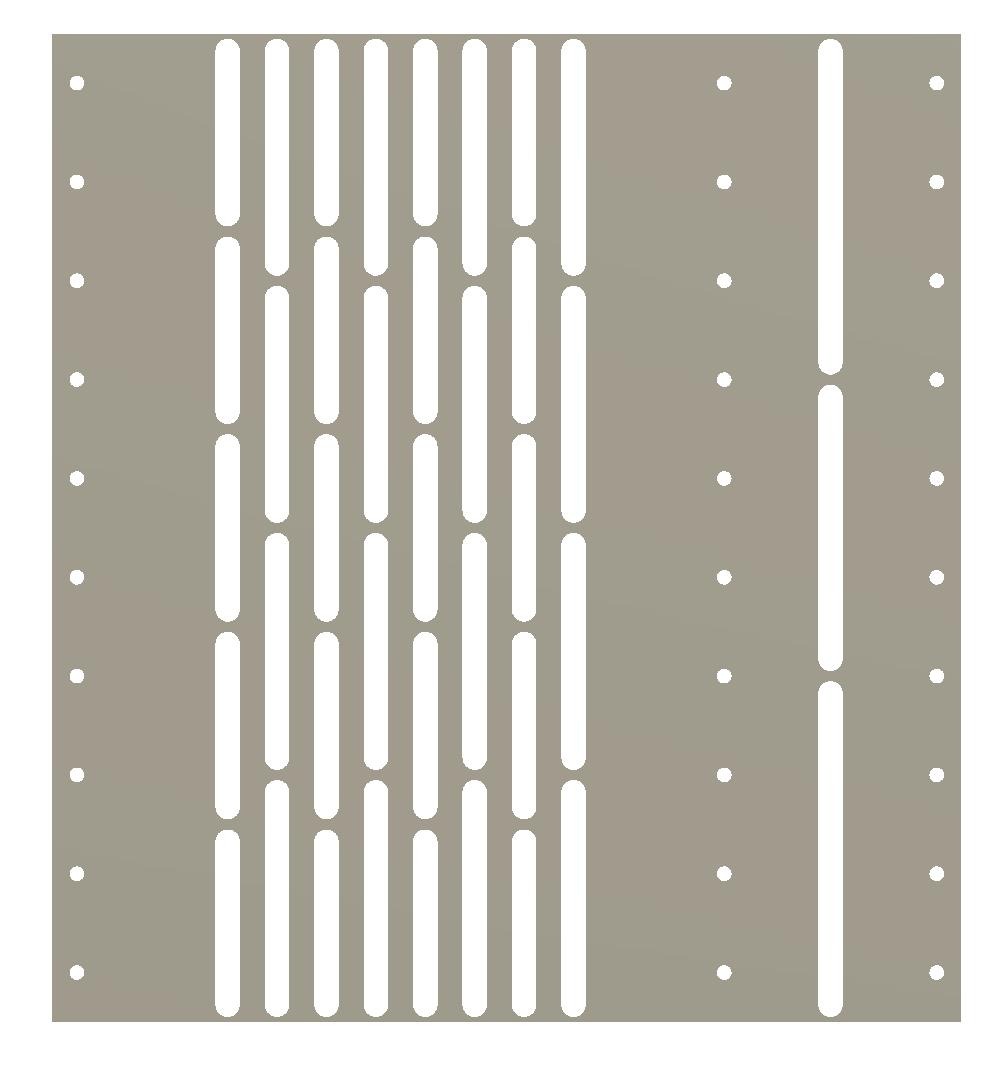

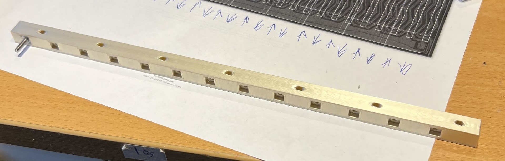

Here's one of 44 steel plates, 184 mm wide and 200 mm high.
22 magnets, 10x5x3 mm, will be mounted on each steel plate.
A nut bar will hold front and back plates together in three places:
En mutterlist skall hålla samman fram- respektive bakplåt på tre ställen:
A front plate is fastened with a long screw in the nut in te bar. On the protruding rest of the screw, the back plate will be fastened with yet another nut.
Look at the vertical screw holes in the plate above.
The back plate must be wiggled in place.
I will probably not use all screw holes.
The nut bar has also screw holes for supporting side beam.
Here's an attempt to visualize it:

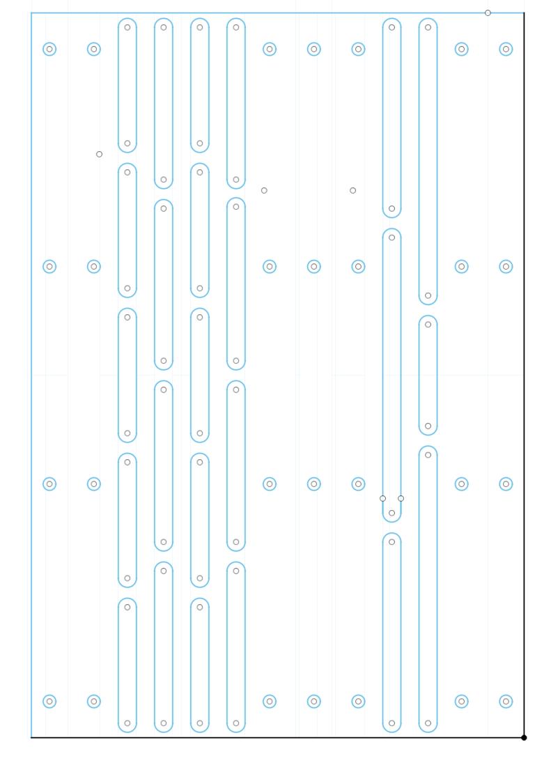

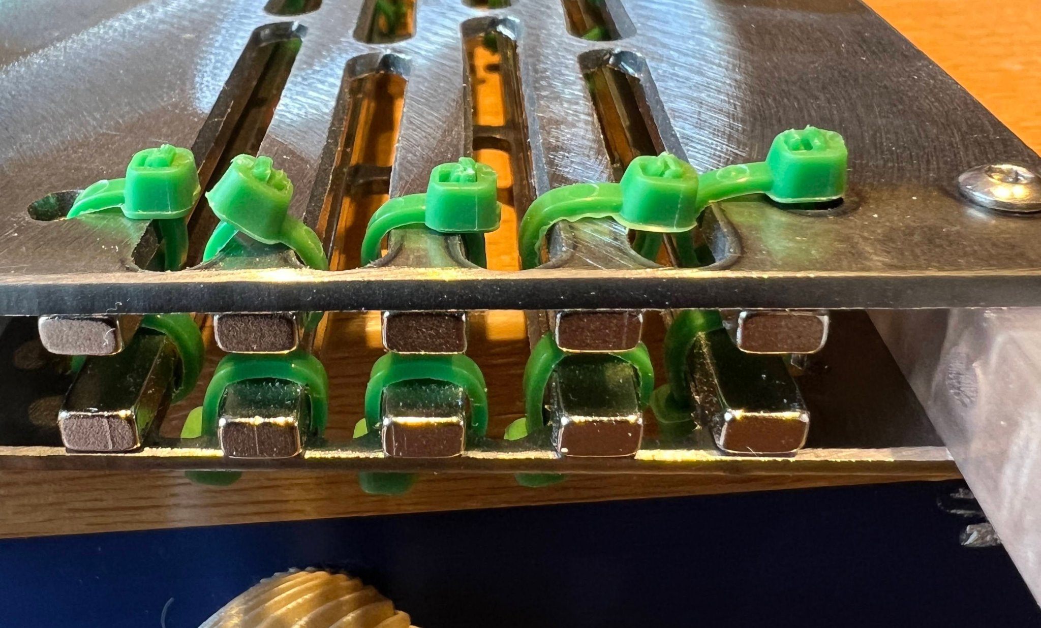

Well, that didn't go well. The plates bulged in the middle of the mid section by almost an millimeter.
New plate design:
Only five columns of magnets for the mid but now three columns of magnets for the tweeter.
I've also increased the amount of steel between the elongated holes.
The extra holes at the side of each outmost column of magnets are just to be able to temporarily fasten the magnets with zip ties:
So, did the changes help?
Yes, I think so. The largest bulge I can measure is 14.20 mm, that's 0.20 mm from the nominal 14 mm.
What do you think, should I iterate the design further?

Yes, this will be the final solution.

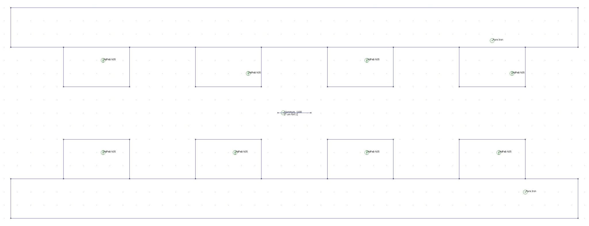

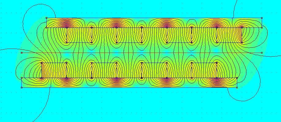

I must be missing something here, the membrane is moving up and down in the picture above?
Eminent:
My layout:
Eminent:
My layout:

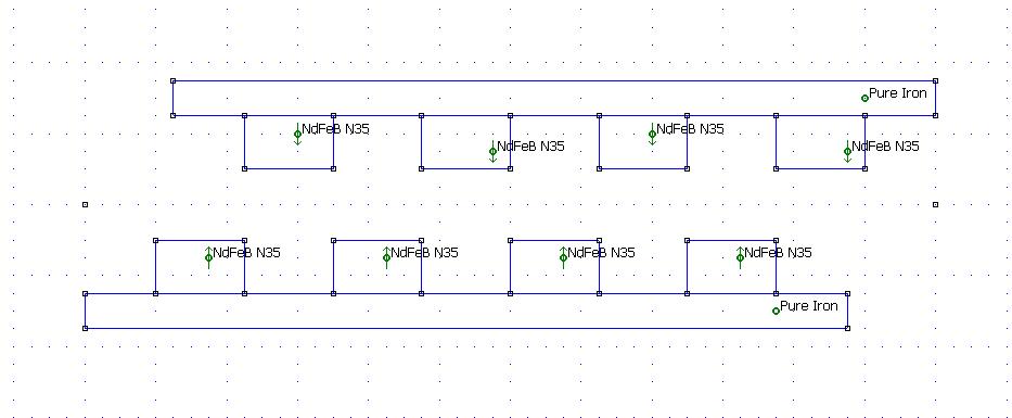

Eminent:
View attachment 1317386View attachment 1317387View attachment 1317388
My layout:

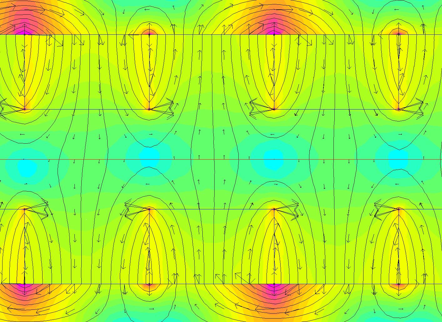

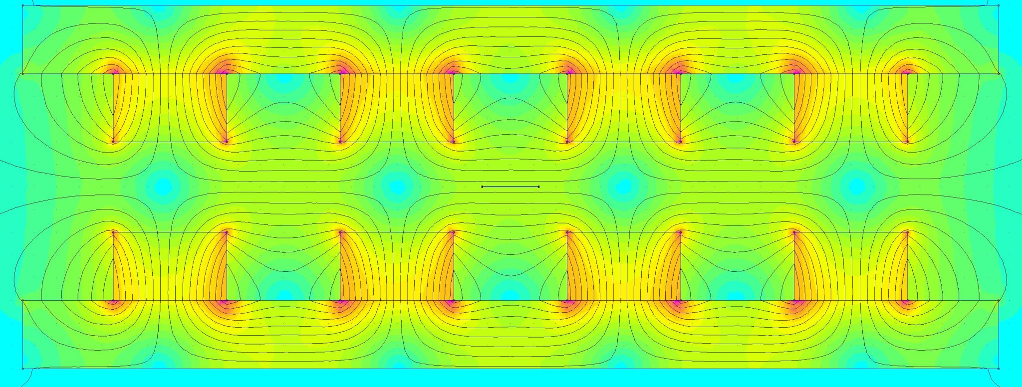

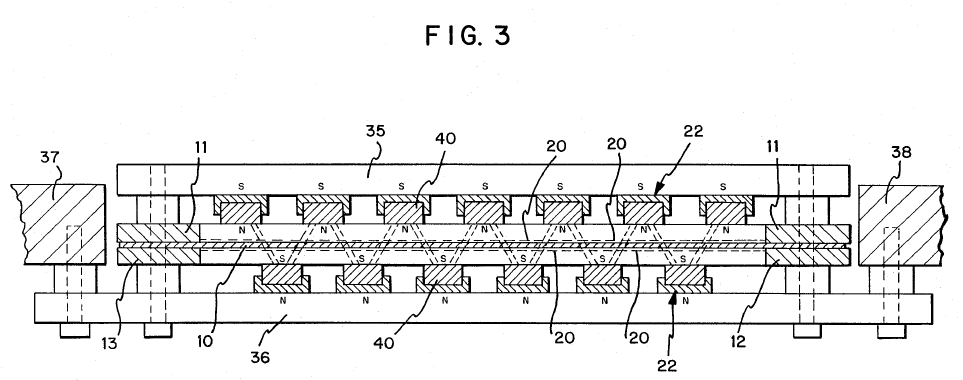

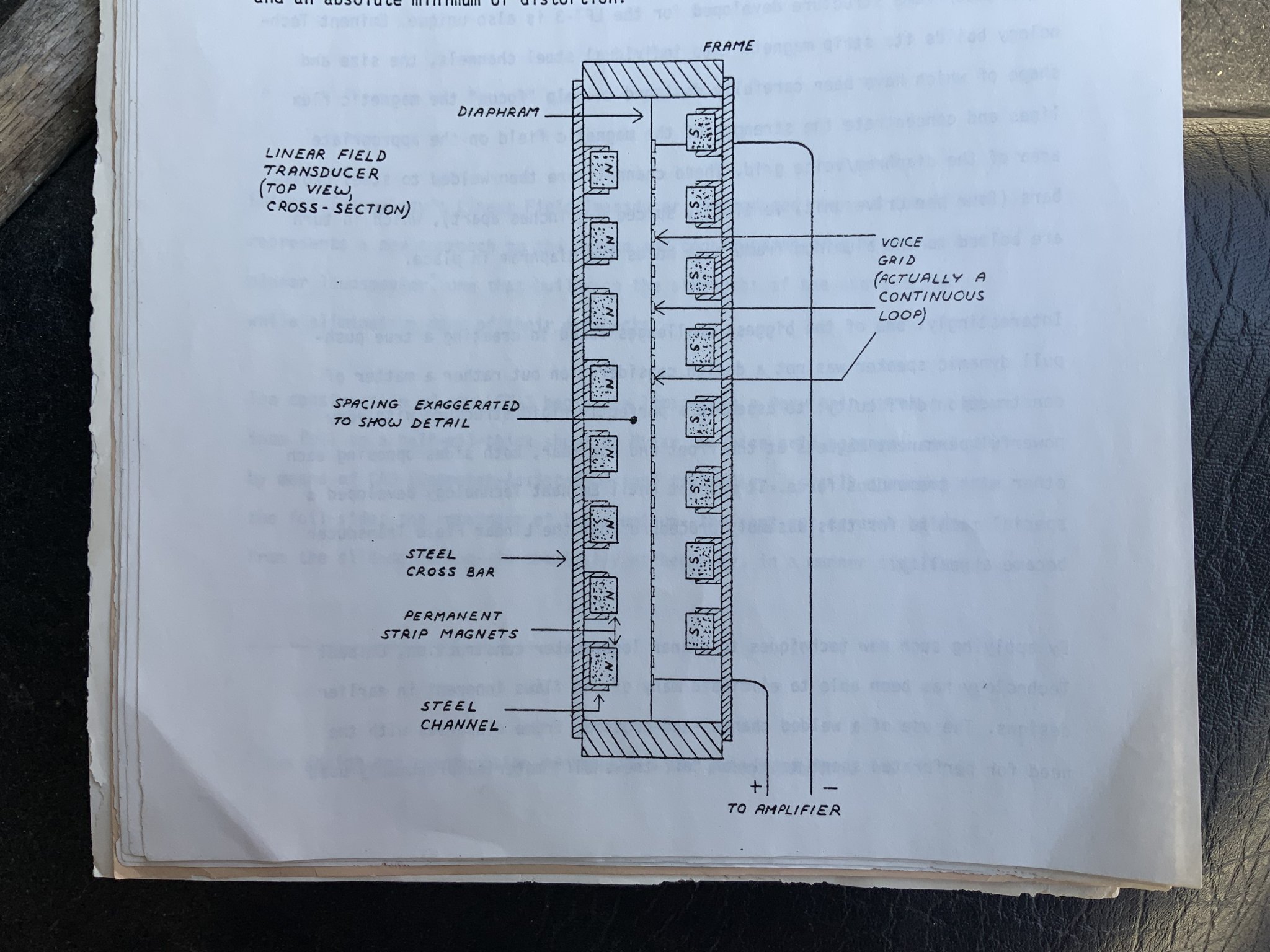

In the ET each magnet is placed down in a welded “U” channel cross frame of steel which gives it strenght from the opposing magnet array
So the magnetic focus line I believe is closer to the moving diaphragm
It was mentioned by them at one time that it wasn’t as efficient as the symmetrical magnet arrangement but preferred it overall and can’t remember their reasoning behind doing it this way
This is from the manual of the ET lft-3
Patent # 4,837,838
Patent # 4,837,838

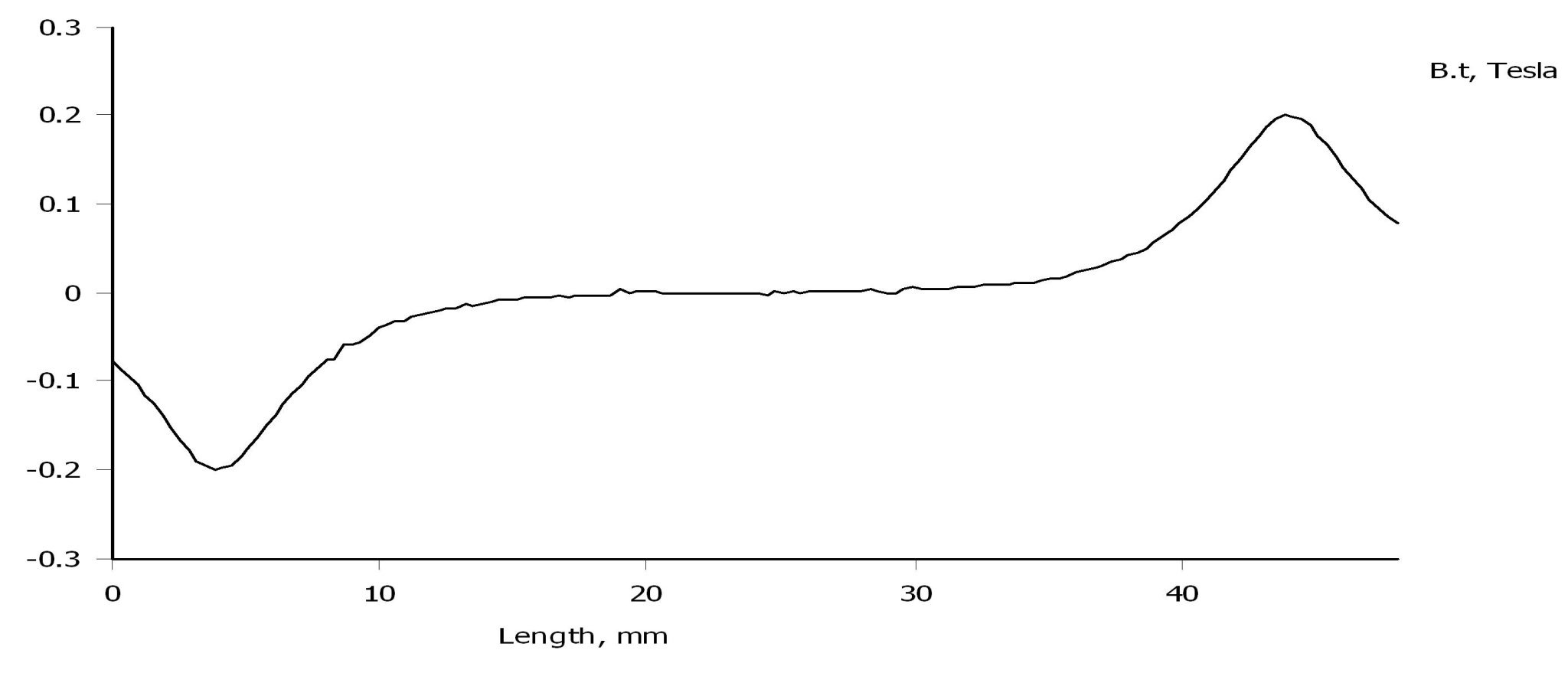

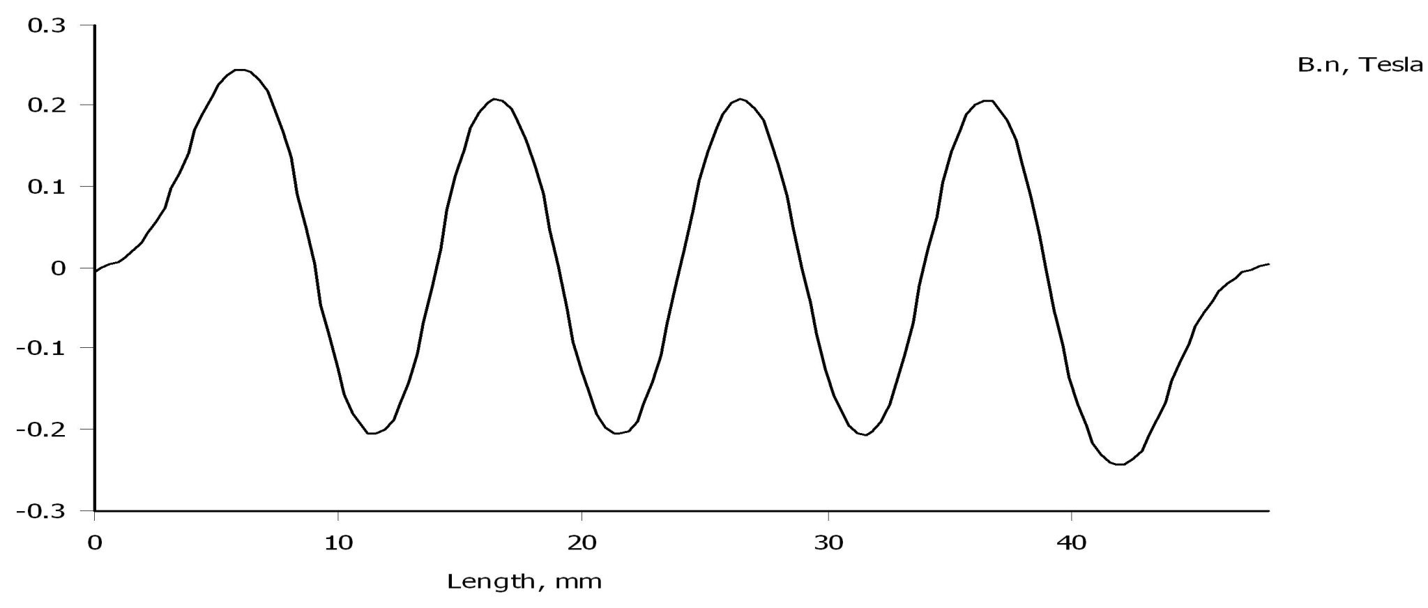

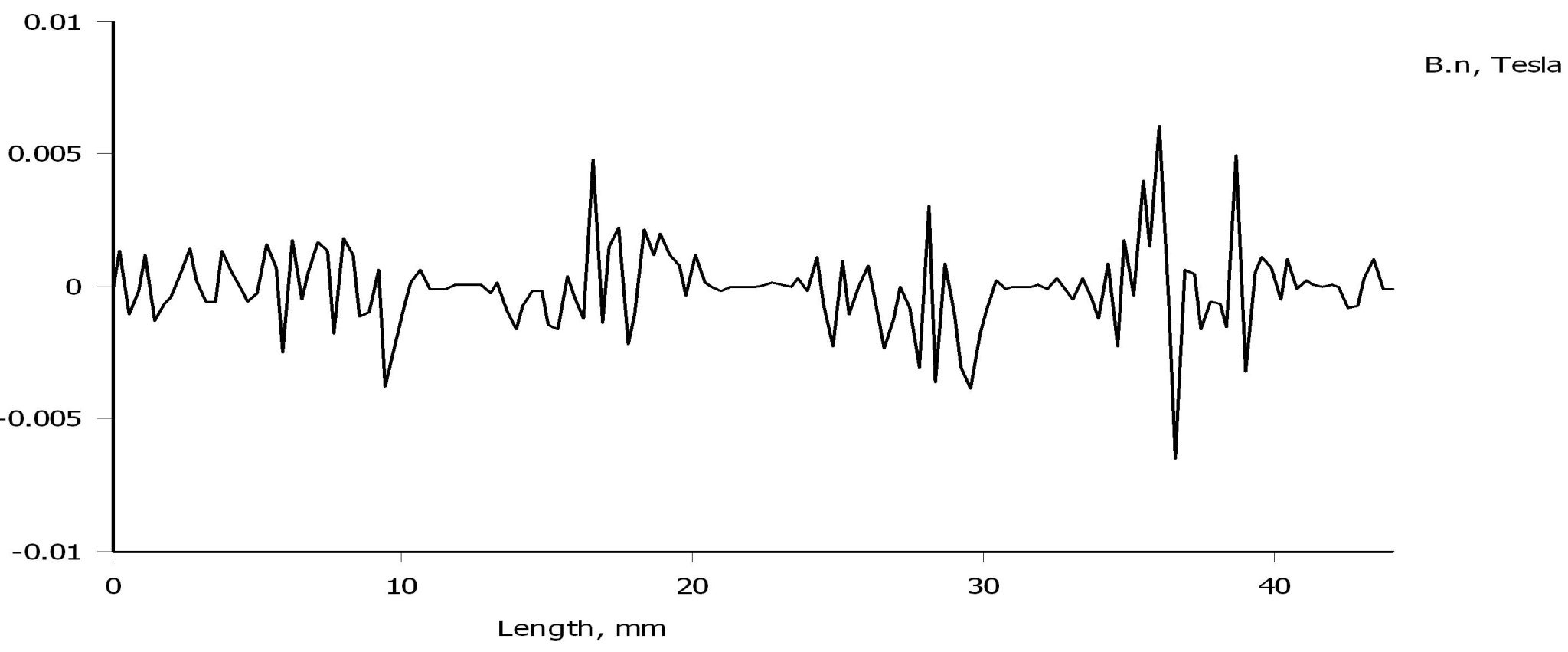

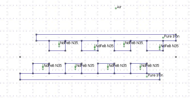

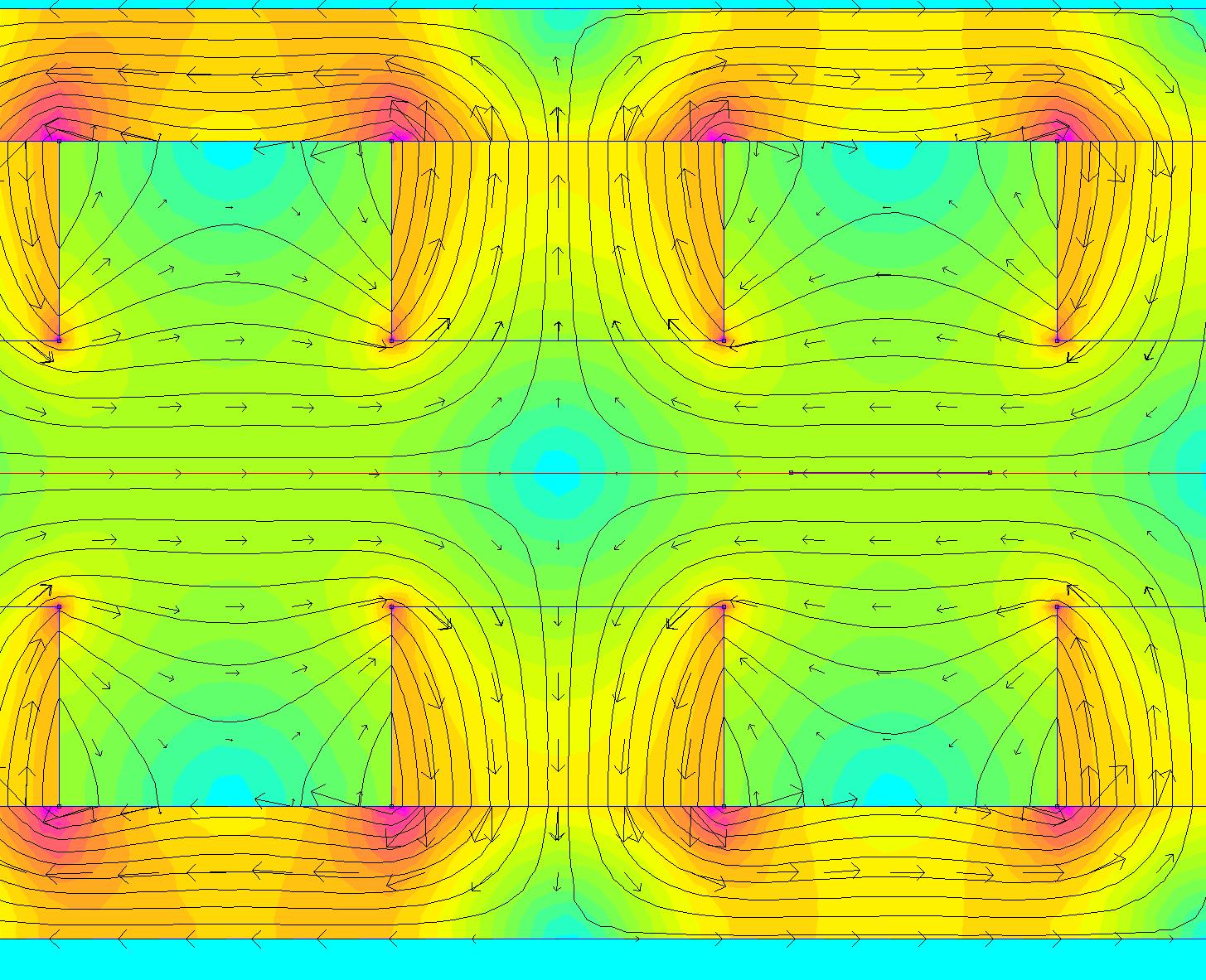

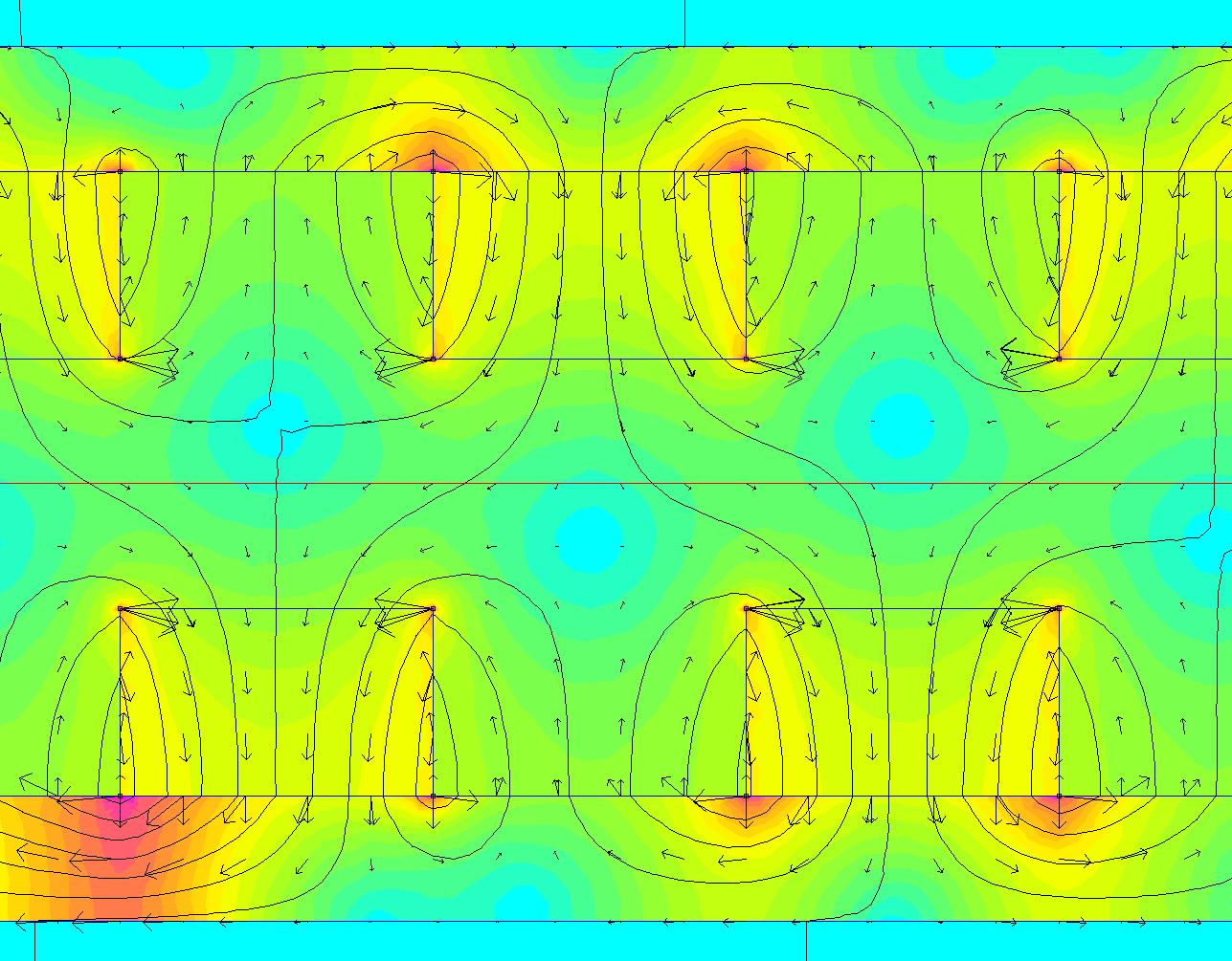

The orientation of the bottom magnets needs to be flipped if you are trying to emulate US Patent 4,837,838.I must be missing something here, the membrane is moving up and down in the picture above?
Eminent:
My recollection is that arrangement is supposed to provide a more uniform field over the whole diaphragm to address the issue of undriven area in typical planars.

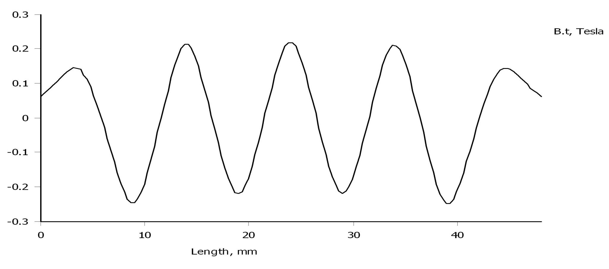

I hope that I got it right this time.
There's a constant force up or down (B,n) and most uneven usable force (B,t).
I still doesn't see the benefit of this configuration.
