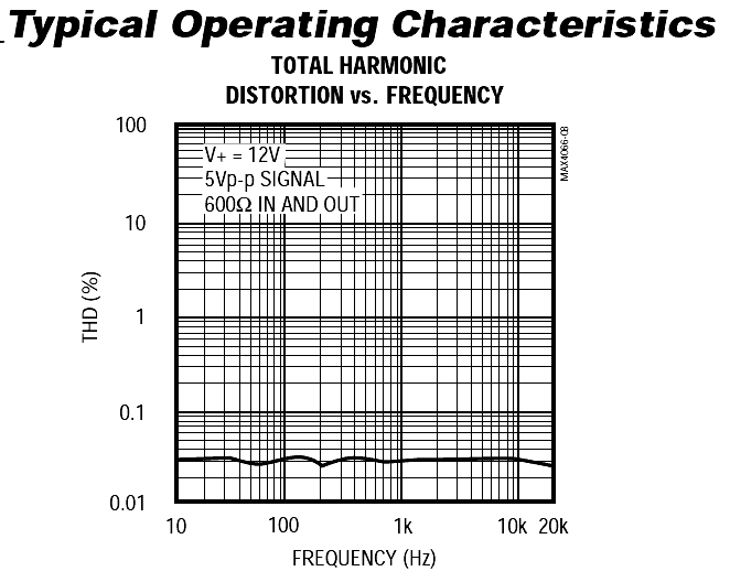

> no relevant information about conditions particularly the load impedance.
In the graphs. Yes, this is "Typical" so you can't count on it.
But 0.03% at 0.42 of supply with 600 Ohm load is not too bad.

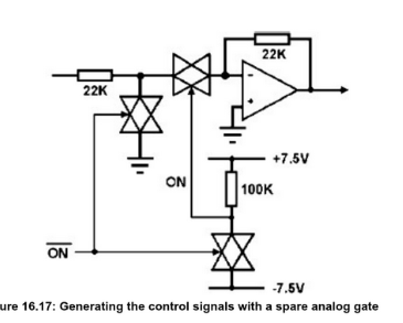

Douglas Self discusses at length the use of MUX in his small signal book. The best implementation thd wise uses one 4066 per channel in conjunction with an inverting opamp. You can get most of the discussion in the preview of the book on google books: Small- Signal Audio Design - Douglas Self - Google Livres (search 4066 and then scroll down to fig 16.17)
It goes like this:
after the input resistor, tie one switch to ground to shunt the signal when unused, put two switches in parallel going to the opamp inverting input and use one switch to invert the control signal.
Since it's freely accessible on google books, I guess it doesn't hurt to copy it here.
Self achieves 0.0016% thd @1khz with a single 4016 gate in serie with the input and 0.0013% with two gates in // in the same position, this with TL072 and at +20dbu.
With better switches (and opamp), you could try to double up the shunt gate rather than the serie one, which would allow to reduce the value of the resistors, improving noise performance without compromising the "offness" and the distortion of the setup.
