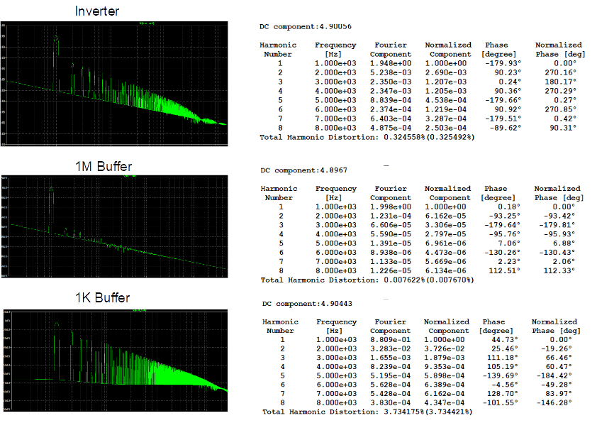

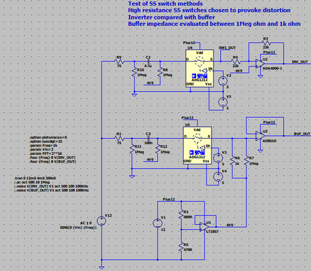

Here is a test in LTspice to illustrate the configurations match expectations.
The sim start time is 4mS. End time 12mS. Timestep 200nS.
The inverter method is compared to the buffer method at 1M ohm and 1K ohm impedance.
The test is setup to exaggerate switch distortion with a SS model that has higher resistance.
One thing that showed up was the type of opamp determines output swing in the buffer version. The inverter method does not have this sensitivity because the input swing is low. The larger input swing of the buffer can cause some inputs to bottom out early at this supply V. The TL072 seemed ok when I ran a check in TINA.
Although the inverter looks a lot worse, in reality with a lower switch resistance, the lower opamp distortion might mean it fares better than the buffer. A noise test shows the buffer is better on this front.

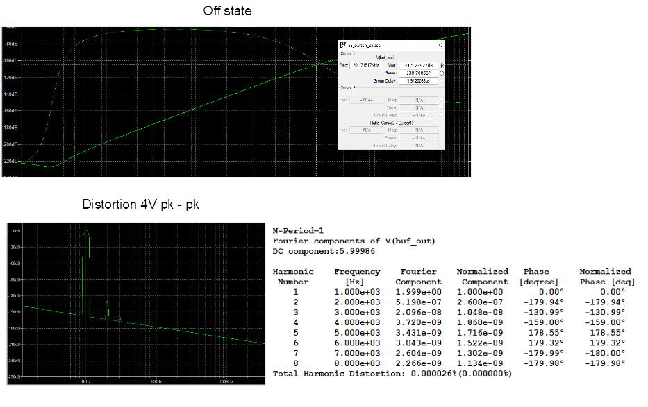

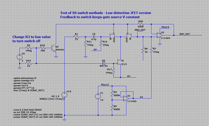

It is worthwhile including a technique that cannot be used with integrated solutions. Here is a discrete FET switch with very low distortion due to feedback from the buffer to maintain a constant gate - source voltage. The inverter method obviously cannot implement this without another inverter.
In a single supply situation it is fairly easy to make the switch logic compatible as shown in the sim file.
It may seem to have a bigger footprint than a 4066 type switch. If a complete switch is used to improve off state using multiple switch sections, then the FET solution looks more attractive. Dual FET SMD packages eg. CPH6904 from On Semi reduce the footprint further. This is a 25V 125 ohm device so can handle a decent swing.
The J113 used for sim should perform like the CPH6904. The off state is -105dB at 20Khz. This will improve when the buffer is driven by another input at lower impedance than 1Meg buffer bias.

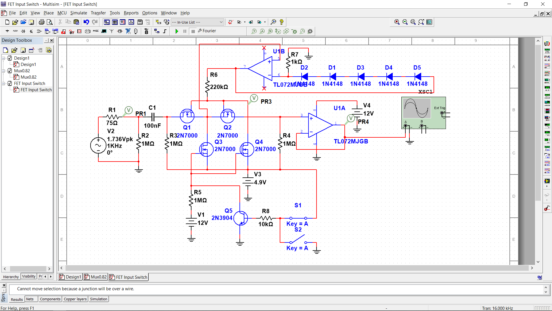

I'm not sure I really quite understand the difference now. I don't understand why the inverter has lower input swing. From what I saw in the datasheet, I think I'm confident that the TL072 will not clip at these input levels of 3.472 Vp2p. Since I'm confident about the swing, I think optimizing for the noise would be the way to go so the buffer it is I guess.
I'm still writing code for the digipot but I put the rest of the circuit together on a breadboard with battery power. I listened on monitor headphones, left channel was the circuit output and right side was the input to compare. I (23) couldn't discern a difference, someone else said the right side (input) was ever so slightly clearer. Remember, breadboard, trimmer instead of digipot and a feedback resistor nominal value in the final amplifier was 3.63K instead of 3.6K which may change the BPF slightly. It's picking up interference that goes away when I touch the circuit ground, I don't think that is op amp instability. I only have an analog scope so no FFT, I may use the PC sound card still.

Your FET implementation is very attractive to say the least. Pairing the CPH6904 with a dual opamp SMD part would be ideal I guess. I just do not really get the schottky placement really, are you using the its small reverse leakage current to turn on J6? If I'd order parts, I'd try that out, but meanwhile I'm stuck with 2N7000 FETs which I'm not sure how audio worthy are they.

In the inverter example the input and feedback resistors form a potential divider at the inverting input of the opamp. Therefore, if the input signal is +1, the output signal is -1, the inverter input sits at almost zero. That is why it is referred to as a virtual ground. Inverter opamps do not experience much swing at the input. The buffer sees the full swing of the input voltage. I would suggest background reading for more info. Opamps not designed for low voltage can have inputs clip early. LT1057 seemed to have this issue. TL072 seemed ok.
The Schottky diode is to block positive V when the logic switch is closed, 1V and above. J6 has to have the opposite control to the switch JFET. On for JFET is when gate-soutce is 0V or higher. The gate needs to be more neagtive than on voltage relative to the source for JFET switch-off. In this case ground is negative as the reference is 6V. The voltage drop of the Schottky allows the gate to be pulled within 0.3V of ground to keep the JFET off at max input signal. Low gate-source on voltage JFET is needed to get the max signal swing.
bucks bunny showed a solution with 2N7002 without the center tie for improved off state. The JFET switch can be adapted to work with 2N7000 but this is enhancement device, positive gate for on and 0 - negative for off. Another opamp would be needed to drive the gates at a DC offset above reference voltage for the on state.

I may try the 2N7000, but it will be bulky. If it really makes a discernable difference I may consider about 10 of them in the final design.
Okay, I never studied depletion mode FETs so that's why I didn't get the circuit at first. I have what I think might be more modern op amps, MC33078, but it's a BJT not JFET input.
The 2N7000 has a gate source voltage spec of 3V. The gate drive needs to be more than 3V above the reference. The higher the better. This then has the prospect of the gate drive opamp clipping due to 12V limit. Check that first.

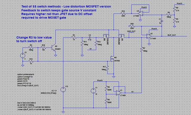

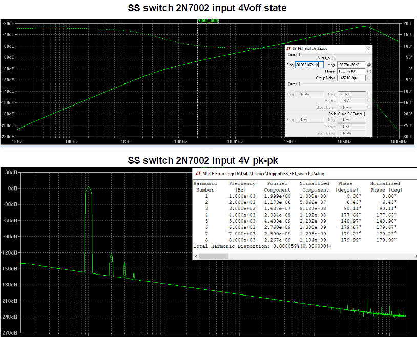

Here is the modified buffer feedback version with MOSFET 2N7002. These have 2.5V gate switch-on. The rail had to be raised to 15V. Distortion at least in sim seems ok.
I realized after posting this, that the gate drive opamp can also be fed from the switch output.

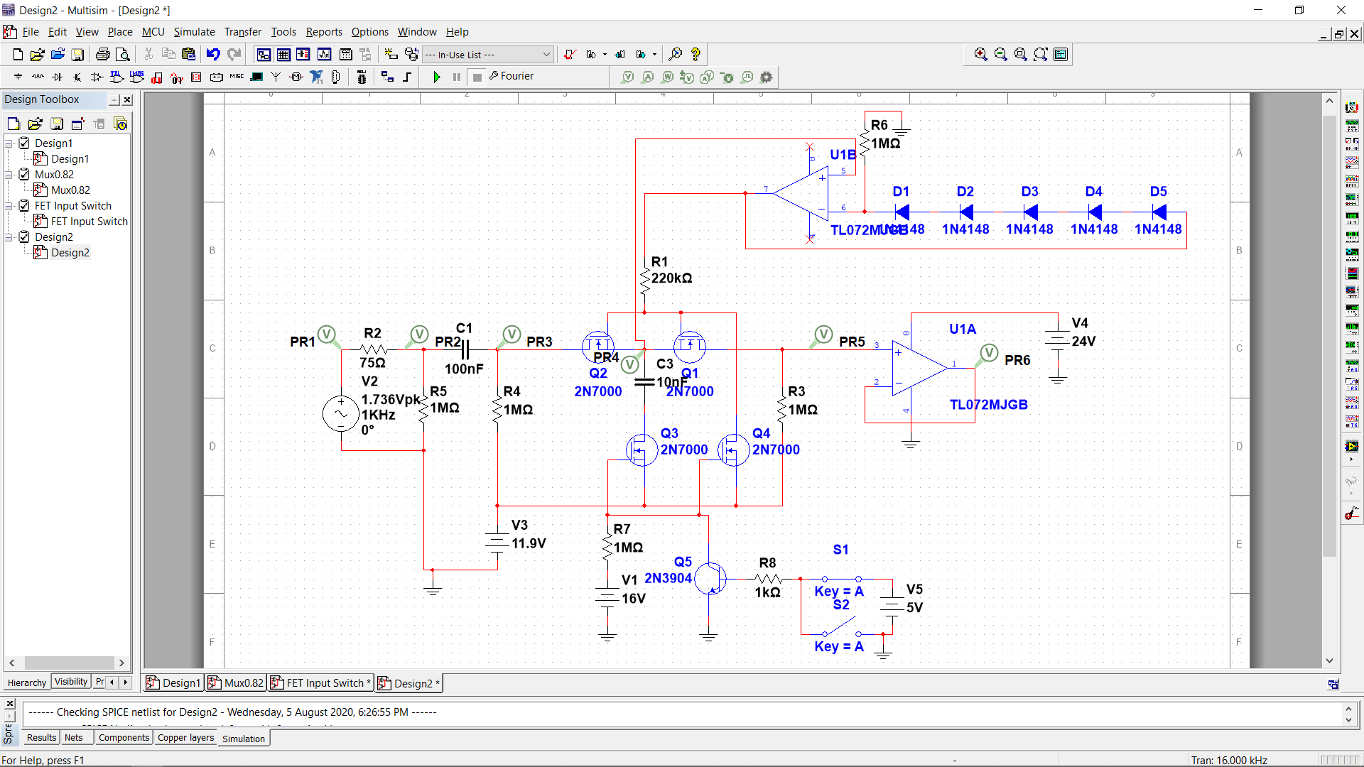

I've been working on something similar with the 2N7000, THD 0.0032%
I may not find 2N7002s here. Q3 has the most impact on THD, even when the gate is at a negative potential the THD was 0.3%. It reduced when I added C3.
