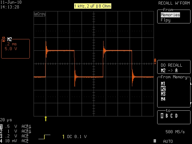

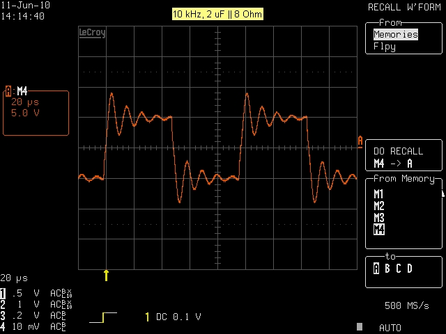

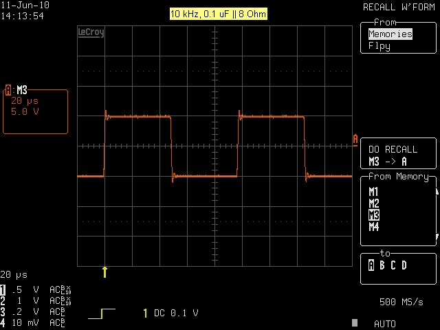

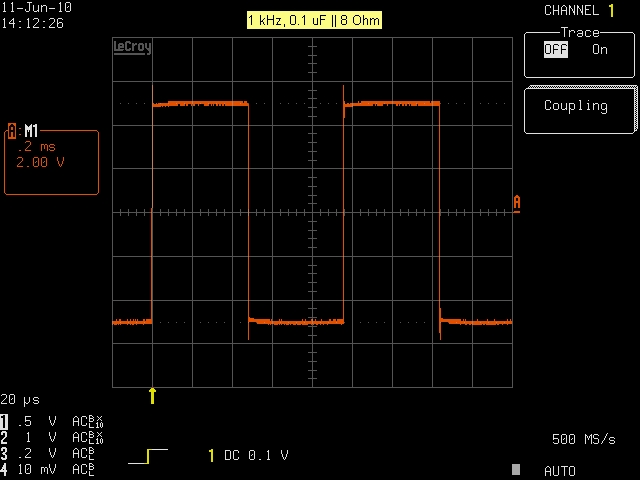

Here are some waveforms of square-wave with capacitive load. Output level is 20 Vpp. An output coil with 10R damping resistor is employed.

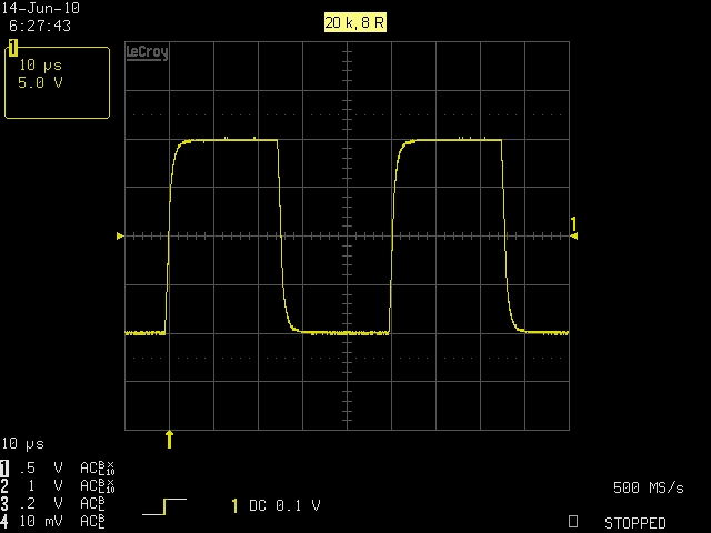

Dear Panson,
Thanks for sharing.
Do you also have a 20KHz Square-wave plot on a pure resistive load? I think you should slightly increase the miller compensation to avoid the overshoot.
Of course, more important, we are all curious how does it sound? 😀

Hi Bas,
Here is 20 kHz square wave (20 Vpp) without cap load. I currently use 32 pF. I will assemble another board to make a stereo amp for listening.
Panson
