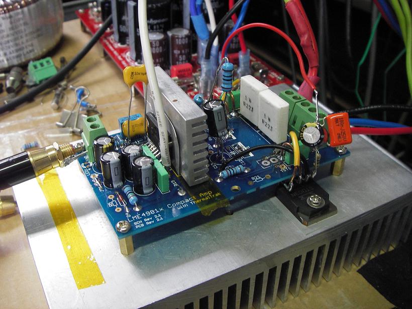

I am studying this thermal system. 49811+driver+TT. Some results are presented here http://www.diyaudio.com/forums/chip...me49810-11-thermaltrak-amp-9.html#post2131781. Please comment.
don't you find it a bit tricky to run the amplifier without any Zobel on the outputs? Did u check for oscillations?
I suggest for extra stability safety margin you mount at least one 5W10R together with 100nF from output to ground.
Sorry, forgot to mention. I run the output of the amp board to another PCB that contains output relay, DC sense & protection circuitry, a Zobel network (10R+100nF), and the output terminals. I had to put this stuff on a separate PCB due to space constraints in the chassis I was reusing. I use 1/4" quick disconnect terminals and AWG 14 (2.5 sq mm) wire between boards both for output and supply.

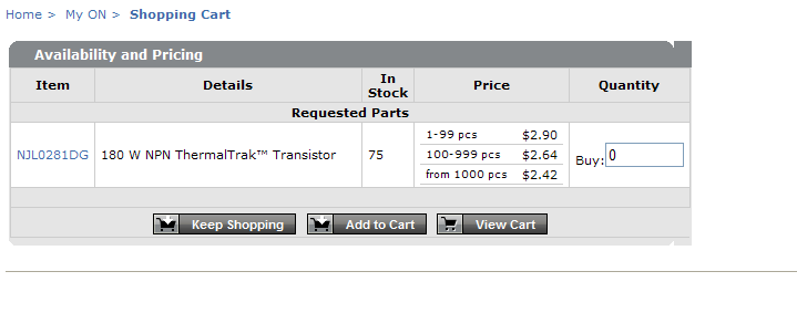

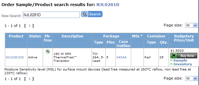

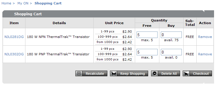

Actually, looks like $1.93 is a bug in ON's website. Volume pricing seems to be either 2.64 or 2.42. I'm with you on the samples.This is volume price. You need to pay $2.9 per device for less than 100 pcs. Better to get free samples.
Arrow quotes some good prices on the STD03s. No NPN parts in stock though.

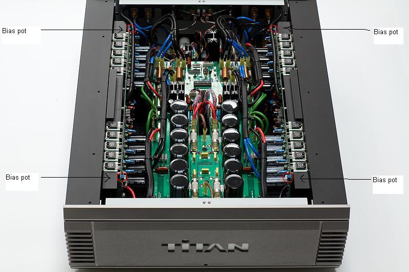

Musical Fidelity Titan bias
I think that Musical Fidelity are using a very simple solution. Looking at the picture of the Titan amp there is on pot per row of transistors. (the lower row can not bee seen in the picture) The amp consists of two amps i bridge configuration per channel. This bias solution will give the advantage of low cross over distortion as each row of transistors, 5 in each row, will be adjusted separatly. I think the pot is just connected to V+ (V- lower row) and the diodes in the 5 transistors in series and then to ground. Comments?

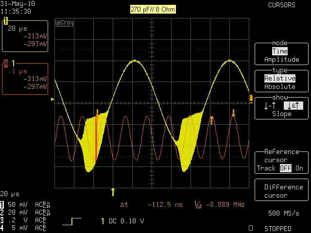

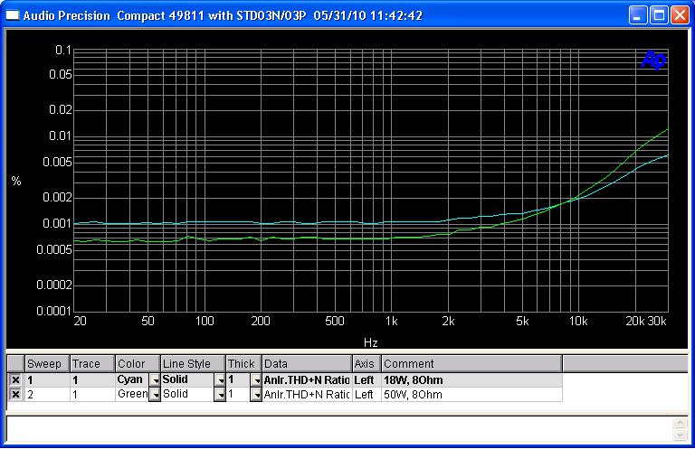

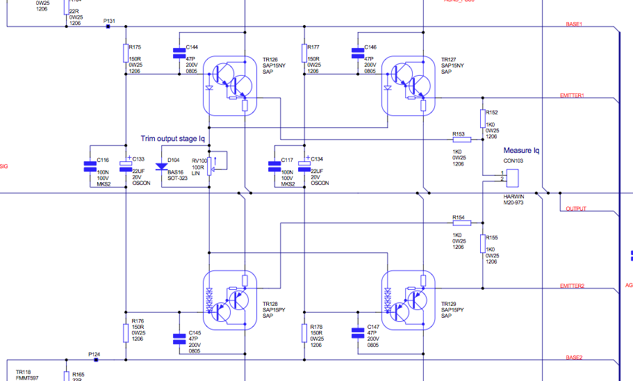

I initially will use 49811 with one pair 03N/03P. Referring to your schematic shown in post 3 of the thread, you put caps C11 and C12 across the base pins. Did you put them there in concept design stage? Or trail and error? I find that without cap my test unit will oscillate when loaded by just a small cap, 270 pF//8 Ohm. The waveform is shown below. I did not encounter such problem with ThermalTrak. Is it because of the super high current gain of 03N/P?
The test unit and its THD+N vs freq for 18W/50W into 8 Ohm are shown below.

Dear Panson,
If I understand you well, if you put "any" cap between the base pin's you get oscillation?
My attempt with putting those cap's is to improve switching behavior of the transistors. But that I have no experience with the LME49811. I never tried it without those capacitor, and I have to admit I got this Idea from Arcam, who does the same trick in the P1 amplifier. See attachment.
Maybe the LME49811 doesn't like this capacitive load.

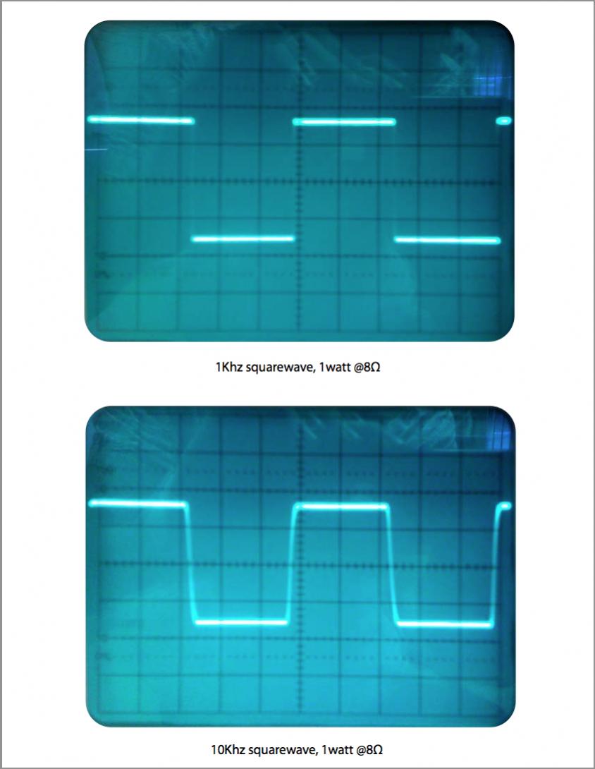

The second attachment is square wave reproduction with the cap's on a resistive load on my actual design. The compensation here was only 10pF but I have to admit this was on the edge! With some messy loudspeaker leads I got oscillation as well. This was solved however with going safe with 22pF.
Hi Bas,
Without cap between the base pins, I get oscillation with capacitive load.

Dear Panson,
Thank for this link, can you point me to the part where they show the schematic? It is a labyrinth for me 😀 If someone has lot's of experience with those sanken's then it must be Musical Fidelity, since they use them for for ages 😀
Furthermore, Did you use/try small compensation cap's between base and collector? I got oscillations without them. You can try base stoppers of a few ohm.
I think the system shouldn't oscillate without capacitance, so to be honest it is a mystery for me as well but I think parasitic's play a part, combine that with the huge total hFE of the Sanken's u can get in trouble faster then you wish for. In my case my amplifier self destruct itself a few times, but all of that was solved after increase the miller cap to 22pF, And adding 47pF compensation between base and collector. In my case the oscillation also happened with capacitive loads caused by different type of speaker wire. That is why I said the STD3's can be a bit difficult to tame 😀

Dear Panson,

Hi Bas,
The schematic is shown in another issue which is not available from the website. I can scan it and e-mail to you. Please let me know your e-mail address.
I have base stopper resistors already, but did not try putting cap across C and B pins. This is effectively adding a Miller cap in the output stage for which I don't feel "right". I might do that eventually for this Sanken part and/or other high-gain Darlington.
I am in line with you that the amp (simple topology) should not have so many caps around.
