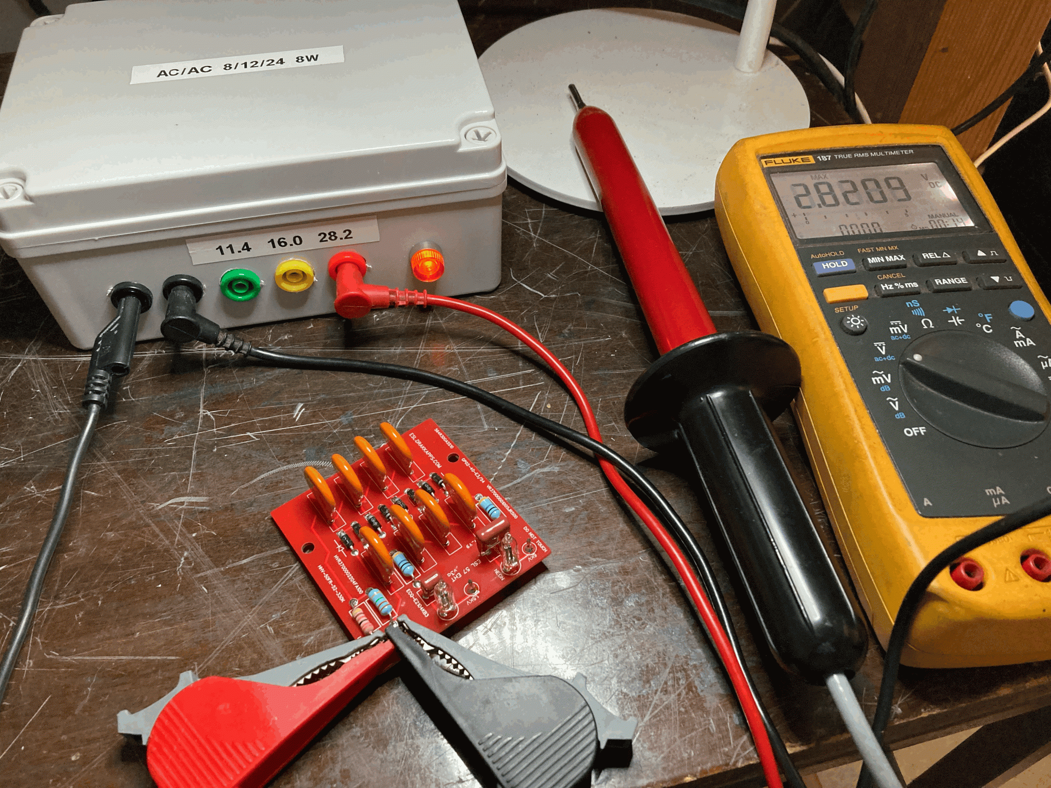

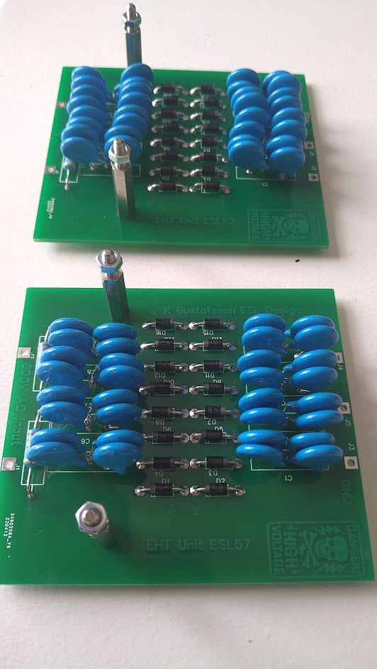

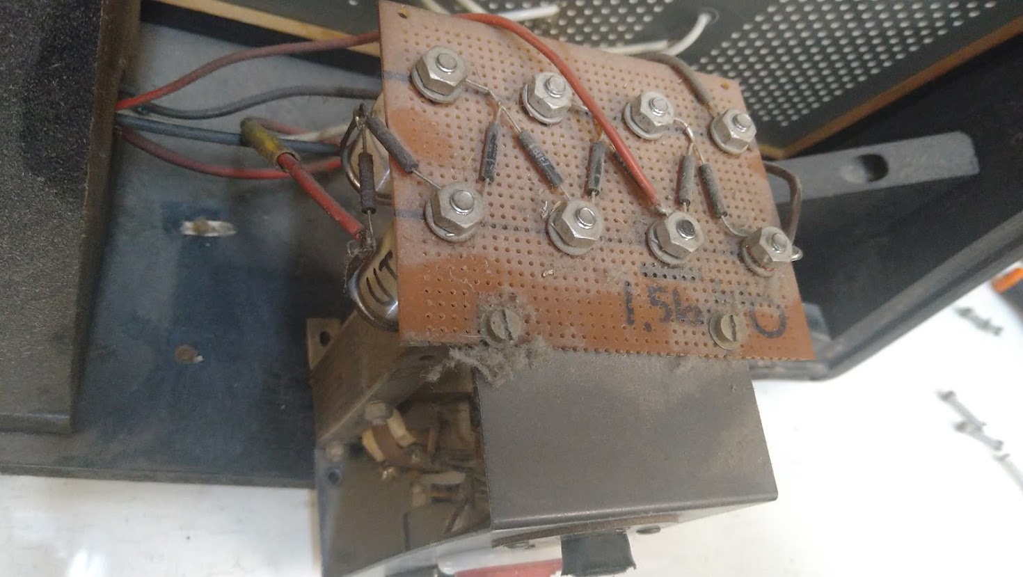

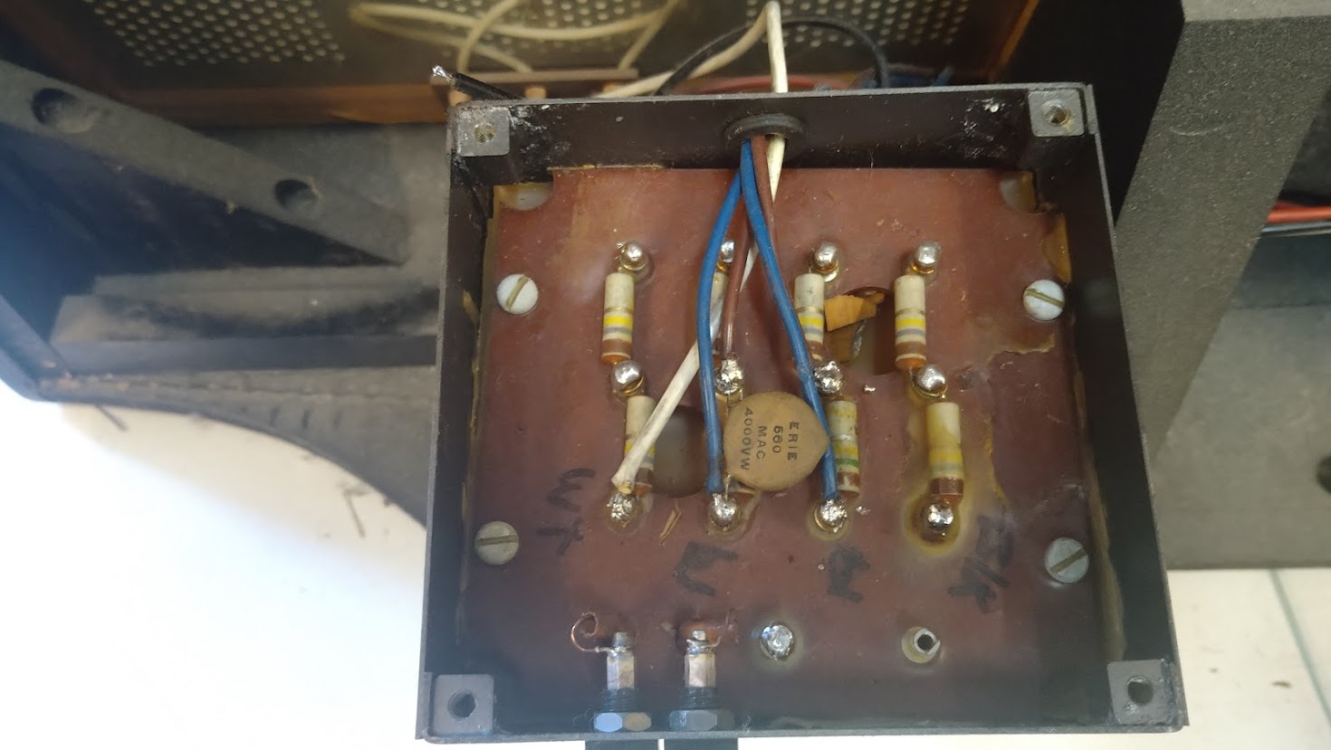

Do anyone of you know if its possible to buy a replacement transformer for the powersupply. Anything marked Sec 600-610VAC 0,5A? I can see OneThing Audio sell a complete unit with PCB mounted trannie... I cant really find any.

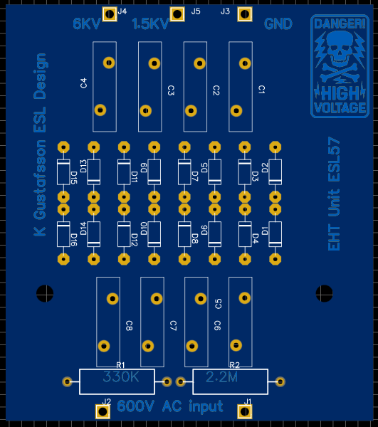

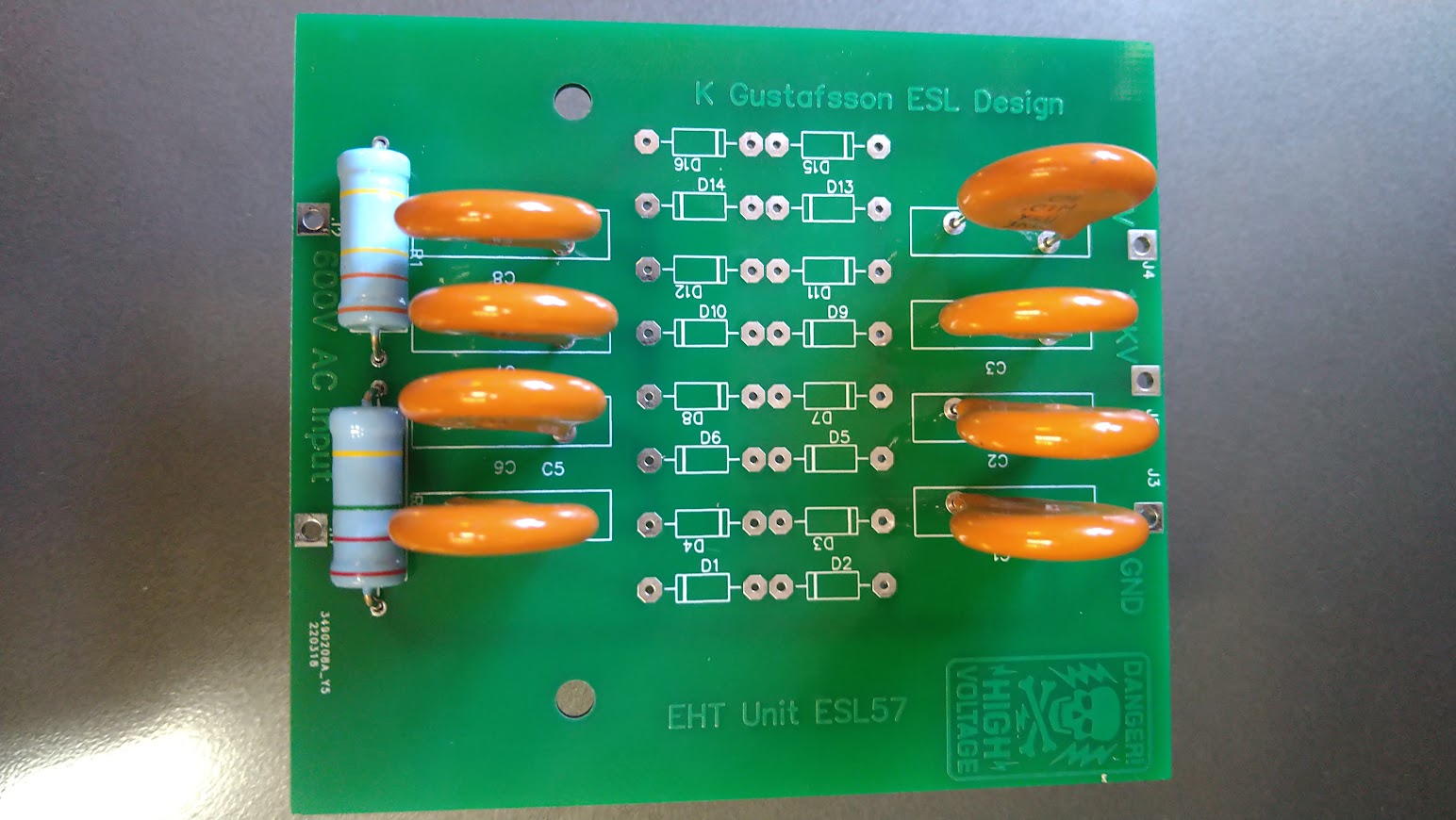

And a pic of my own designed EHT-board
Is the transformer not putting out the correct voltage?
Why otherwise would you want to replace it?
I want an alternative or a unit for test purposesIs the transformer not putting out the correct voltage?
You can use a pair of transformers back to back for testing, or an isolation transformer. You'll get line voltage and not 600vac, but you can clearly see if your multiplier is working.
Thanks I will look out for spare one original trannies meanwhile I try your methodYou can use a pair of transformers back to back for testing, or an isolation transformer. You'll get line voltage and not 600vac, but you can clearly see if your multiplier is working.

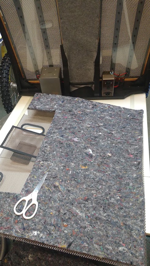

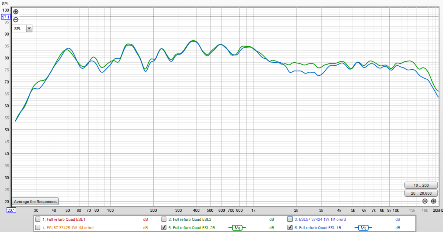

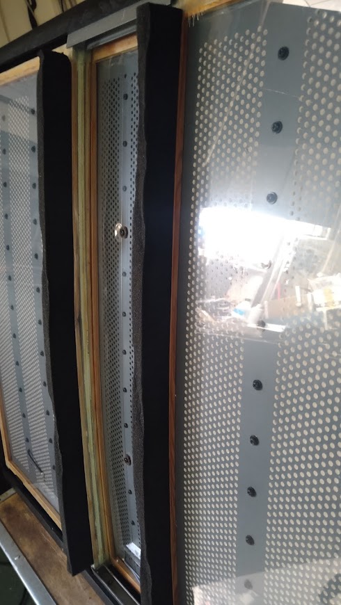

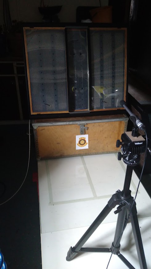

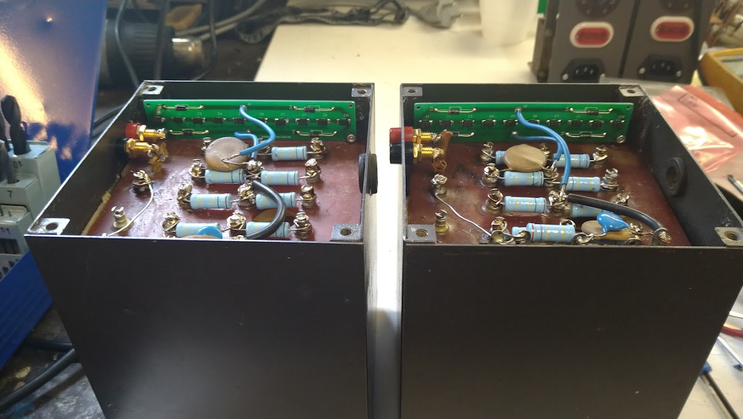

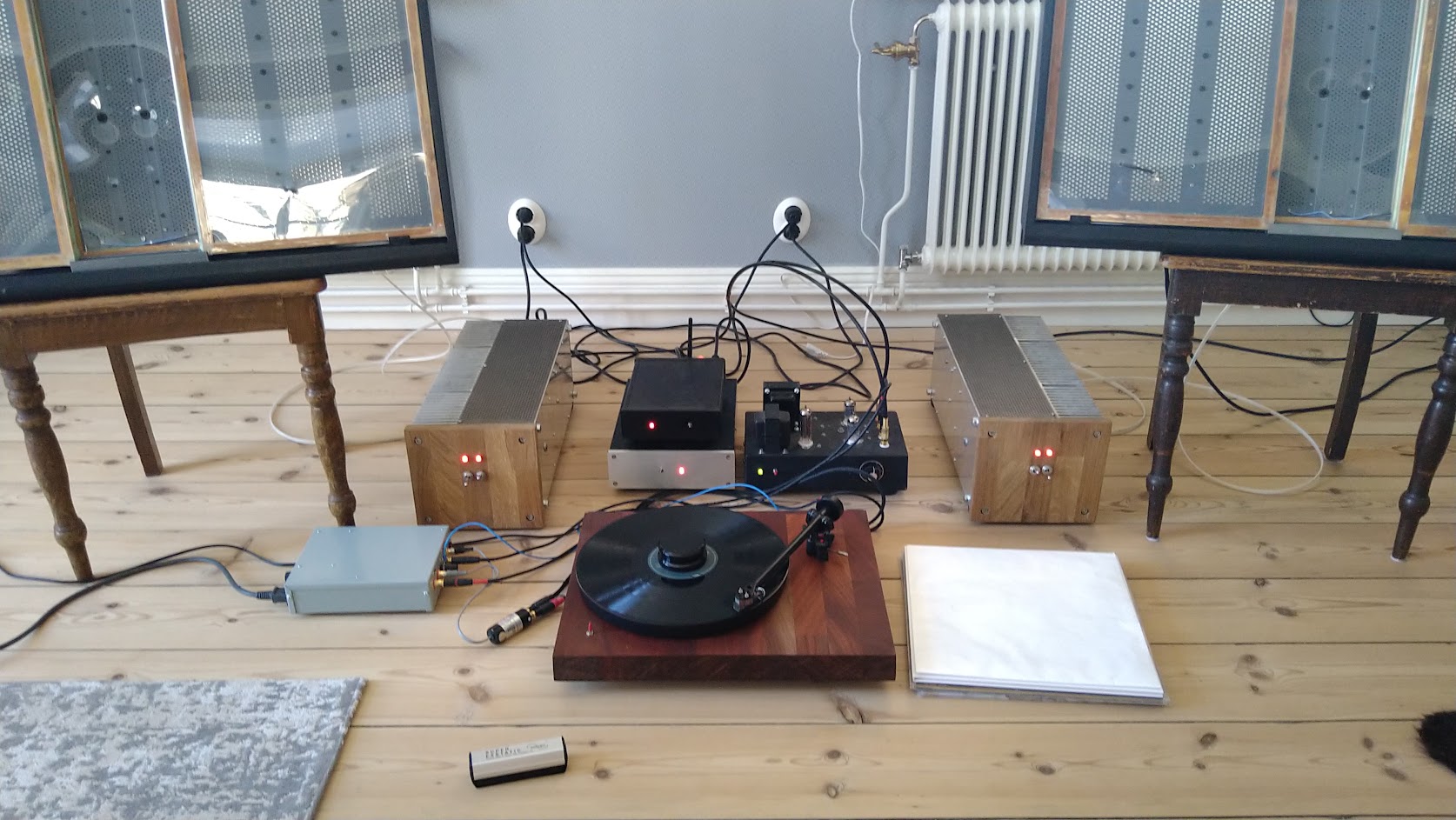

More progress. I have done more testing both with music (vinyl) and also frequency responce with good result. You can see the responce from before refurb and here comes after. Im most happy about the almost mirror like diff between speakers. Also some assembling at the new EHT-boars.
For simple checks, you can use a very low voltage transformer, and reduce risks being hurt. Example attached: 28VAC that give 280VDC.I want an alternative or a unit for test purposes

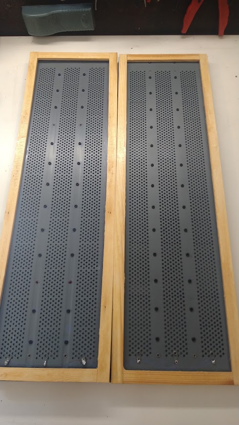

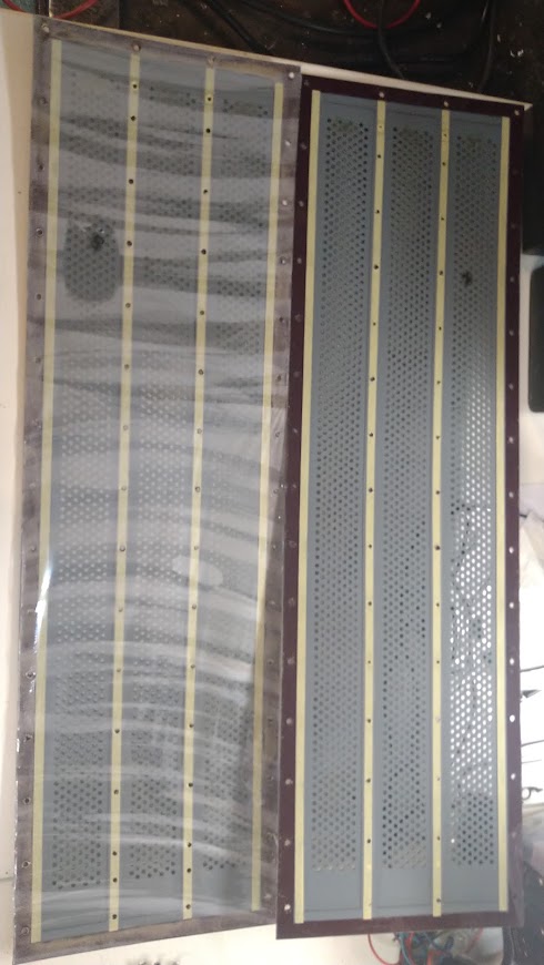

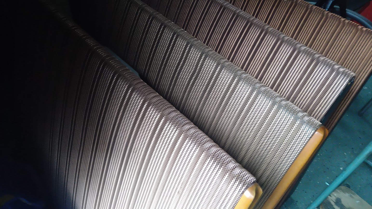

Im currently working on another pair of ESLs. They got arced treble cell. A early pair form 1960 and 61. Will be ready soon for some new music.
First testrun of the reworked panels. Done with 3micron Mylar C. After a night of charge works just fine.

I did some testing with different caps in EHT unit. And it did not work well with the small ceramic disc caps (the bigger ones were okej) i had on hand. But my question was if they were to small to hold charge in the multiplier. Was not able to meaure them, the gigaohm-probe did load them too much. So I set it with paralell and series to get same capacitance and better voltage handling and then now they seem to work just fine.
Result is alot of caps but I have a big bag of them at hand.
I also see a lot of EHT-DIY boards out there. With separate multiliers for bass and treble and also flashing neon bulbs. Good handy gadgets but do any of them really inprove the performance? Separate multipliers will get you advantage not to load the other panels but you still got a problem and flashing bulb to decouple from EHT and flashing to point out performance seems nice but if something is wrong and load the speaker membranes you still need to deal with it. Any thoutgts?

Great to use as a probe together with multimeter. Provides 10Gohm together with multimeters internal resistance 10Mohm. Get a result in volt corresponding KVolt
https://www.amazon.com/dp/B07BWFRY8C?psc=1&ref=ppx_yo2ov_dt_b_product_details
The voltage tolerance is not spcified, and I am afraid the 2.9cm body size is too small. I use a 9Gohm 100mm long resistor built in a plastic tube.This item came receantly.
But it works. On your own risk of cource.... And I get a reading corresponding to what I predicted. Just above 6volts and also above 1,5volts for treble tap. But if you want a reading with measurement uncertainty its the wrong way. If you just want to see the circuit is working properly you are ok. I have also a isolation meter with Gohm meter function and have measured the resistor.The voltage tolerance is not spcified, and I am afraid the 2.9cm body size is too small. I use a 9Gohm 100mm long resistor built in a plastic tube.

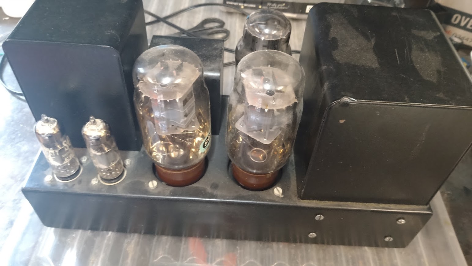

I will be busy with other refurbish for a while. I just came over this pare of Quad IIs and I cant resist getting them up to drive my ESLs. Someone have done a massive rebuild earlier and I will try getting them back in shape, Tubes are weak and I hate those polycaps incerted.. Back to "gunsmoke" and new Quad logos and so on... This pair have served at Swedish Govermental Radio in the beginning. All trannies measures well. A good start.
