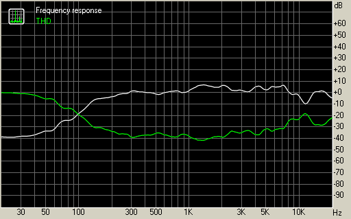

Nice measurements. It also looks very expensive, and very unnecessary. Very much like the flying cars routinely reported in Popular Mechanics and similar magazines.
-Gnobuddy

If we look at ra7s measurements:
The 12 ft and 6 ft measurements are quite alike. The 3 ft shows more combing, from being too close to the array.

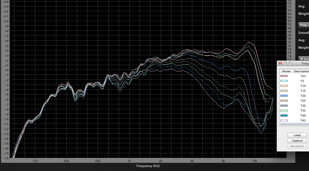

So just a quick update! First, thanks to all those who talked me into setting up some real software tests. I've since installed the free RightMark audio analyzer and also the ARTA packages, both of which work with my sound card. Fortunately I have a couple of very good Samson condenser mics designed for recording acoustic guitar, and it turns out their curves are pretty darn flat, apparently from DC to daylight (J/K).
Anyway, I did an initial assembly and ear test first. My array ended up with 15 of those 2-1/2" VIFA speakers, and I included 4 multi-point terminal mounting strips inside, to make wiring experimenting with different combinations of power weighting easy. To start I just paralleled 3 groups of 5 (4 ohms each) in series, for a total "demonic" impedance of 6.66 ohms.
Before any measurements, I tried my array by ear, in its expected environment. That is, the array sits 2 feet up, on top of my bass box, a ported bass reflex speaker. The ear tests were great!! I did have to turn up the high treble end on my mixer about 4 dB since no tweeters are in the mix. But the sound with acoustic guitar and singing were awesome. Using a wireless link I was able to move about a 20 foot room and feel i'd achieved the first goal: clear articulate sound over at least a 120 degree range. FYI, 14 of the speakers are alternately shaded left and right, by 15 degrees, and the 15th speaker on top points straight out.
So now on to the actual measurement testing, of the array by itself (no bass box). As this was intended as a midrange and upper mid array, I wasn't too disappointed to see response drop off pretty quickly below 200 hz. I was happy to see robust response out to about 15K. But I was disappointed to see some obvious mystery resonance peaks at 1K, 1.5K, and another at about 8.5K. But then, after plugging these into a calculator I got wavelengths of 13" , 9", and 4". Then i remembered... I have 4 structural braces across the inside extending from flush with the back (to receive screws), and extending about an inch less then going all the way to the front baffle. Well this makes perfect sense! 3 of the support braces are 13" apart, the last one is 9, and inner width (and depth) of the array box itself is about 4".
This may seem discouraging, but actually is very satisfying to be able to mentally map each "bump" on a response curve to an actual structure. Especially since by ear and with real guitar and vocals, the array is already a success.
So the next think I need to do is some experimenting to combat those resonances. Obviously putting dense soft craft from on all inner surfaces, along with tightly stuffing the box with teddy bear pillow foam was not enough. So what I'm thinking of doing now, is I'm going to cut some light wood into 3-1/2 " strips, maybe 10 inches long, and mount them internally at angles. spanning from one inner wall across one side to the other. My plan here is make an apparently simple resonance situation into a very complex situation, with multiple broad angles everywhere. The hope will be to cause nearly infinite resonance points, so that they all become irrelevant. I suppose I'll have to cover these inner baffles with more of that soft foam, and then push back all the pillow stuffing. Maybe something even denser like pieces of an old blanket. I do understand that I could also opt for a series of resonant LC+R circuits to force the response flat. But I think it makes sense to do everything mechanically possible first. Good build before EQ, right?

Success! So I think I may be on to something with that idea of adding angular baffles inside a line array. While I won't say its curves are flat as pancakes, the resonances did go away after that addition! Again, this array is intended for use with a separate bass box, so its normal that by itself it drops off on the low end. But it sounds great, and only needs a little EQ on the high end now. (Ignore the green trace... thats supposed to be THD). Also, its really amazing how it sounds too! You can stand anywhere in the room, and if you close your eyes and turn, you can't pinpoint where the sound is coming from. Its almost like wearing headphones in that sense! But anyway, thanks again everyone. I'll add some photos of the finished work as soon as I finish the front grill.
Interesting. How did you go about angling the drivers?
Chris
Of course the angles I was talking about in my last post were about those inner baffles. But for the drivers themselves, 7 of them are pointed 15 degrees left, 7are pointed 15 degrees right (alternating of course), and the topmost speaker (#15) pointed straight out. This was based on what the BOSE speaker angles look like to me, as well as the graphs for the drivers I picked (Those Vifa/Peerless speakers). The graphs provided in the data sheet for those speakers show the flattest SPL curves facing head on, as well as additional curves 30 and 60 degrees out. The speakers are great right up to the end of the audible range head on, but definitely show significant loss in the highs as you get up past 30 degrees off center. I reasoned that the only way I was going to have anything close to consistent response over a fairly wide listening angle was to split the difference, and have at least ONE speaker facing forward. So listening to the array head on, at least one speaker will point right at you, and the others all seem to blend well. I still have to take more measurements at different angles. But to me, as a musician, it sounds great to my ears, and its literally weird the way walking around the room hardly changes anything. That's probably at least partly due to the fact that the room itself is pretty hot. I really need to try it set up outdoors. But wow! When I first jacked in and heard it, I must have spent 3 hours with a wireless link connected to my acoustic/electric guitar playing everything I could think of while walking around the room. This, hands down, is probably the most successful speaker I've ever made. I'll post some photos soon!
