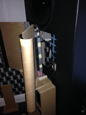

So with two AMT Mk II with acceptable measurement results, I finally sat down and listened to music through them.
Just popped out the old AMTs with wave guides and put the new test rigs ones in front of the baffle.
So far still Q&D wave guides. Excuse me for the poor iPhone quality at poor light.
I have now listened for an hour or so and the new membrane shave faster attack and better resolutions in the highs.
You can see here what I was (or are) listening to.
V5 is definitely better than V4, so I must make another V5 ASAP.

I have now listened to Mk I without the back pole pieces, without the 9 kHz EQ of course but also without adjusting the overall lower SPL.
Something definitely happen, especially female jazz vocalist changed; they all sound more clear.
This is not only due to the lower HF. In fact, I think that was a good side effect; almost every visitor I have had has complained about the "sharpness" of the speakers.
I'll keep it like this for awhile and then lower the bass a couple of the dBs in order to get a sanity check.
The removed reflection not only removed the 9-10 kHz "hump" but now all direct front sound are not inter-modulated with the 0,05 ms delayed reflection.
It shouldn't be audible, but perhaps there were cascading effects and audible inter-modulation that now are gone.
