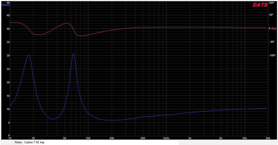

Fritz Impedance
I have optimized the picture.
[IMG, link] http://www.fritzspeakers.com/Images/speakers/Carbon7SEimpedancePhaseGraph900.jpg
Impedance has nothing to do with it. We're talking about acoustic phase not electrical.

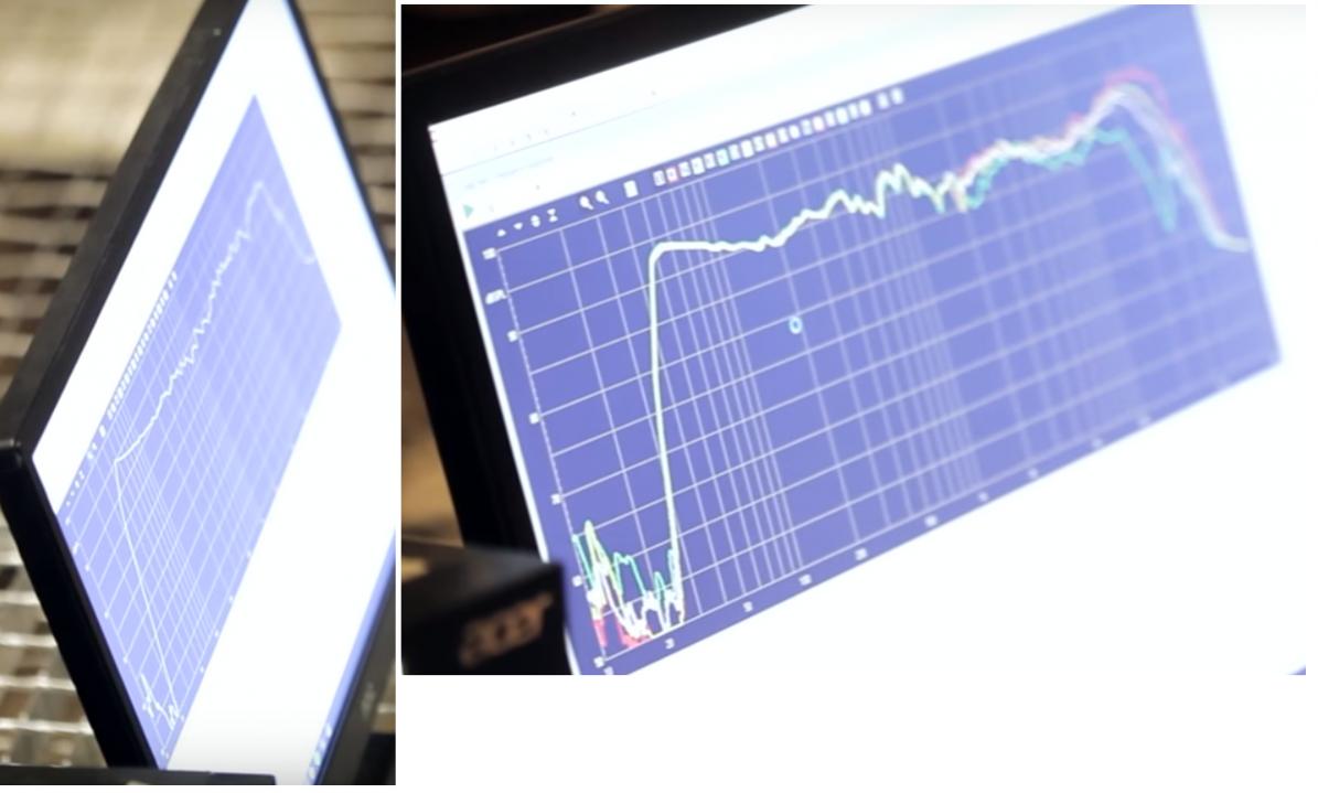

There is a very good article about sound and measuring of amplifiers in AudioXpress magazine. Everything else being equal, test subjects noticed the difference of 0.1dB louder amplifier and described it as "more vivid" and "open sounding". So, what changes are minor in frequency domain depends on frequency where they happen, how narrow or broad they are and the capacity of listener to notice it. In great little video clip made by Herr Klaus Heintz two different frequency response measurements can be seen:
To my eye left measurement doesn't show artifacts that can be seen on the right one - namely 2dB peaking at 400Hz and slight peaking at 700Hz-1000Hz. Dips seems remain untreated, as they should in my opinion. Anyhow, if those are measurement of HEDD Type 20 studio monitor with and without lineariser, than perceived listening difference is not all about linear phase. I'm doing most of my critical listening these days on my modified Kef LS50 (quasi-anechoic measurements here) in near and midfield and i can say that differences seen in the picture above are well perceived even without the phase being linear. Since i made passive crossovers for my Kef's, phase definitely isn't linear. It isn't perceived as night and day difference but, when the right song is playing, it is there.
Problem with this is how are we supposed to know what percentage of perceived differences are due to linear phase and what are due to frequency response being a little more linear ? I know it is tempting to fix that few blips in frequency response - since you are throwing the DSP with FIR filters in the game it is obvious that you should. But the question remains to what extent the linear phase is responsible for it and where linear frequency response kicks in.

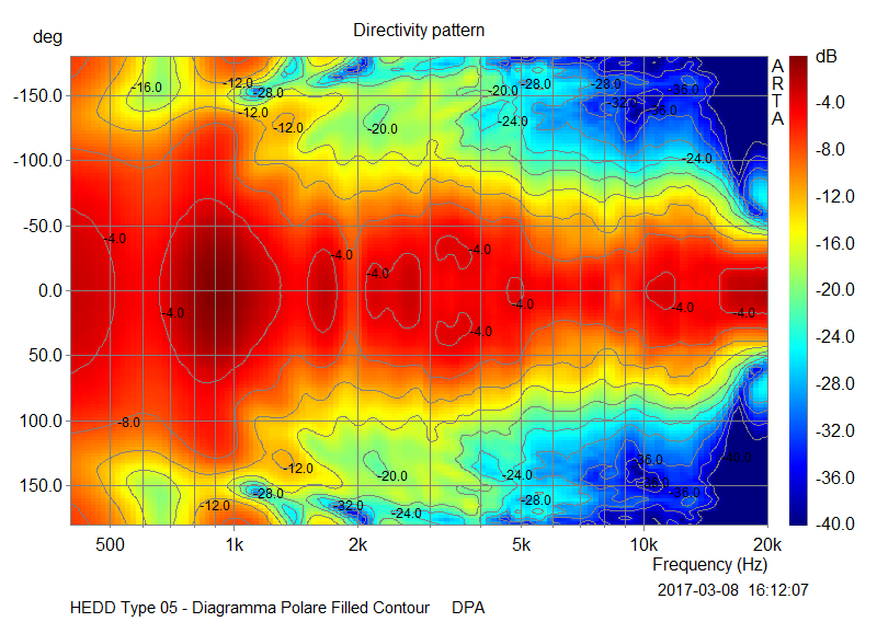

HEDD Type-05
A lot of info and measurements:
[Italian] HEDD Type 05 Series ONE - Nearfield Studio Monitor
