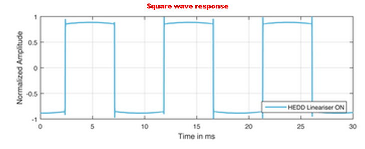

Thanks for posting 🙂
It seems that some people have misunderstood what your Free VST software plugin actually achieves with your speakers!
Absolute polarity it is NOT what it's about
It's not about just getting the phase correct in the Xover region BUT, throughout the FULL TOTAL frequency range. And because the hard work has already been done, it's a Very quick & simple task to enable the plugin & set a few options. This then reveals the magic, & as i said before, it's Not subtle. So this proves, it is the way to go from now on.
Doubters only need to get a proper demo, & then they will soon discover what i did.

»A new trick became reality with modern DSP and FIR (Finite Impulse Response) filters. It became possible to store parts of the
signal in the DSP and wait, until everything would be in the right timely order before being transmitted further. By doing so
phase can be influenced independently from frequency response, a linear phase loudspeaker finally is possible.«
Klaus Heinz: To DSP or not to DSP - that is the question - Heinz Electrodynamic Designs

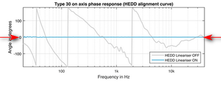

How about we agree it's "absolute polarity"? Phase implies a reference, polarity does not.
And one wonders how the terminology might seem difficult!

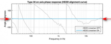

@ scottjoplin
Because some people are going on about 180 phase shift, & only Xover phase etc
@ mountainman bob
Yes, this particular VST software is only going to work with computer based systems right now, But, there is software that allows you to run VST's without a DAW. I've forgotten what it is though ! You might be able to run this in for eg Minidsp etc & then use a plugin/s.
Also there is this rePhase, a loudspeaker phase linearization, EQ and FIR filtering tool
@ mountainman bob
True, but the same people are also going on about flattening the phase response across the audio band, which shows they understand what it does, so you are wrong 🙂Because some people are going on about 180 phase shift, & only Xover phase etc
