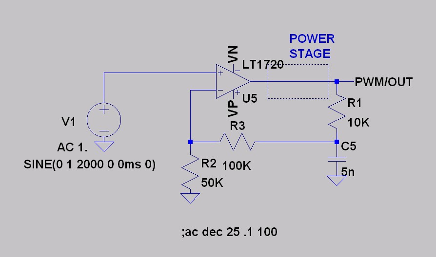

Hi all -- could someone explain how this design "self oscillates" such that the comparator does not require a triangle wave input? I don't understand how the pwm signal is being generated in this design.
Hi Andrew,Hi all -- could someone explain how this design "self oscillates" such that the comparator does not require a triangle wave input? I don't understand how the pwm signal is being generated in this design.
It's self-oscillating. An amplifying oscillator, or an oscillating amplifier 😉 Here's an Ltspice bone-level schematic to show the principle.
