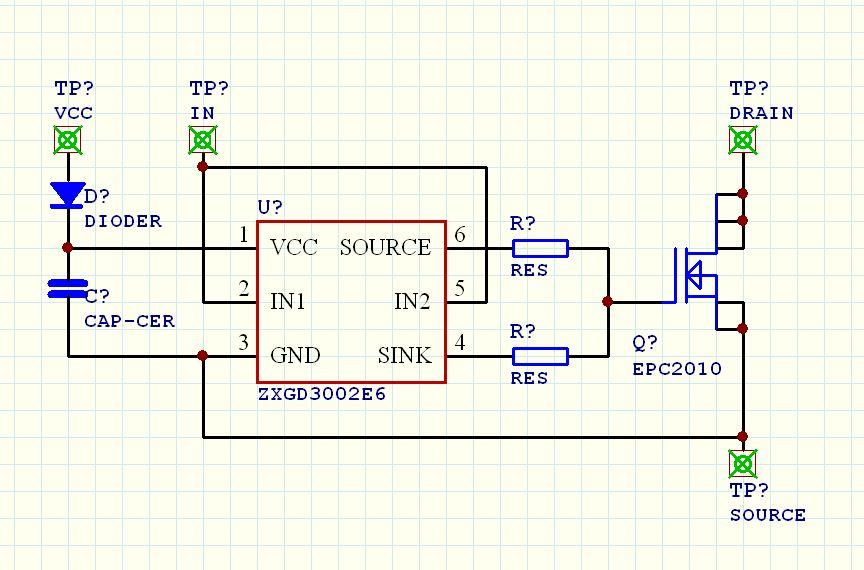

limited gate drive
Thank you smms73, that's very good reading.
So in essence we mitigated one problem (dissipation on VGD) but highlighted another one (limited gate drive capability).
This in turn limits the present circuit on the higher power end.
How about using a complementary pair as post-driver stage, in the style of this?

This would work, in fact I use ZXGD3002E6 on my two amps, take a lot of load of the IRS, and note that they are BJT's, would be even better if they were mosfets. Note this: they do use this kinda drives on their eval boardThank you smms73, that's very good reading.

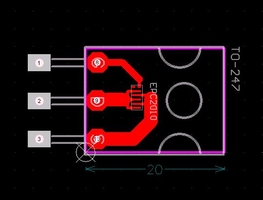

EPC2010 in a TO-247 package
In practice, the substrate would have to be glued on a metal slug, and everything encapsulated in epoxy...
(and the pinout reversed 😀 )
Come to think of it, there's enough real estate left for my grandma (AKA driver, gate resistor, bootstrap cap).
To be continued...

Just to get an idea of the proportions, here is the EPC2010 in a TO-247 package...I know size matters, but this is not for diy
To be continued...

what about with 220? inductance of leads is killing you hereJust to get an idea of the proportions, here is the EPC2010 in a TO-247 package...
To be continued...

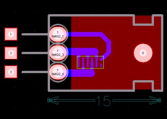

Meanwhile here's a peek at grandma 😀 What do you say luka? And smms73?
Mind you it's now a 4-pin affair.

And yes - I would produce a PCB the size of some common package. Though no epoxying to anything would be needed - the die would be on the "back" of the device; in such a way that you can clamp it directly to a heatsink the same way you would a normal transistor.
For a mosfet it might seem small - but it's actually a fairly large part on the scale of common SMD components. This would translate to a "1406" size device (140 mils x 64 mils), and parts as small as 0806 or 0604 are possible to assemble by hand.

Luka,yea this look ok, but how in the world would you do that?
ok make what, pcb the size of 220 or 247, and solder everything on that? and epoxy it to what, tab of 220 or 247?
here's a stab at the EPC2010 on a TO-220. Nothing particular really. Bluefusion also has this in mind but without heatsink I believe.
Yes, the PCB would be the same size as a TO-220.
For the tab/heatsink I would choose copper in the same form factor as the TO-220 (and the PCB). Then, use epoxy glue, enough to cover all of the area, and immediately squeeze the two parts together with a laundry clip (preferably a strong one) taking care to keep the PCB (the mosfet substrate) tightly parallel to the copper. That won't be easy, so you want to mount a few spacer components approximately the same height as the mosfet chip on the PCB corners, before glueing. Maybe 0603 or 0402 resistors?
Once the thing is hardened you can deburr, make it look nice and post a pic here 😎
One more thing: I'd use a 1mm or 0.8mm thick PCB.
Also, ideally the epoxy should be one with good heat conduction.
