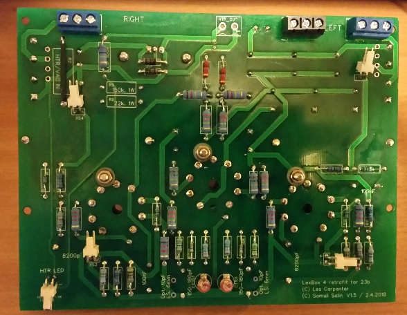

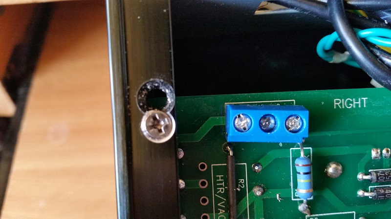

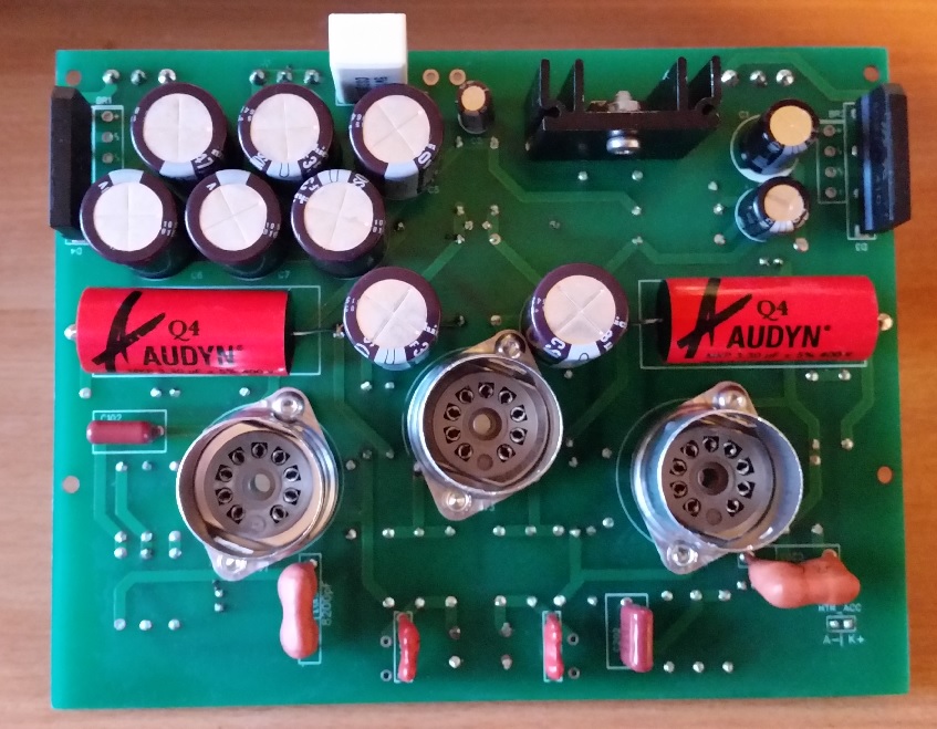

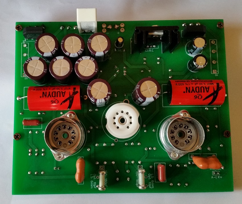

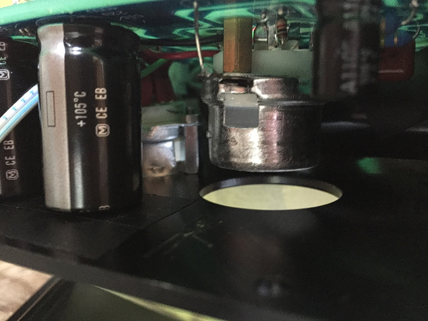

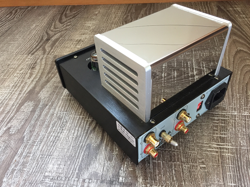

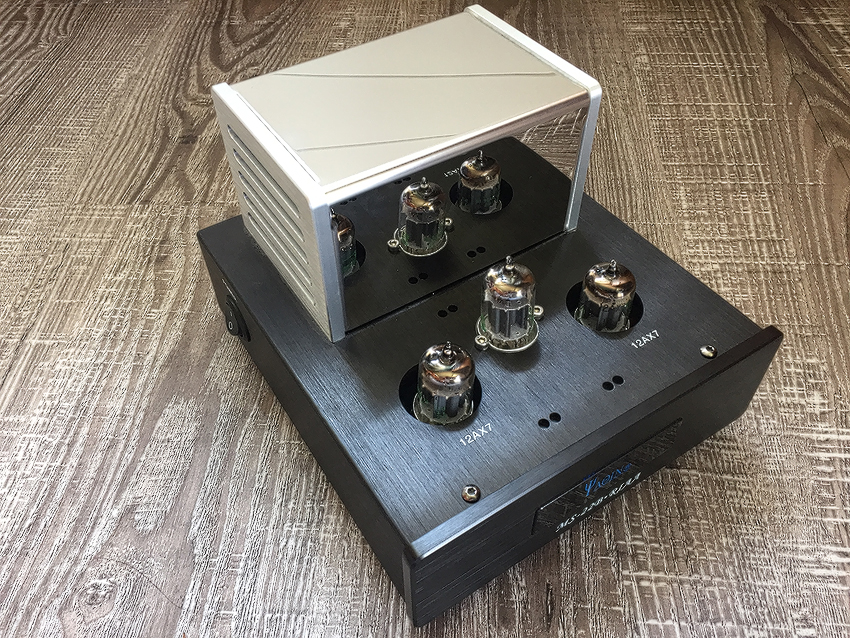

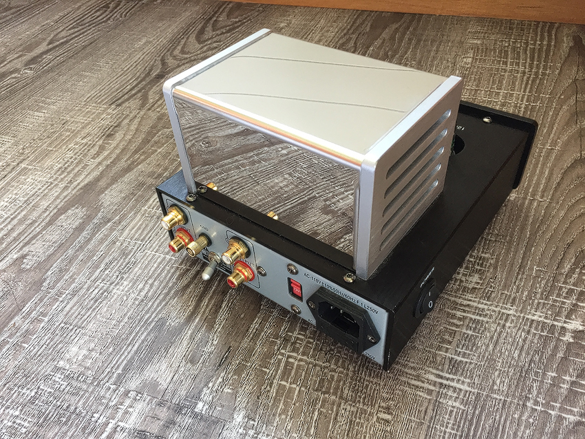

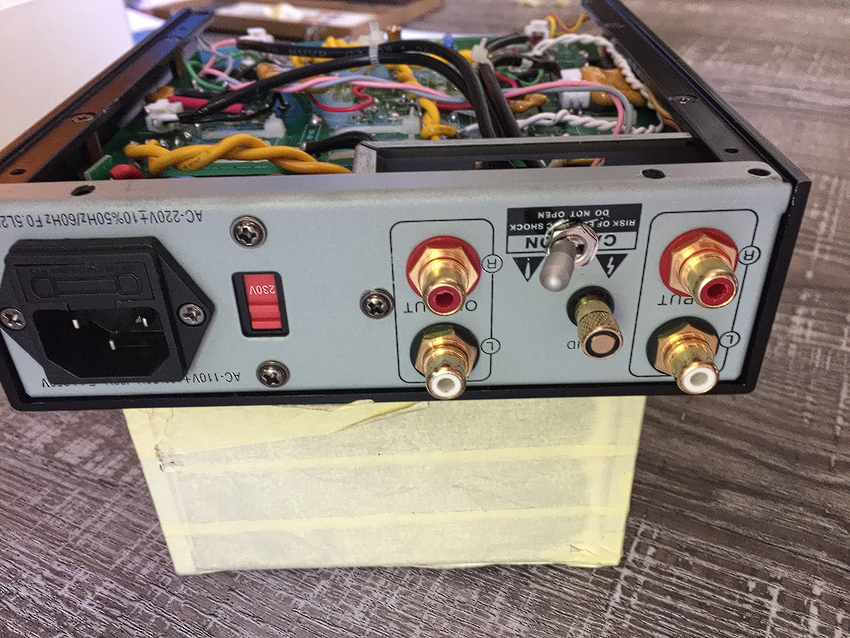

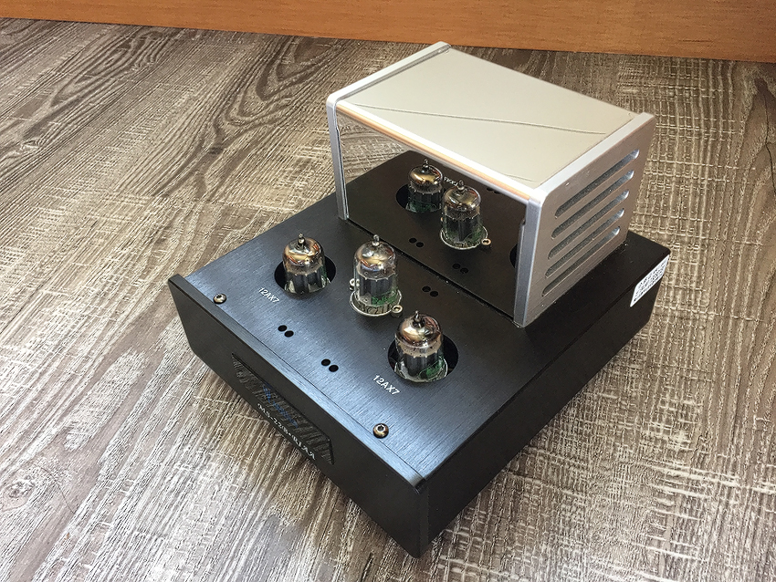

Well I may be able to help you with some parts, will be a lot cheaper than sending the whole unit and the reason why there is a guy in the States doing the conversions. With regard to the replacement boards, we have had a problem with mechanical fit (5mm too short), possible to overcome but art work is being changed for another batch of boards. I did successfully fit the very first board to a UK MS23 and the owner is very satisfied, the RIAA plots came out really well. I have a couple of the early boards spare if you want one, you will have to drill two countersunk 3.5mm holes in the side rails, 5mm below the existing ones closest to the rear panel. The boards use special tube sockets so I will provide these with each board plus the five 2 pin plugs that mate with the present sockets feeding the signals in and out, plus of course the LED one. The other big problem with these early boards is an accidental short circuit across pins of V3 and some tracking being too close to the fixing points. These I can remodel and fix as required. But for those prepared to wait just a little longer, we should soon have some boards you can fit without any of these track problems.

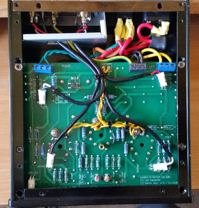

I did the Lesbox modification to my brand new MS-23B. All went fine and it sounds great. The only thing is that i have is the overheating problem described on page 45 of the manual. So that resistor is on order.
It was an easy job. The only thing a bit more hard to see on the picture was where and how to place the EQ's. But looking at the diagram itself did the trick.

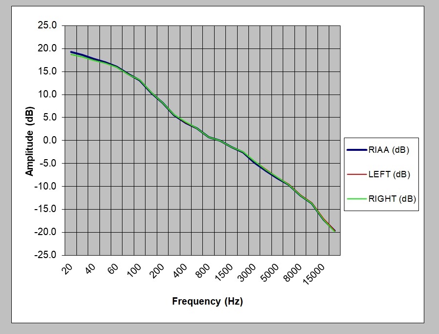

Have a sample of 10 of the new boards but cannot release them until I know they fit OK and that will also enable the instructions to be verified/completed. I have offered a free built and tested board, plus fitting, for anyone in the UK as a guinea pig but nobody with an MS22 or MS23 has yet taken up the offer. I don't want to release the boards until I know they fit OK mechanically, the electrical tests are fine and no doubt will be better when fitted into an enclosure.

Just received my Lesbox conversion with one of the new boards. Very many thanks Les! My system needs setting up after some building works carried out but can't wait to try the MS23b with the new board. Have to say Les is top man, turn around from sending the MS23 to it being returned was les than a week and included very helpful documentation including circuit diagram of work carried out. Will post review after listening, although I'm sure I won't be disappointed.
