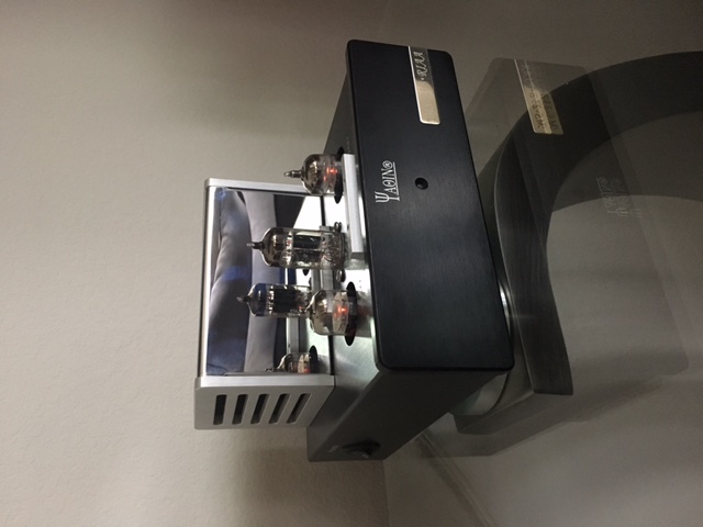

Hey Les (or anyone else who feels qualified to answer),
I just got my MS23b, and to be honest I think this unit is fantastic right out of the box (at least after swapping the stock tubes for a matched pair of Sovtek 12AX7LPS's). But there is nothing I enjoy more than a good "tinker", so I am about to undertake the conversion!
My question is regarding the 8200pF 1% Silver Mica Caps. As was discussed earlier in the thread, this part is very hard to source. They are still available at Mouser Electronics, but they want $32 +shipping for the pair. OUCH! However I already have some in 5%, so would it be alright to use them? Or is the tolerance critical here?
John
OK, so I found the answer to this question right there in the PDF on page 3 under "suggestions":
Boy do I feel like a fool, I probably skimmed over this a half dozen times...

Thanks for the reply Les. As I said, I already have a pair with 5% tolerance, and since you say you tested with the same and found them satisfactory I think I will go with them.
BTW - I've noticed that a lot of people go without the screening cans (whether LesBox converted or not). For anyone planning on doing the conversion and not using them, at least on the 3rd tube, I think I have an idea of how to mount the socket that will make reassembly and future circuit board removal much simpler. And you will even be able to use the top side shield without modification! In fact if you leave the cans on the 2 channel tubes, the unit will look stock at first glance. Personally I plan on not using the cans and raising those 2 tubes with socket savers, just for looks...
I will post pictures when I complete the work.
Here it is:
And the best part is that the whole thing just slides in and out of the chassis.
Celebabe that is super - can I append your photos to the conversion instructions? Orange included
By all means Les, please do! If you need higher resolution versions or more detailed shots just let me know by PM, I'd be more than happy.
John
