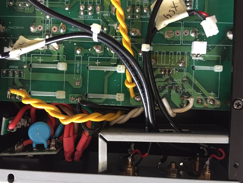

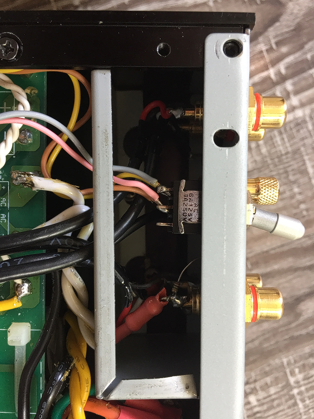

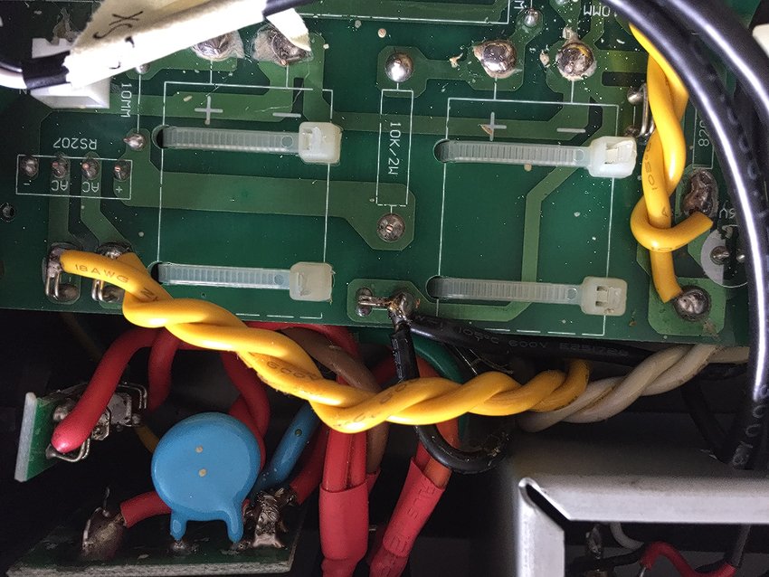

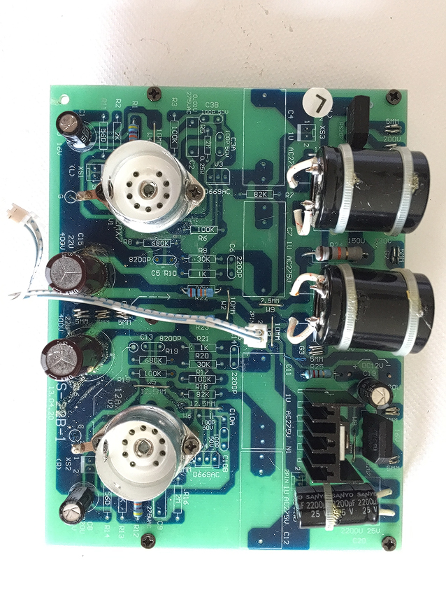

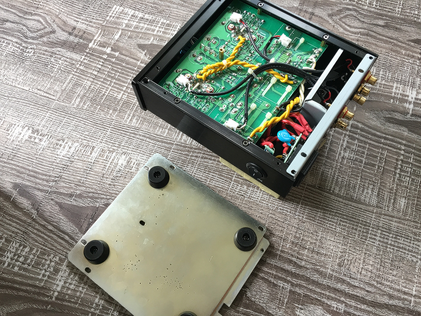

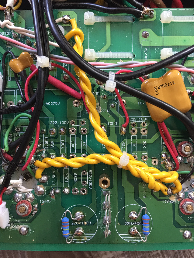

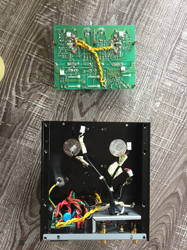

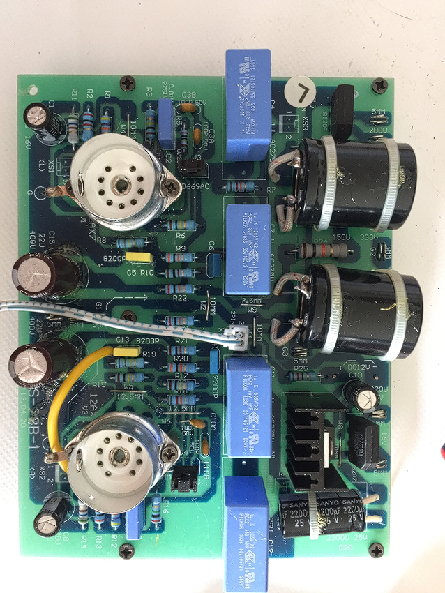

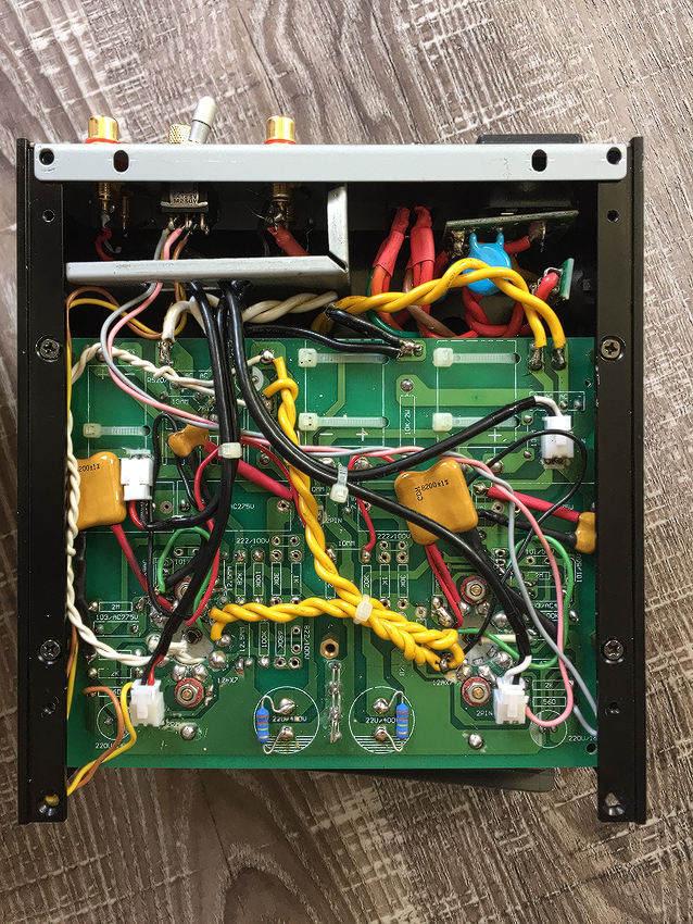

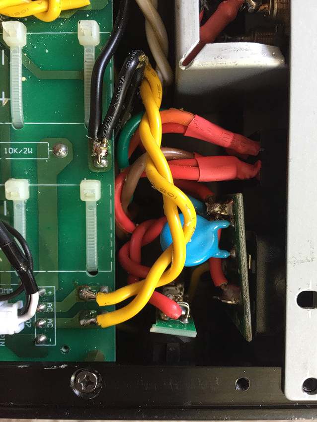

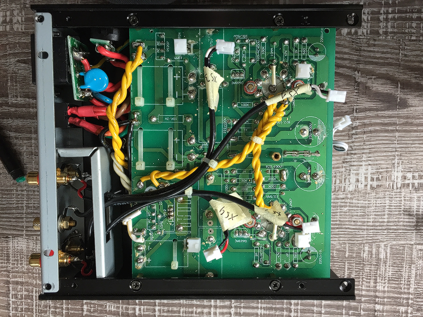

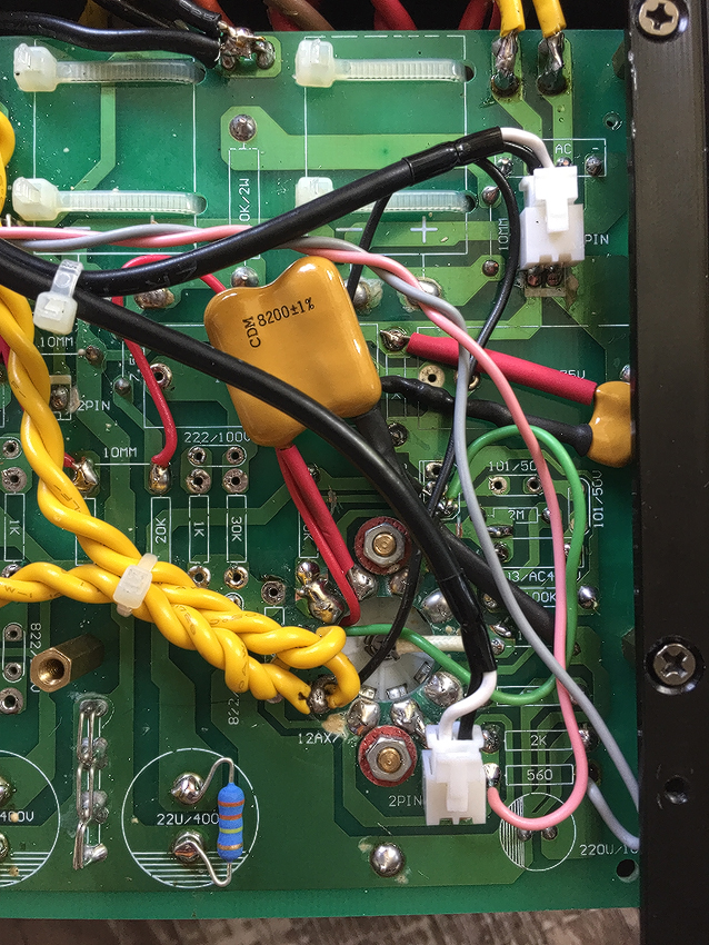

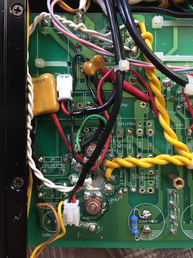

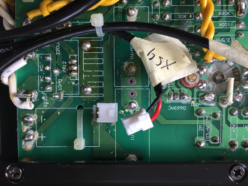

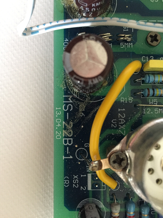

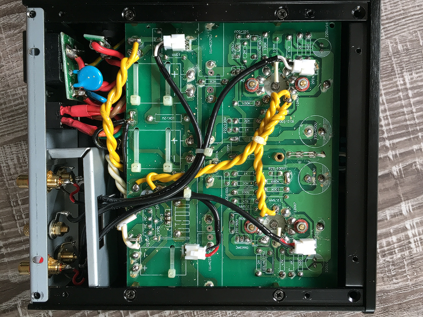

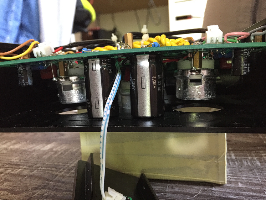

Hello everybody, I'm new to this forum. Firstly, sorry if my english is not very good !
Last summer, i have made the modification on my Yaqin MS-22B, following the Les Carpenter pdf file.
Everything went very well, but like Les says, if you check all twice, everything will be ok. I have not all the same component of the Les list but it's ok.
The results: All i can say, that this is night and day ! When you listen the unmodified Yaqin when you bought it, you say it's great and no need to change !
But once the modifications are done. It's , like Les Carpenter say, it's like you have removed a curtain from the front of the speakers ! All sounds are crisp and detailled, instruments are very well distinct and separed !
I'm very happy to have done this modification and I thank Les Carpenter for providing a very well detailled document.
I have made some photos of my modifications. There were some difference between my pre-amp and the picture of the document . I hope this can help .

Here is the next pictures of the modifications:
