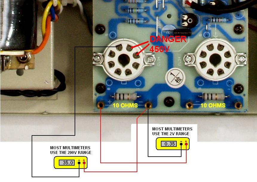

The voltages you state are crazy as 18.7V would either mean the valve is passing 1.87 Amps (Very Highly unlikely as the amp would be in melt down!) or the 10 Ohm monitor resistor has gone way high in value!
I wonder if your meter has auto ranged down and you are reading millivolts (mV) rather than Volts? There is a possibility that you may have a rogue valve that is affecting the bias supply but as one of the valves is sitting nicely at around 0.35V then this would suggest this is not the case. I do not have that many photos of the newer chassis layout but I have attached a picture of the left hand side. With the amp turned OFF, measure each of the 10 Ohm resistors with your multimeter, you can do this using the bias measurement points to save you removing the top cover. If the resistors seem OK, try setting up the bias on each of the left hand valves to around 0.35V using the trim controls.
If this cannot be achieved, pull the valve that is not responding and verify that the bias voltage of around -35V can be seen to be present as shown in the picture. Remember that it is a negative voltage so you have to put the Multimeter Black wire onto the valve pin*. If this is correct then the valve should be suspected, try another valve in this position. You should get proper biasing now unless you have more than one valve faulty which would be very unlucky. The reason for hum may be due to excessive current being drawn from the B+ line by the valves not being biased correctly. The excessive drain makes the supply smoothers work too hard to the point where the supply ripple increases. This will be at 100/120Hz rather than your mains supply frequency of 50/60Hz.
Hope you get the amp sorted
Les, Watford, England
*Not necessary with an electronic Multimeter but is suggested in case an Analogue type meter is being used.

Thank you Les. I was advised by a repairer to urgently take it to him to avoid blowing all valves. But from your description I think I just have 1 rogue valve. I have the hum, 1 very hot valve and high bias in the affected side... BTW which way do I turn the adjusters to decrease the bias. I want to set it low for all valves as I add the new valve to avoid blowing any...
If you monitor the bias voltage at the valve holder as shown in my post #93, then adjust the relevant bias control for maximum negative voltage.
This will set the valve for minimum current. From my poor memory I think turning the controls fully anti-clockwise achieves this condition but I would advise checking with a meter as my 65 year old memory cannot be relied on where safety is concerned 😀.
I have noted in other posts that a bias of 0.24V is recommended but I think this figure is a little 'cold'. From all of my research into comparable amplifier circuits, then 0.35V would appear to be a better figure to aim for and my amplifier has run quite happily at this setting for 3 years now.
Regards, Les

I'm not an electronics expert by any stretch of the imagination however I'm quite confident the voltages I'm reading are correct because I manually have to adjust the multimeter sensitivity. To read the top left and right bias (which give the correct reading) I set the multimeter to 2000m whereas this just gives a reading of 1 for the two lower biases. If I set the sensitivity to 20 volts I still get a reading of 1 and therefore I have to set the meter to 200 volts which is gives me a reading of 23.4.
I have tried turning the amp off and testing the resistance. On the top two testing ports the resistance is 10 (When setting the multimeter to 200) whereas when I try testing the bottom two ports regardless of the sensitivity I can only get a reading of 1.
Does this suggest a wiring fault with my amplifier?
Thank you for your help.

You should get a reading of 10 Ohms on all four test ports. If you are only getting 1 Ohm then the possibilities are 1) incorrect value resistors or 2) the resistors are being bypassed by another circuit. These resistors feed the cathode so a cathode to heater short within the valves may produce this effect. Try measuring these lower resistors with the associated valve removed and see if the reading goes up to 10 Ohms. If it does then the valve must be at fault but if the resistance stays at 1 Ohm then you should check the resistors and associated circuitry. The test results you give are rather perplexing as one does not expect a film resistor to fail low, they usually go open which is why they are fitted in this position.

I might not have made myself very clear last time. If I have my multimeter switched on and the test probes touching nothing then the meter reads 1. If I touch the probes together then I get a reading of 0. I've taken all the valves out and the top two sets of test points V1 & V2 each report 0.10 (When setting the multimeter dial to 2000) whereas on the same setting on V3 & V4 my meter remains at 1. I can see the resistors from the holes where the valves go and the plastic coating on all four resistors states 10ohms. Is it likely that the two resistors could of failed? Would this result in my high voltage reading when the amp is switched on? Is there any advantage in me testing the points again with the power switched on and no valves in the unit?
Thank you again for your assistance,

I wonder if you have a problem with your multimeter? Perhaps you could try measuring a known good resistance with it first, just to confirm that it is measuring resistance OK. If all is fine then it would suggest that two of the resistors may be open circuit.
