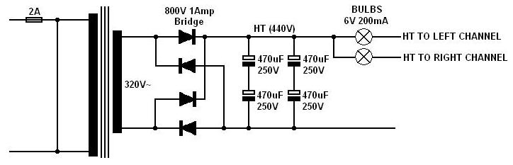

Can't help you with the DACs Brian, not enough experience here but a good surf around may bring up something. I am pleased with the 6CA7's and my many visitors think they sound great. I keep looking at the power supply of the Yaqin and can't help thinking something should be changed here. I am posting up the HT part on the Forum and hoping someone can add advice or support some of the concerns I have, maybe I am worrying too much. well I have added some voltage equalizers across the caps for starters and just wondering if it is worth adding some 6V 200mA wire ended pea bulbs to protect the transformers if any of the output valves went down. I would like to hear from anyone who may have tried these. Yep, I could use a fuse, I know, but a small pea bulb would be easier to fit in the amp and take up minimal space. The switch-on surge taken by the bridge rectifier must be a bit harsh, I just hope it can take it. It must be even greater in your version with 680uF! Also, should I be concerned about the 800V piv rating of this rectifier? It's just that my experience keeps telling me the margins are a bit too close for comfort, just hope the rectifier manufacturers are providing a good safety margin.
Still it's nearly 18 months old now and no smoke yet from the HT circuits! Cheers, Les

Glad to hear its sounding nice with the new valves Les, Yes the power supply does concern me sometimes, I havent had any problems with the initial surge on switch on since I changed to the 2.5 amp time delay fuse, it would be interesting to see if anyone else has come up with a solution to address this, have run the amp for 12 hrs the other day, admittedly the mains transformer got a bit on the warm side, I think a bit of extra ventilation may help there as it doesnt seem to get quite as warm when the lid is off, My next door neighbour works in a sheet metal fabrication shop, might pick his brain to see if something can be done with the green top hat cover. Also I rechecked the bias when I had the lid off the other day, V4 had crept up from 300mv to 326mv, must be a little bit of drift at the pot, will keep an eye on it, I usually leave it an hour after adjustment before I take my final reading, will check it once a month to be on the safe side,I have bought a set Svetlana 6n1p,s to try, will have them Weds the specs look the same as the chinese 6n1,s so I,ll assume they are a drop in replacement, I,ll let you know how they sound, thanks for the drawing,Brian.

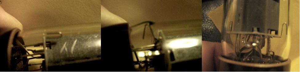

By the way Brian and anyone else viewing this post, watch out for a defect in any EL34's you buy. One major reason for trying the 6CA7's was the fact that I discovered to my horror that one of my Harma Cryogenic EL34's was not assembled correctly. I have been using it for months and it could have cracked, admitted air and probably done a lot of damage to my amp, just glad I spotted it in time. The attached photos show how the electrode to glass spacers should be, the second photo shows how one spacer was not in position. This made quite a large dimple in the thin glass tube, unfortunately my camera does not focus too well at short distance and the actual dimple size does not appear that big. But it is! The stress at high temperature at that small spot! Wow a lucky escape I think, check your spacers!
