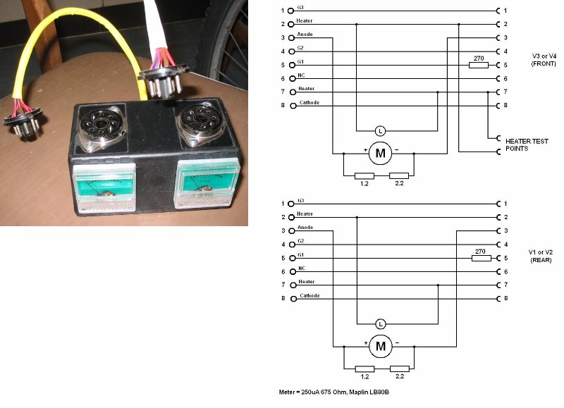

Hi 4a42, welcome to the Yaqin club, well my MC10L is nearly 3 years old now and so far no problems. I have attached a couple of photos of the jig I use for looking at the bias. The 270 Ohm resistors are most important as otherwise the extra wiring can make the output stage unstable. They are called grid stoppers and should be placed close to the valve base grid1 connection. You can calibrate the meters, both at the same time, using an external controlled Lab DC supply connected through both circuits. I adjusted the shunts slightly so that 35mA hits the same place on the meter scales. Of course you could use a battery operated panel meter switched across two precision resistors but the Maplin meters are cheap.
I added the two 2mm sockets later for checking the heater voltage just to make sure the mains transformer was being run with the right input. On my Yaqin I had thought it was a 220V model and I ran it from an auto transformer. However the test points showed only 5.5V so I ran the amp straight off the 230V mains and the heaters are now correct. It does pay however just to check you have a 230V model and not the 220V one.
The Octal plugs I made from some old valves after carefully removing the glass envelope. If you do this, make sure that there is a pin in all 8 positions, sometimes valves have a missing pin.
I find this little gadget most useful repairing guitar amps and the last Marshal Amp that came my way had valve currents all over the place. However, by noting the currents drawn by each, I was able to mix 'n' match the 4 valves so that the currents through the output transformer were equal. The guitarists reckons the amp sounds better than it ever did and it is still going strong after many hours of hard gigging.
