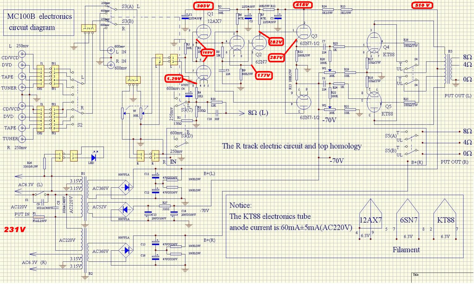

Look at the schematic.
We have a 3rd Cap not directly involved in the signalpath (C5) also 0,22uF.
Should this also be lower value? What is it for?

That calculator is misleading. The relevant resistance is not the load, but load plus source. In many cases this does not matter very much as the load is much bigger than the source, but in valve circuits it often does matter.Max Martin said:Maybe this is some help?
C5 is very much involved in the signal path. It provides the AC ground for the other input to the LTP phase splitter. Together with the 1M resistor it forms a high pass filter, so it has a similar effect to a coupling capacitor. As general guidance, you should ensure that the LF rolloff defined here is quite different from that defined by other coupling caps so you don't get excessive phase shift all together - the designer has done this, so don't mess up his design in this respect.We have a 3rd Cap not directly involved in the signalpath (C5) also 0,22uF.
Another piece of general guidance: to successfully modify a circuit you need to understand it better than the original designer.

To get an earlier rolloff I would reduce C6 and C7. This is quite late in the circuit. Better, add the coupling caps the designer should have put around the volume control, especially between the slider and the first valve grid.
Changing cathode bypass caps moves a shelf, not a rolloff. Over a limited frequency range it can change phase more than amplitude so it can be a useful way of tuning for LF loop stability. You need to know about Bode plots, or how to carefully interpret the results of a simulation.
1uF/1M will give rolloff at about 0.15Hz, not 6-9Hz.

Sorry, i can't understand what you mean with "slider"? Volume?
I have removed the volumepot. Signal goes straight into the 12ax7. I use this as a poweramp only. You mean a coupling cap here? What value you can recommend?

Silly me! I foolishly assumed that the circuit you have put up is the circuit you have, so I didn't bother to re-read the entire thread to check for changes you have made.
At the input to a circuit there should almost always be a coupling capacitor, to isolate the circuit from whatever comes before. This is also usually the best place to set the LF rolloff, as signal levels are low so capacitor distortion will not be a problem and unwanted signals don't get a chance to intermodulate through the circuit.

Yes, the slider means the volume control. You have a 39k grid load resistor at the input of the 12AX7, so you can connect a good quality 0.027uF capacitor between the input jack to the grid to create a 150Hz high pass filter. Leave the other coupling capacitors as they are.
It's 510K. Schematic is wrong. What does it change regarding cap size?

For 510K, then try 2nF (0.002uF), the formula is C=1/6.28*R*F, R is the resistance, and F is the corner frequency.
You can't expect us to keep track ourselves of all the changes you have made. Better for you to learn how to calculate coupling cap values. It isn't difficult.
The feedback is in operation whichever output tap you use. For 8R it comes directly from the output. For 4R it uses the OPT secondary as an audio autotransformer.

So if I understand correct, yaqin have taken a shortcut and only placed feedback over 8R just because most people have 8 ohm speakers or?
If i look inside my Yaqin there is only one red wire going from feedback (12K and 50pF) direct to speakconnector 8 ohm, nothing to 4ohm?
Edit: ok for best performance it should be feedback wire connected to 4R if i use 4 ohm speakers?
Yes, yaqin have taken a shortcut - but a reasonable shortcut. If the OPT is good quality then there is little harm done.
To transfer the feedback connection to the 4R output would need a change in feedback components: resistor smaller, capacitor bigger (8k2 and 68pF, perhaps?).
