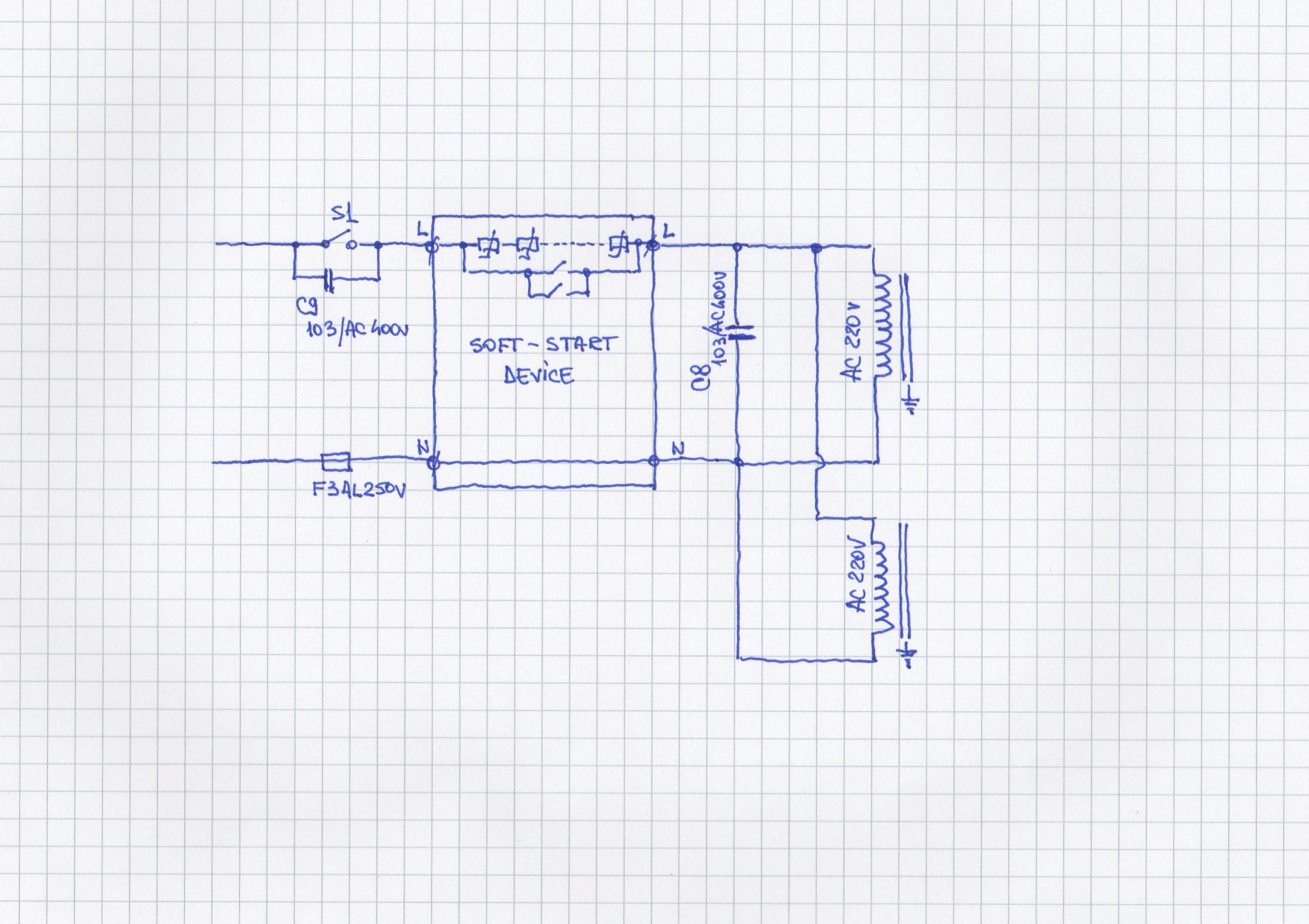

This is how I linked the soft-start device, between the main switch and the primary windings of the transformers network.
The voltage transformers grows slowly, from 30V almost to nominal value, in tens of seconds, thermistors are then short-circuit the relay contacts. Time after which the short-circuiting occurs can be adjusted with the trimmer potentiometer. The amplifier is very slow start.
