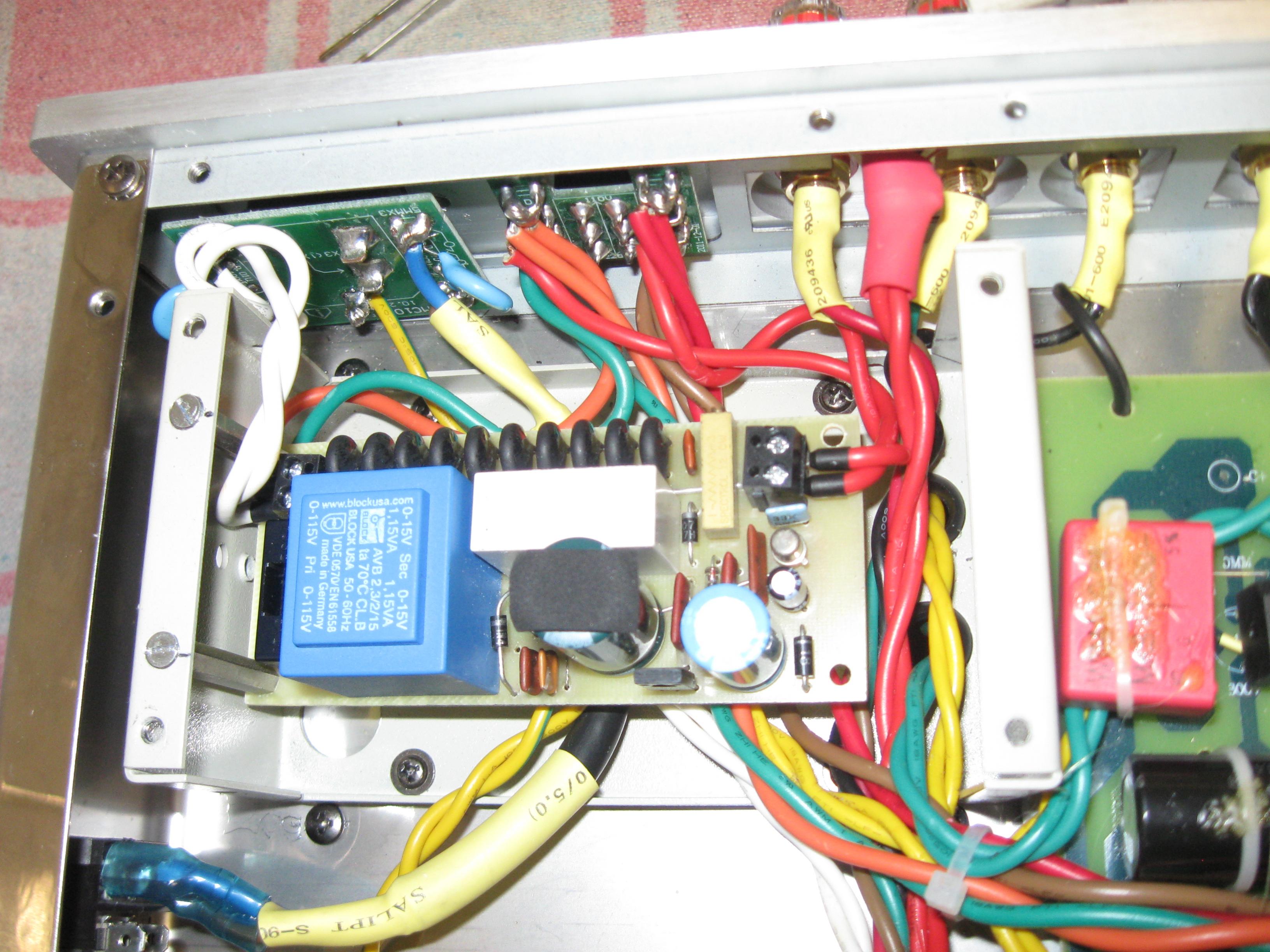

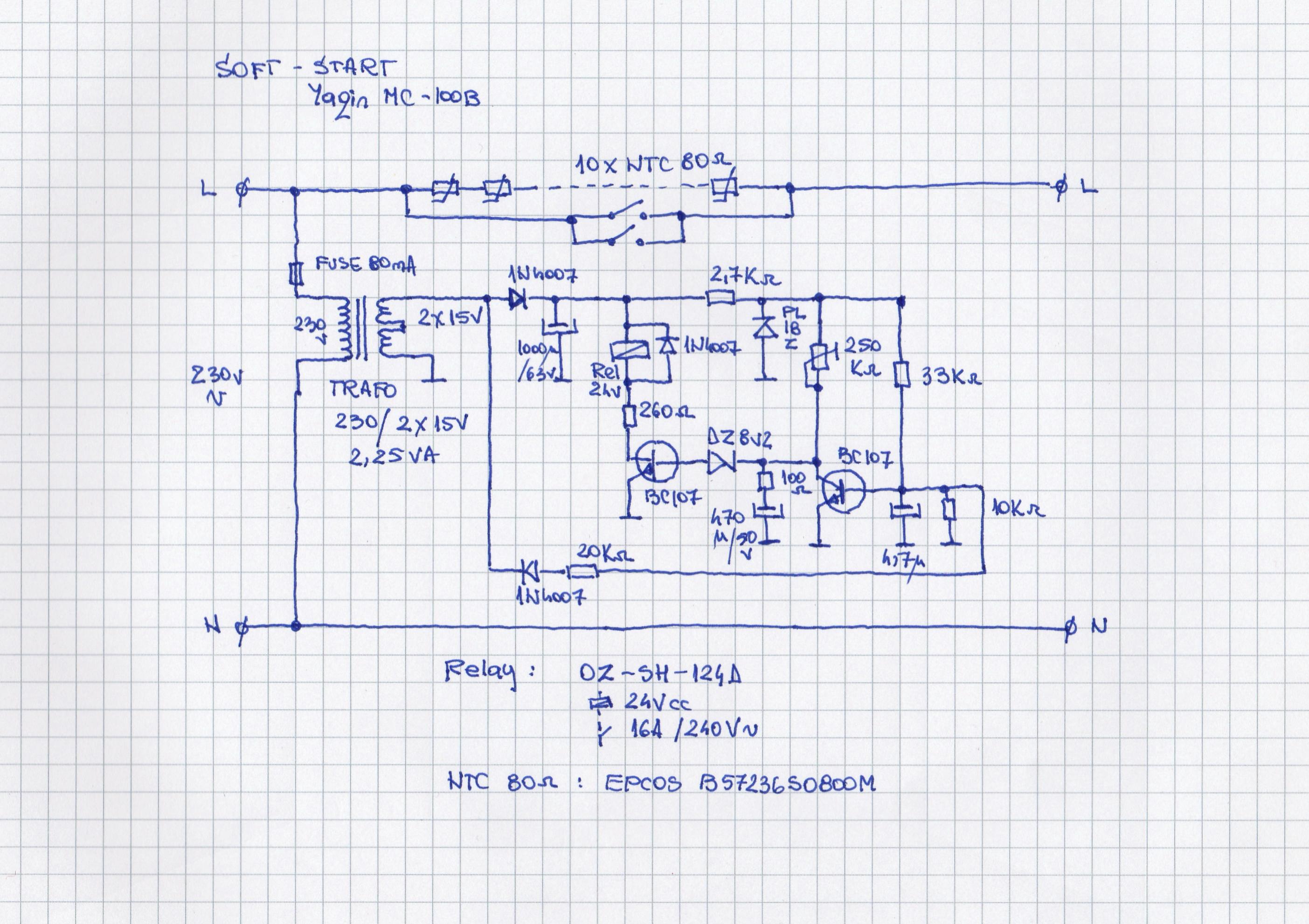

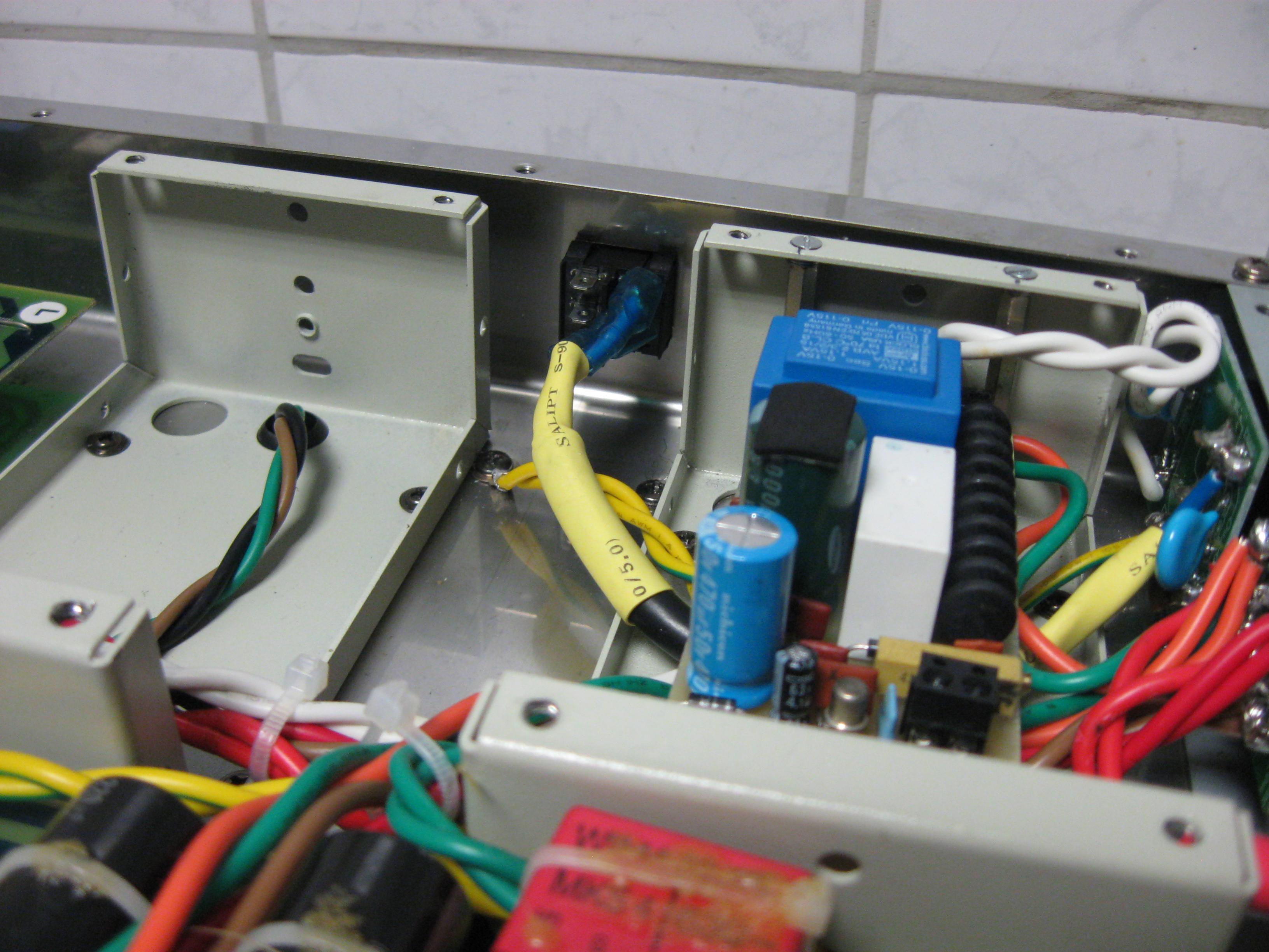

I made a soft-start circuit that works well for several months, attach wiring diagram and the way in which I placed in my Yaqin amplifier.
Sorry, the relay driver transistor is BD139 ,I misspelled.
